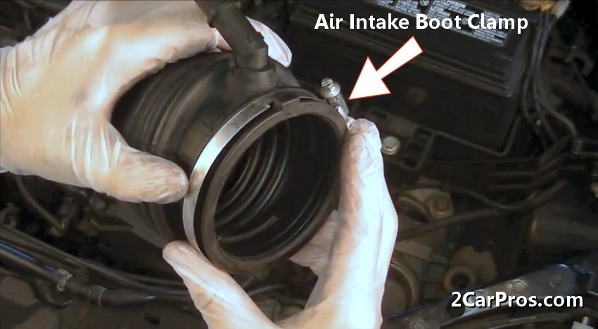

Using a screwdriver or a small socket and ratchet, loosen the clamps that secure the boot or tube to the air cleaner housing and the throttle body by turning the clamp screws counterclockwise. There may be an mass air flow sensor involved depending on the design of the engine, if so unplug the sensor
removing air intake clamp

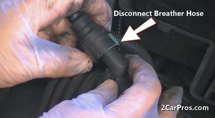

Engine breather tubes maybe connected to the boot/tube which is used to ventilate the engine crankcase gases into the intake system to be re-consumed by the engine combustion process. These tubes are held in place by a plastic clip. Use a small screwdriver or pick to lift upward the fastener which will enable you to remove this connection.
removing breather hose

Once the mounting clamps and breather hoses are removed and loosened completely remove the boot or tube. Inspect the area between the ribs by flexing it and looking for signs of rips or tears. Keep track of all clamps, nuts and bolts in a container so they don't get misplaced.
