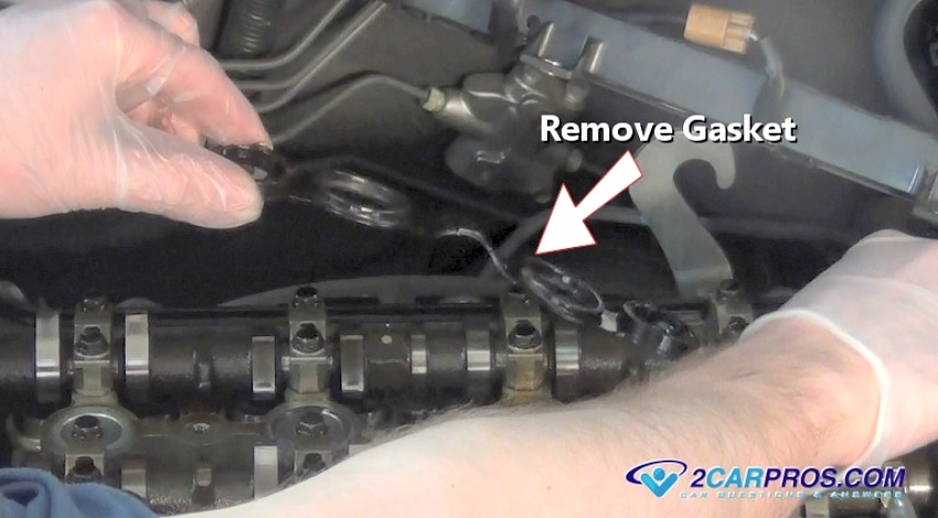

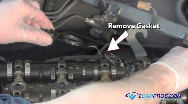

The cover gasket will either be stuck on the cylinder head, or the valve cover itself, remove the old gasket.
remove valve cover gasket
