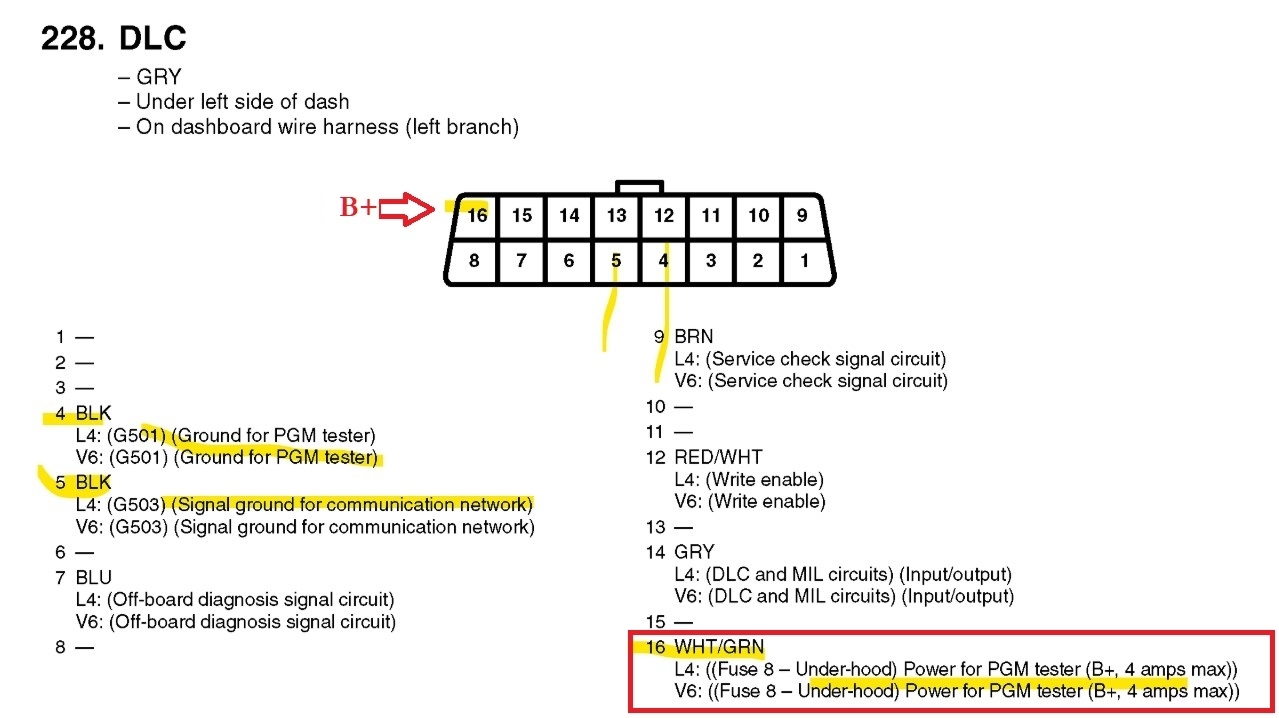

Also when I checked the 7 and 14 on the data plug or whatever it's called, the 7 read 10.86, the 14 read less than 5 when I used the 4or the 5 as ground there was no change.

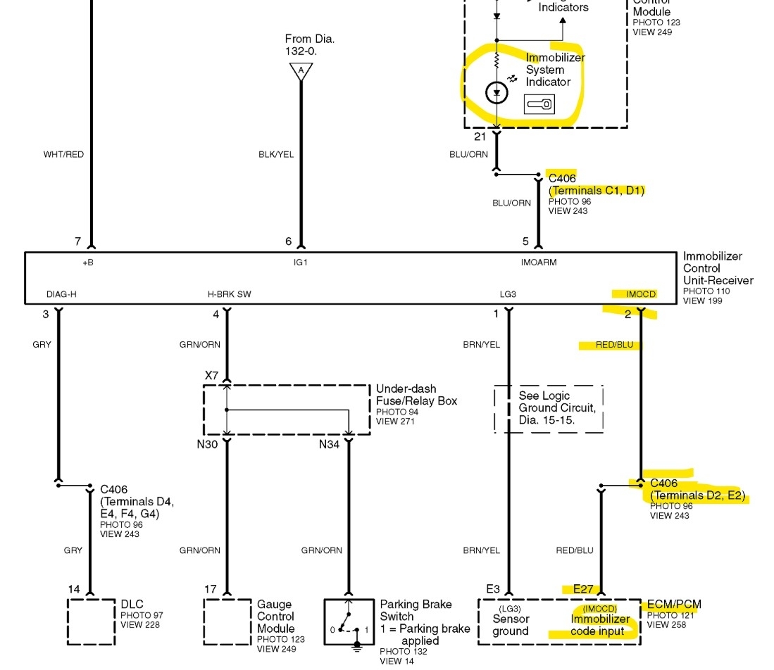

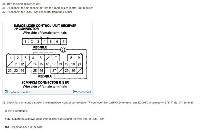

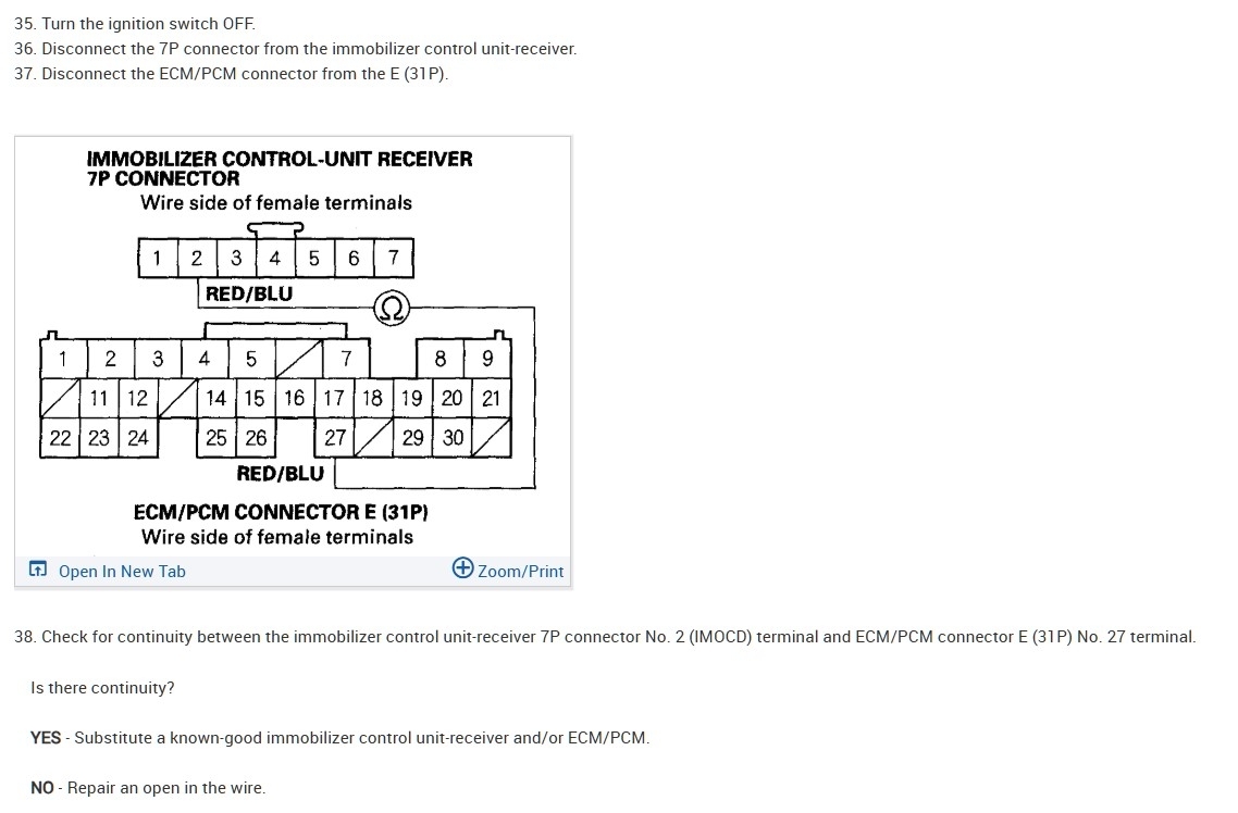

When I disconnected the ECM and immobilizer and checked for continuity there was none. My understanding is correct that means the ECM and the immobilizer at the ignition need to be replaced. I understand that they need to be replaced together so that they're paired around to pay someone extra to pair them together. I also going to have to replace the keys and do I need keys that have never been programmed before this is my last and final question thank you so much for your help I will be sure to donate to your GoFundMe and recommend you to everyone I know that has vehicle problems and needs assistance.
Wednesday, June 11th, 2025 AT 9:19 AM
AL514
  • 5,596 POSTS

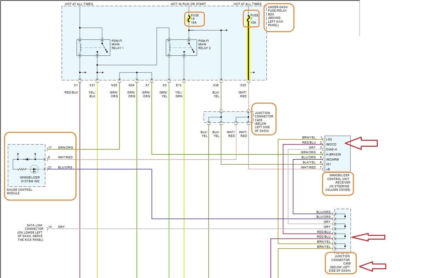

Before you go replacing anything yet. When you unplugged the Immobilizer and ECM, then checked for continuity from the Immobilizer connector pin 2 and the ECM connector E pin 27, it's a red/blue wire you had no continuity? If you read OL on your meter when checking the resistance between these two pins, then there is an open circuit between the Immobilizer and ECM. You don't need to replace modules for an open wire. Replacing modules is the last thing you want to do, always verify your test results first, what if you go replace those modules, reprogram everything, along with new keys and the same issues still exists. This is the test where you need to have a resistance reading (continuity). Technically less than 5 ohms. If this circuit is open, more than likely there are other wires damaged as well.
Wednesday, June 11th, 2025 AT 12:38 PM
JPEEZY2980
  • 38 POSTS
Okay, so yes it read ol so that means there is a short somewhere we need to find?
Wednesday, June 11th, 2025 AT 12:41 PM
AL514
  • 5,596 POSTS
No there is an open circuit, a broken wire. You're checking on the red wire with a blue stripe, correct?

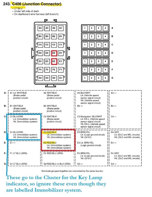

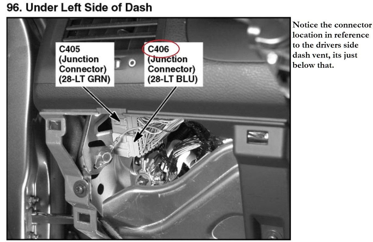

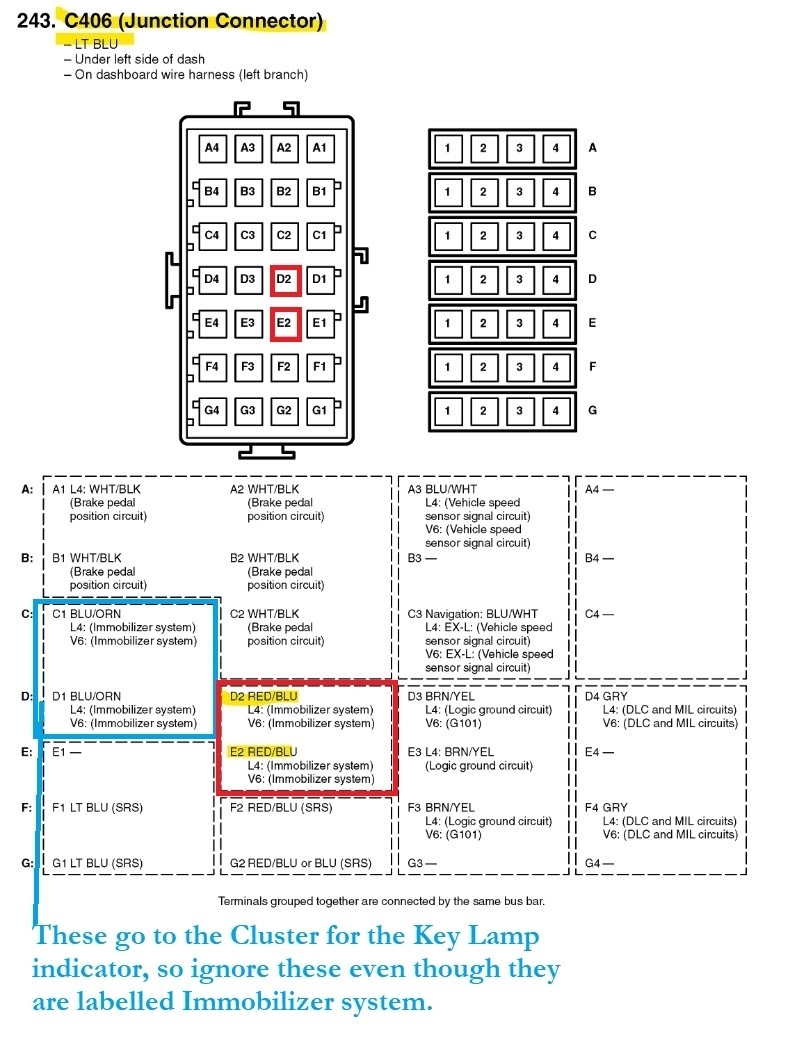

So in between the Immobilizer and ECM is this junction connector C406, that's where you need to go next, check continuity from the Immobilizer connector pin 2 to C406, it's still going to be the same color wire going in and coming out of the connector. Check both. Let me see if there's any procedure for removing the knee panel there below that vent, in some cases there is an air bag located there.
Wednesday, June 11th, 2025 AT 1:05 PM
AL514
  • 5,596 POSTS
If the battery has been disconnected for a while already then, you're okay, I don't see any airbag in that location, but disconnecting the battery and letting the system discharge only takes about 3-5 minutes. But C406 looks to just be a junction bus bar type connector, where it simply connects the two wires when the two connectors are plugged in. If you have any water leaks it looks to be a location where water intrusion might be an issue, but you'll have to check it. You should have continuity from one red/blue wire D2 to the other E2. And also check for continuity from the Immobilizer connector to C406 as well. We're basically tracing the circuit back to locate the open.

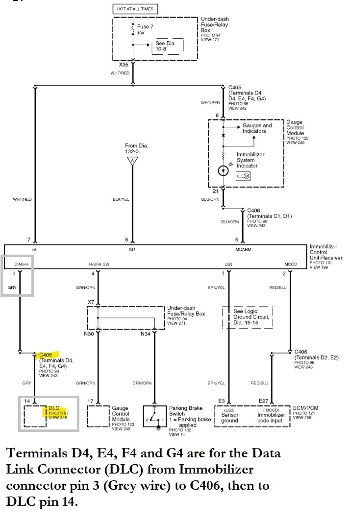

I just realized the Data Link connector "DIAG" wire runs through C406 as well, I'm wondering if that's why there are issues with the scan tool as well.

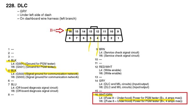

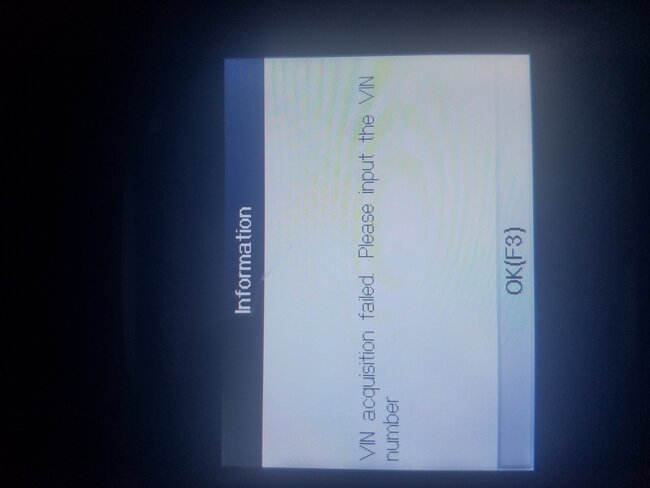

The 10.86volts on pin 7 might be correct, it could be an 11volt signal, or the multimeter is not fast enough to read the signal so it's just giving an average of voltage its reading, since pin 7 looks to be the K-Line which would be scan tool communications.
You weren't able to manually put the VIN in either?
Wednesday, June 11th, 2025 AT 1:40 PM
JPEEZY2980
  • 38 POSTS
But when I manually input the van, it told me what kind of vehicle it was, but it still wouldn't scan or give me any kind of other information unless there was something else, I could have done that I didn't do.

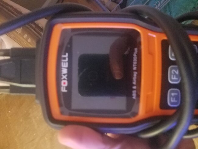

  • 5,596 POSTS
What scan tool are you using? It should have read the VIN pretty quick and give you access to scan at least the ECM if it's a basic OBD2 scan tool.
Wednesday, June 11th, 2025 AT 1:49 PM
JPEEZY2980
  • 38 POSTS
Still would not connect to the car.

  • 5,596 POSTS
Did you check pin 16 of the data link connector for power yet? It's the pin that powers up a scan tool.

  • 38 POSTS
I went back through I went back through and retested there is.5 ohms of continuity between the immobilizer and ecu and there is.3 ohms between the c406 and the immobilizer and between the D2 and E2 there is.3 ohms.
Thursday, June 19th, 2025 AT 5:20 PM
JPEEZY2980
  • 38 POSTS
I went back and retested the continuity because I wasn't sure if I had done it right. And apparently, I hadn't, so what now?
Thursday, June 19th, 2025 AT 5:22 PM
AL514
  • 5,596 POSTS
Okay, I had to go back and see where you are at by this point, so with the meter set on Ohms (resistance) setting, you have continuity between the ECM E27 connector/pin and the Immobilizer connector pin 2 red/blue wire? This would run through the C406 connector plugged in.
