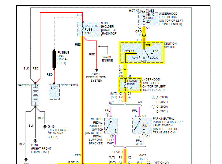

My truck does not even crank for starting and there is no noise at all when attempting to start the motor.
I have a cream colored wire coming from a wire harness between the battery and coolant reservoir. This wire gets apart from the harness at about the bottom of the battery, is about 15-inch long, and has a fuse about 3 inches before its loose end. Maybe the previous owner put this wire and I do not know if it has to be connected somewhere, end if it has to, I appreciate information being told to where it connects to.
Before tightening the battery contacts there was a click when attempting to start the motor, but no cranking, and now, as I said there is no noise at all.
The battery is one year old and the voltage is 12.9 volts.
Maybe I should check the battery and solenoid, too I only have an inexpensive multi-meter and this s-10 motor is very cluttered at the bottom, but maybe I still can be told of something I can do. And about some inexpensive tools to buy, please.

Good evening,
I attached a wiring diagram of the starting system to see if we can narrow the area of failure for this issue.
Do you have a test light? If not, the voltmeter is fine for the checks.
Can you post a picture of this wire so I can see it?

Okay, got it.
Can you please post a picture of the wire for me to see and its location?
What checks have you done with the relay?

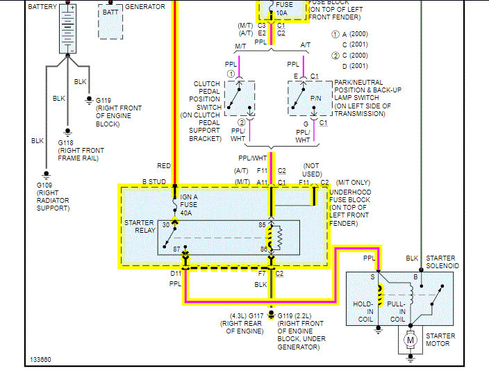

The starting system relay and its metal pins looked in good condition. I only did some relay checks with my multi-meter, and I guess I have bad news.
There is no continuity between the metal pins 85 and 86 of the relay.
With the ignition switch on the "on" position I did not get any voltage neither between terminals 85 and ground nor between terminal 86 and ground.
With the ignition switch on the "on" position I jumped terminals 87 and 30 with a piece of wire. Nothing notorious happened, (maybe a very very low noise sometimes. Then, with the jumping wire still in place I took out the ignition key and put again got the ignition switch in the "on" position. Again, nothing notorious happened, maybe just the very very weak noise sometimes.
If you have suggestions or advice on what to do next, I am open and willing to continue.

About 2 posts ago, you stated you needed to add 200 amps from a charger. That is what led me to this suggestion.
You never stated it was 12.7 volts at all. That is information I needed.
Going back to the starter relay, did you get power to the relay 86 with the key in the start position?
If you have no continuity between 86 and 85, the relay is no good and needs to be replaced.
