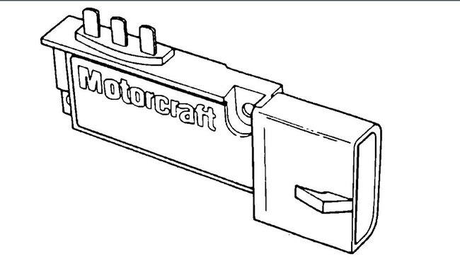

I had a Ranger the same year as yours and had that exact same problem I would take a surefire guess that its your control module located on the backside of your Distributor it takes a 5/16 deep thin walled socket good luck finding one only place I located one is snap-on but you could make your own out of a deep socket just grind it down till fit's I believe it cost around 60.00 dollars for the part and about 45 min. To fix you will also want to put dielectrode grease on the shiny surface that contacts the distributor hope this helps you out.

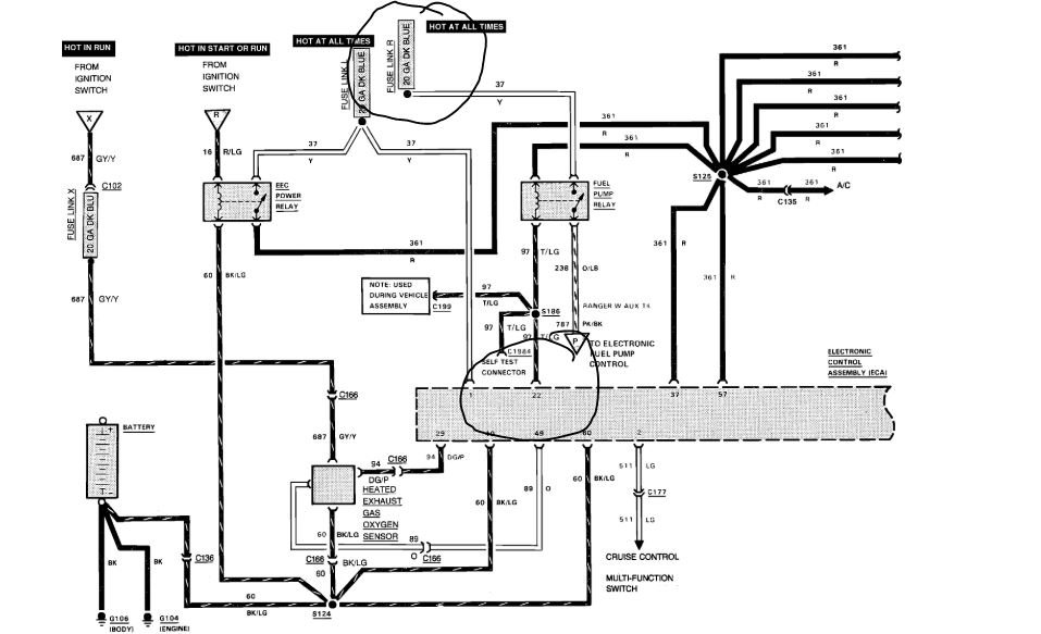

If you are sure everything you mentioned is good, then either we have a broken wire to the pump, a bad ground, or one of the two fusible links are bad. First, both the EEC and fuel pump relay get power via a 20ga fusible link. Each has its own.
Check the links for continuity. They will be blue in color. I attached a wiring schematic to help identify them.
Note: If there is an issue with the EEC, that should be shutting down both fuel and spark. Confirm you have spark.
