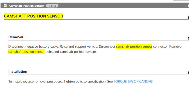

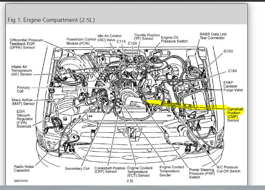

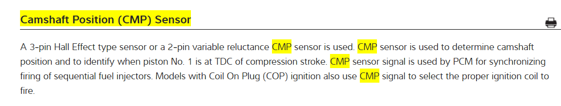

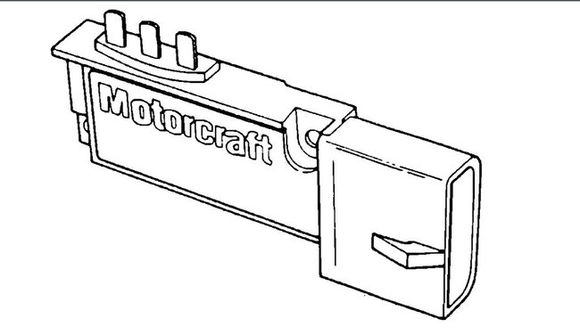

This sounds like a problem with your vehicle's Camshaft Position Senso r(CMP). The CMP is responsible for the firing of the fuel injectors and the spark plugs. I have included the description of what the CMP does and it's location as well as the instructions for the removal and installation of the CMP in the diagrams down below. Please go through these guides and get back to us with what you are able to find out.

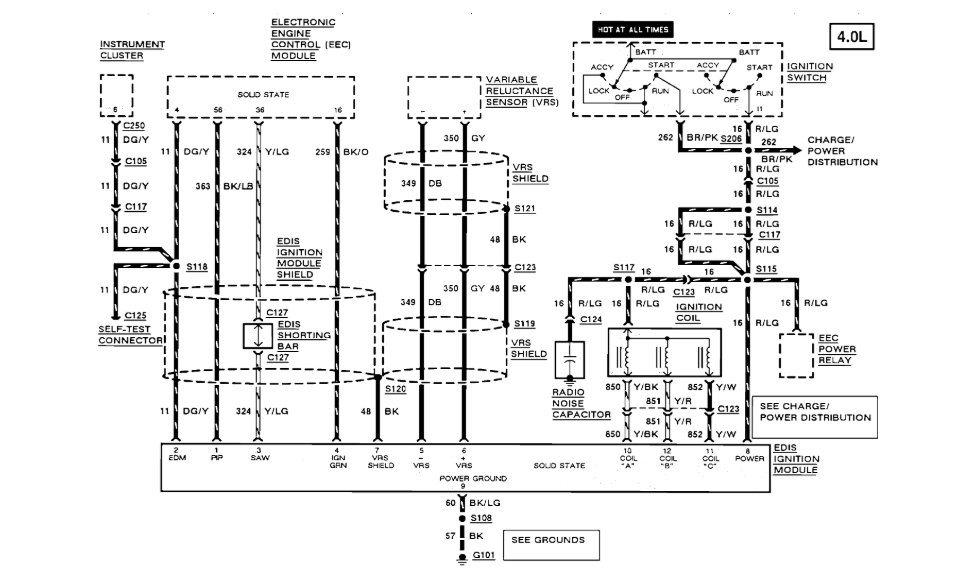

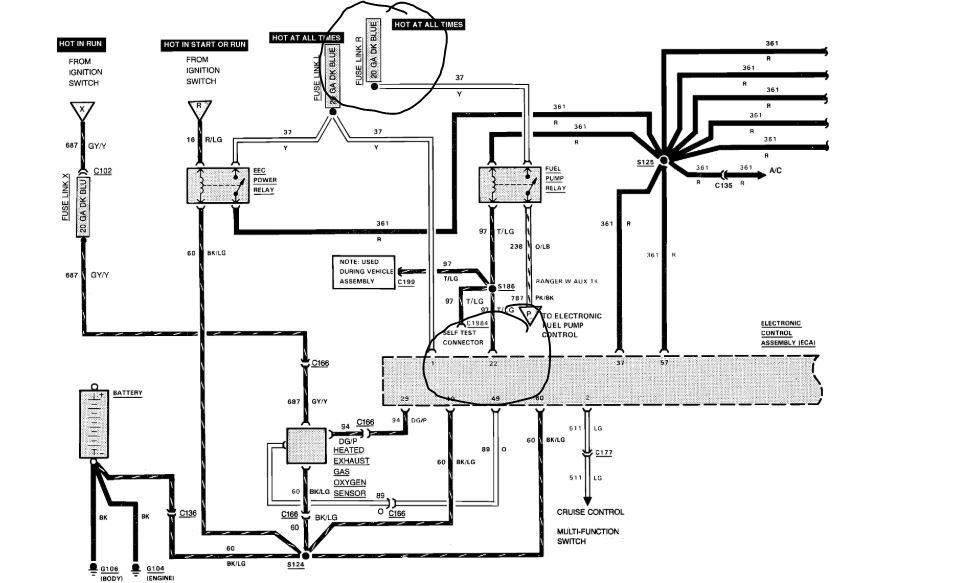

If you are sure everything you mentioned is good, then either we have a broken wire to the pump, a bad ground, or one of the two fusible links are bad. First, both the EEC and fuel pump relay get power via a 20ga fusible link. Each has its own.
Check the links for continuity. They will be blue in color. I attached a wiring schematic to help identify them.
Note: If there is an issue with the EEC, that should be shutting down both fuel and spark. Confirm you have spark.
