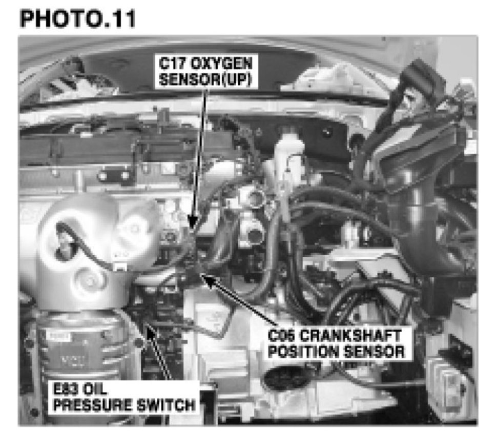

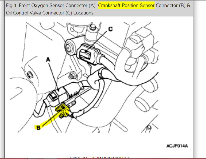

ELIEH
During recent two weeks, my car has been shutting off four times while driving especially when I decreased the speed. Like when I want to park or I stop to rear back. It started working again after many trials of starting. Also, it does not start after about 5-10 minutes after the car is turned off. Like when I go shopping and it takes 10 minutes and I come back to drive my car again. None of the dashboard warning lights is on. I changed the timing belt just recently. The battery seemed to have no problem and also I took my car for inspection and their computer did not show any codes.
Oct 26, 2020 at 11:05 AM (Merged)
  • CAR REPAIR CONTRIBUTOR
  • 110,190 POSTS
Welcome to 2CarPros.

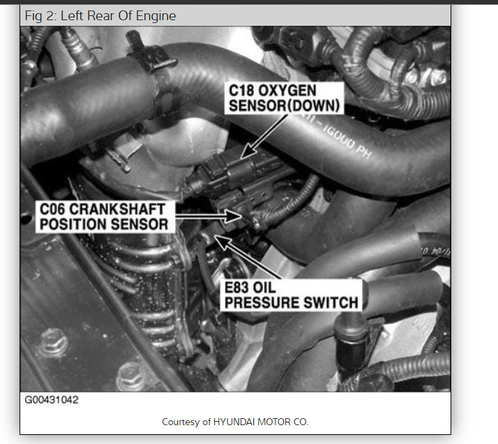

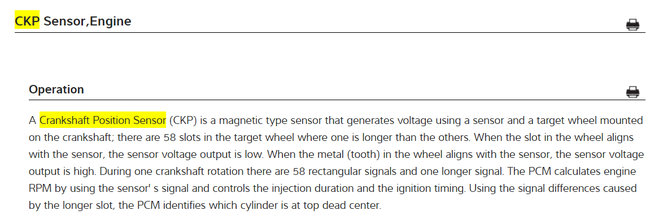

Based on the description, it sounds like you may have a crankshaft position sensor going bad. Often times, they will fail when the get hot or warm up. If the car sits for 10 minutes, there is no more air circulating and the sensor will get hotter. Under certain conditions, they will not set a diagnostic trouble code.
Do me a favor, take a look through these links. The first describes the sensor I am referring to, the second discusses symptoms, and the last shows in general how one is replaced.
https://www.2carpros.com/articles/how-a-crank-shaft-angle-sensor-works
If there is no code generated, then what needs done is this. Either a live data scanner needs connected to the system to check for an RPM signal when it won't start or you need to check to see if the ignition has lost spark.
Here is a link showing how to check for spark:
Here are a few links to help with checking for spark.
__________________________
If it is determine that the sensor is going bad, I attached a pic of the sensor's location to help.
Let me know if the symptoms above seem to mirror what you experience. Also, let me know if I can help.
ELIEH
Hello Joe,
Thank you very much for your comprehensive information. I did what you said and I changed the crankshaft position sensor last week. My car up to now has not had any shutting off problem. However, I've got very bad start since I changed it. At first I could start the car after two or three times of trials. But today it did not start at all. Based on my observations, the engine cranks but it cannot start . Do you think the crankshaft position sensor is the culprit?

MARKUS THE ACCENT OWNER
the engine shuts down with little or no warning. Until three days ago the 5 or so occurances where in hot weather and in stop and go traffic. the first time I had a problem with the car staying in a middle gear. It was stop and go traffic so I had an opportunity to stop put in park.. and try different combination.. although the shifter position was in different spot.. 1, 2, d .. the movement was laboured and indicated a middle gear of some sort.. higher speeds did not change things and I drove it of the highway. The nearest service center was closed and after a while I decided to drive to my destination. the car drove well after that. sometime later I had my regular service center check it and they didn't find any problem codes and besides some regualr maintenance .. (oil change and the common warranty issue regarding links) I was on my way. the next occurrence resulted in me towing it from a busy highway to Hyundia service. Tthey advised it was a speed sensor. It was changed under warranty and tranny flush ( my cost) a day later I was rolling again. This summer I had it stop a couple times more. I was in a position to wait a bit and after an hour it started again. Just this past week, in high speed traffic it did it again. I waited it out and unfortunately it didn't start up. The battery drained and I needed to tow it again. The response from the service center is that the diagnostics didn't produce a probelm code. The technician thinks a bit of corrosion on a sensor on the block maybe the problem, but this unproven theory will cost me $500 as the part has not "failed". They boosted the battery and they say its ready to roll.. going to only charge me partially for the test.. considering the circumstances.. yes.. isn't that great? anyway.. long story short.. the engine seems to stop when it its stop and go / or going well in hot weather. Usually it recovers after a period of time. Any ideas? I"m not a mechanic.. just a frustrated hyundia owner hoping not to have to sell car in order to avoid continued hassle.
HMAC300
  • 48,601 POSTS

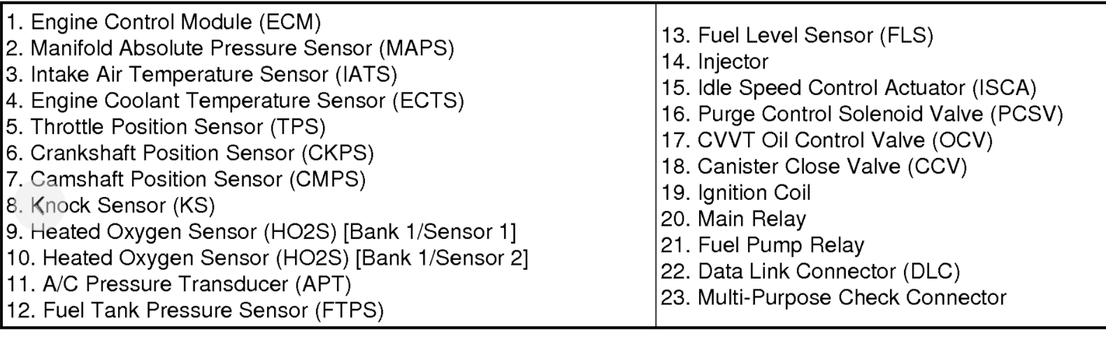

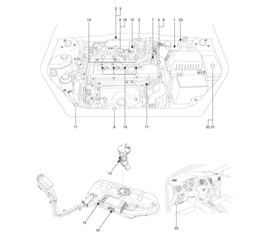

This sounds like a classic crankshaft angle sensor which when they fail will not leave a code but to be sure this guide will help us figure the problem out with diagrams below to show you where the sensor is located so you can check it out.
and
https://www.2carpros.com/articles/engine-stalls
Check out the diagrams (Below). Please let us know what you find. We are interested to see what it is.

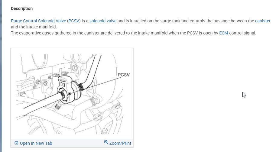

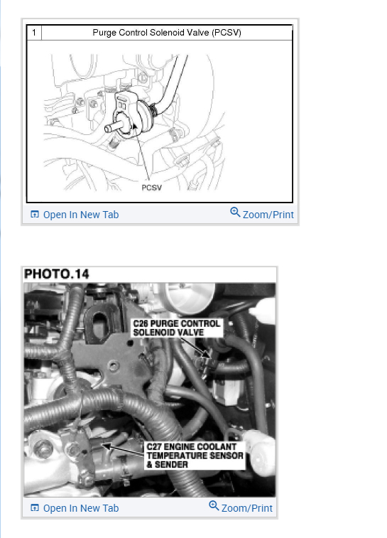

MADISONTHOMASA4
My car will barely go when I try to go and it’ll go 5 miles an hour when it says 20 and right after I get gas my car will shut off while I’m about to drive or it shakes really bad.

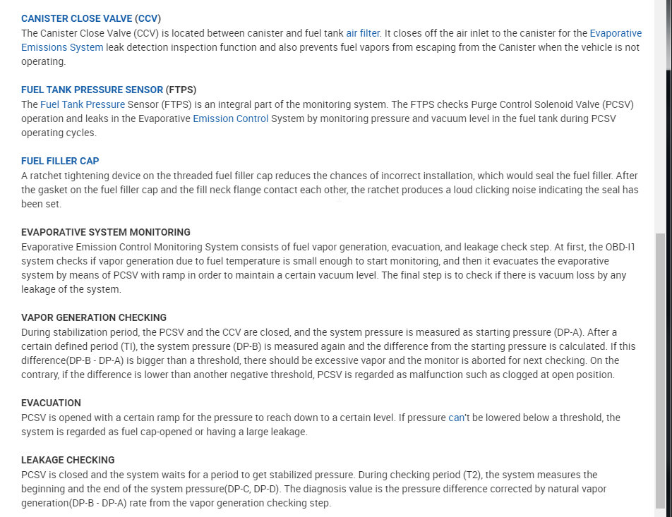

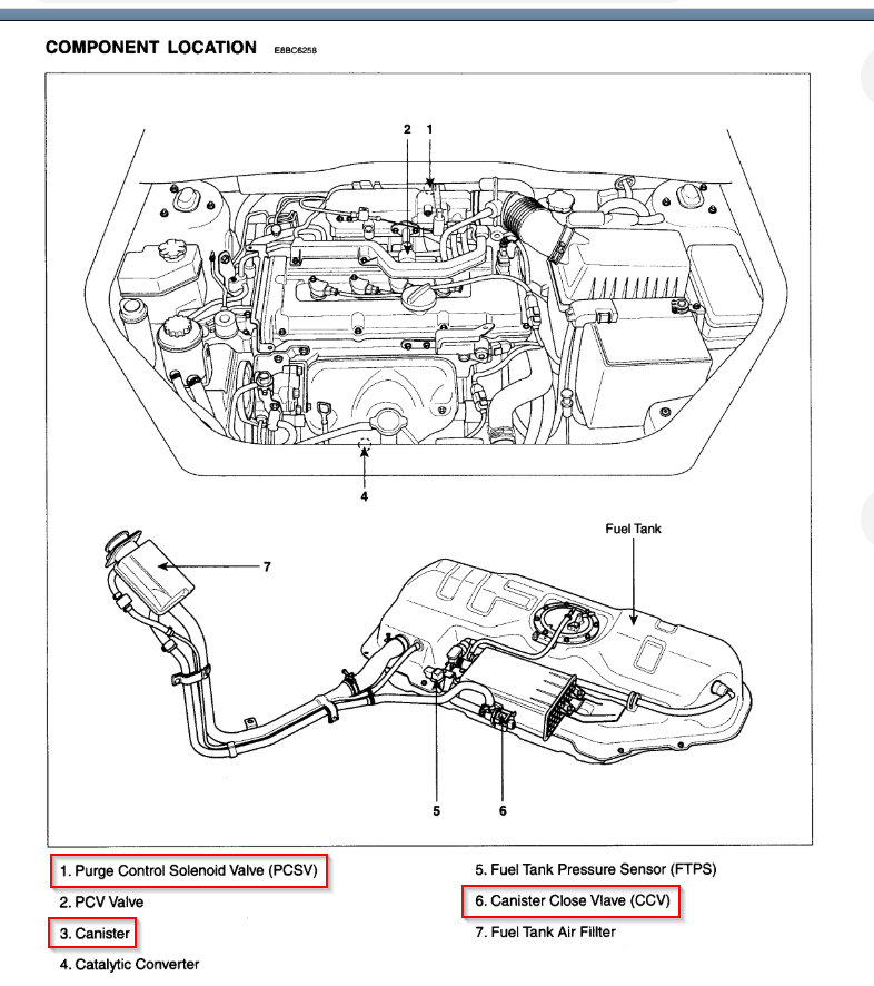

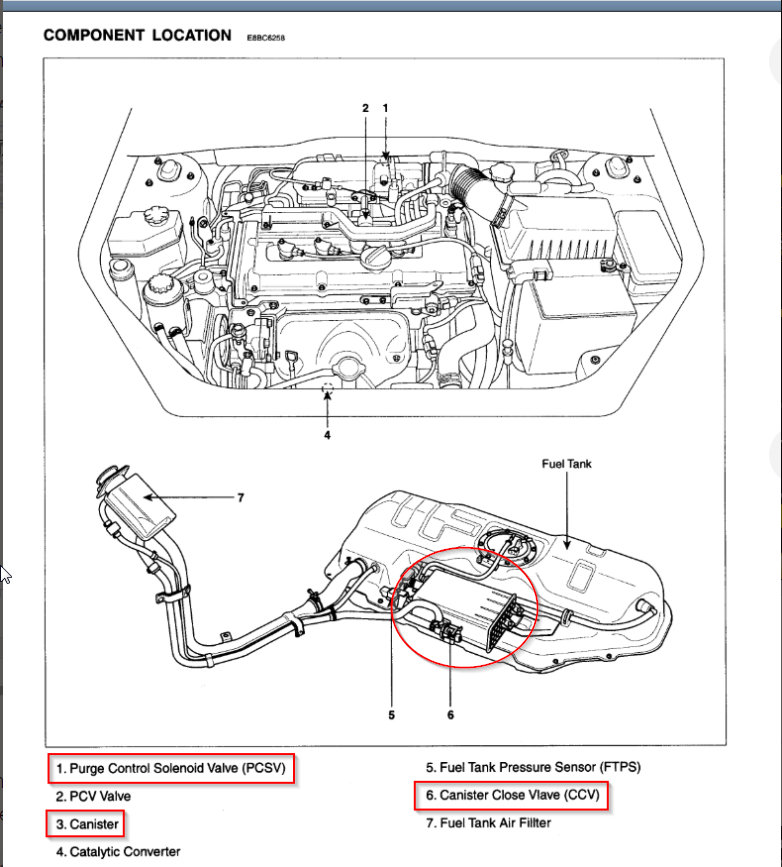

More then likely you have an issue with the purge solenoid being stuck open. This is a pretty common issue when this part fails.
Normally this happens when the fuel tank is topped off or filled when the engine is running. So if you put more fuel in the tank when the pump first shuts off then you are possibly putting fuel into the emission control system and causing this issue.
I would suggest replacing the charcoal canister and purge valve and see if this issue continues.

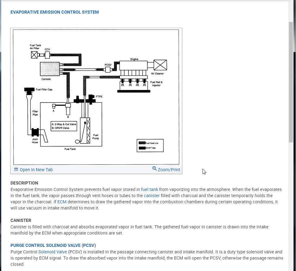

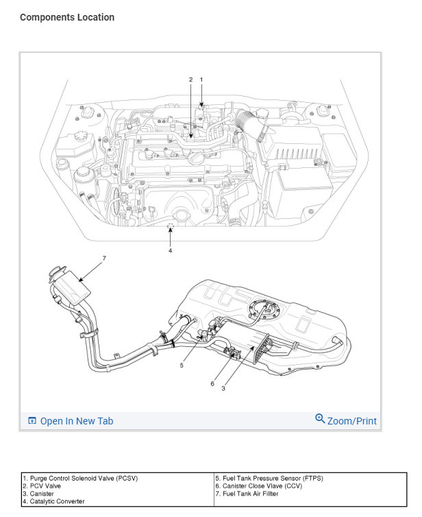

CLEFFEL
my car stalls and and runs a bit rough after refueling. After a few minutes it runs fine. I've changed purge valve and fuel pump. Still have the problem. Any ideas?
Oct 26, 2020 at 11:06 AM (Merged)

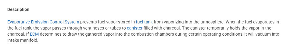

This is a common issue when the evaporative emissions system has raw fuel in it rather than vapor.
Basically this system is designed to take the vapor (hydrocarbons) from the top of the fuel inside the tank and route it to the engine to use as additional fuel rather then venting it to the atmosphere.
This system is only supposed to have vapor in it but when the charcoal canister gets raw fuel in it, it breaks down the charcoal and that damages the purge valve. This allows more vapor and fuel in to the engine then it can handle and the PCM cannot adjust for it so it runs rich. This means there is too much fuel in the system and it runs poor or doesn't start.
Let me know if you have questions and we can go from there. Thanks

CLEFFEL
Thank you, I did replace the purge valve. And also fuel pump. Is there any other reason there could be for this problem?
Yeah. It is the charcoal canister that I mentioned. More than likely that has raw fuel in it. If that is the case then every time the purge valve opens it is allowing too much vapor in.
When you fill the tank now it is forcing even more vapor in the canister and it can't hold anymore so it is pushed into the engine. I would suggest removing the canister (circled) and shaking it and seeing if you hear fuel in it. Then replace that and the CCV on the side of it.

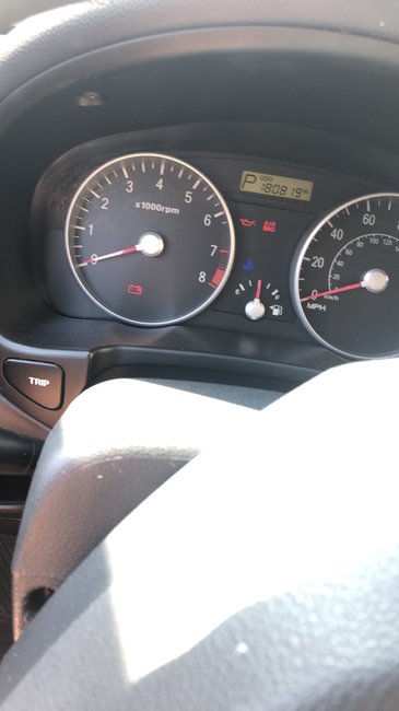

MOMMYMCT
I’ve had my car since March, I bought it from the second owner. Since I bought it it’s given me issues with stalling and flashing check engine, check fuel cap and the oil canister but only when stalling or shutting off. It does it while driving. I’ve done the machine readings many times giving me many causes all I’ve replaced (sensors, fuel filter, ignition switch and 4 coils, belts, spark plugs) I’m not sure what it can be anymore and now when shutting off the oil canister and battery light come on. Any ideas? I’m stumped
SCGRANTURISMO
  • 4,897 POSTS
Is your Malfunction Indicator Lamp (MIL) or "check engine" light illuminated? If it is can you please pull the Direct Trouble Code(s) for us. You will need a scan tool to do this, and if you are unfamiliar with how to do it, here is a link for you to go to:
Please go through the guide, if needed, and get back to us with what you are able to find out.
Thanks,
Alex
2CarPros
MOMMYMCT
The lights are not consistent, when the car stalls the lights come on but once the car is shut off and turned back on it does not show the lights until it stalls again. Which also means we are unable to get a code.

MOMMYMCT
No , the oil canister and the battery lights appear on the dash when the car stalls.

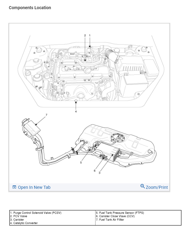

SCGRANTURISMO
  • 4,897 POSTS
Hello again,

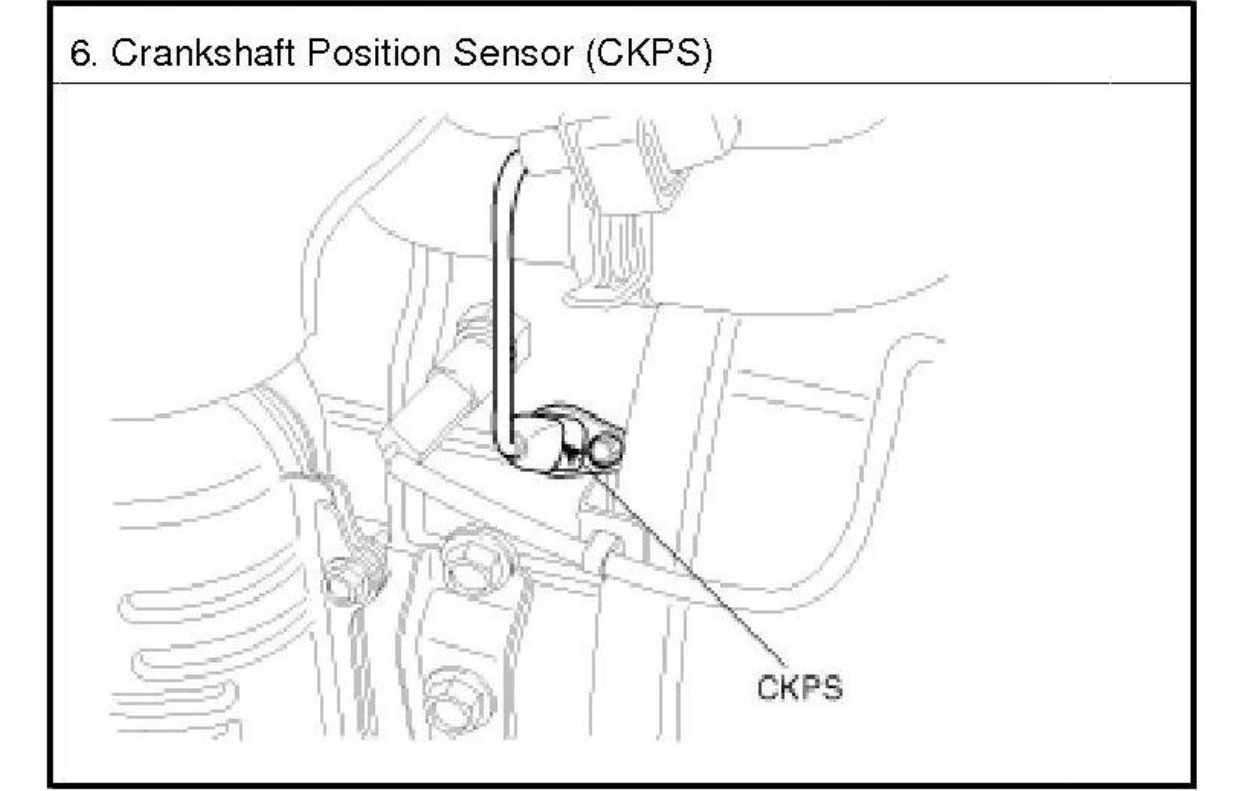

Okay, this could be a problem with your vehicle's Crankshaft Position Sensor (CKP) starting to fail. Your vehicle's Power-train Control Module (PCM) or "computer" uses this signal to determine where the engine is in it's 4 stroke cycle. It the turns on the fuel injectors and makes the spark plug spark accordingly. The sensor when starting to fail, will usually do it when it gets warm. Here are a couple of links below for you to go to:
In the diagrams down below I have included the description of operation as well as the location of the CKP for your vehicle. Here is a link for you to go to on the removal and installation of the CKP:
Please go through these guides and get back to us with what you are able to find out.
