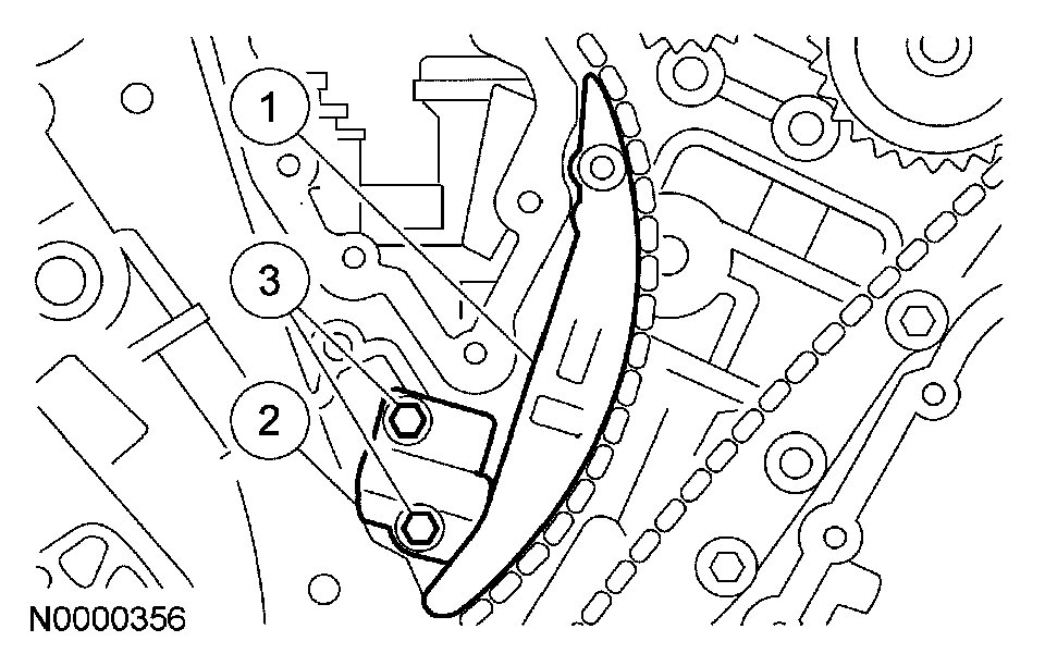

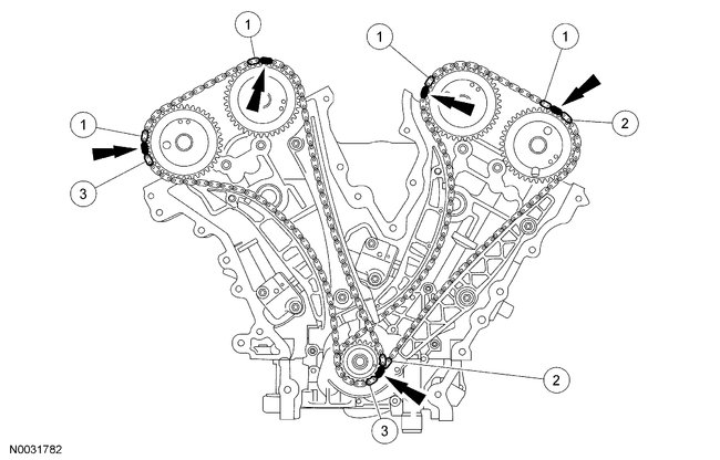

After replacing the head gaskets I put everything back as it was. Same cam caps, lifters and rollers all in the same place they came out of, with the exception of four new lifters. My problem is after I got everything back together (by the Haynes manual) it wouldn't start. I took the timing chain cover back off and checked as by the Haynes manual. I believe their diagram of the cams not accurate. Other diagrams show the cam marks in a different location. The Haynes manual puts the valves in a neutral position. The other diagram puts the cams on the right head pushing some valves in. So, heads on, cams in, chains off. How do I set the timing from here?

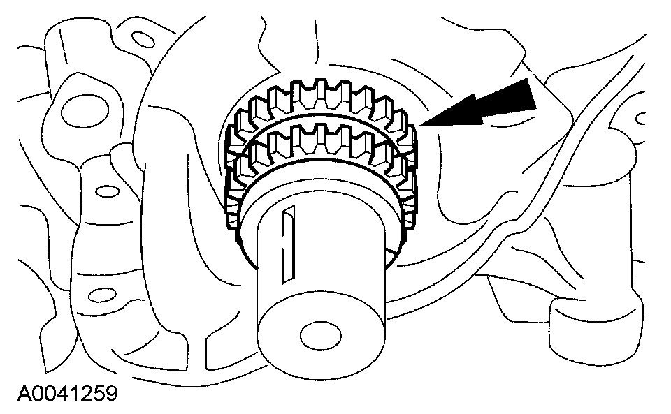

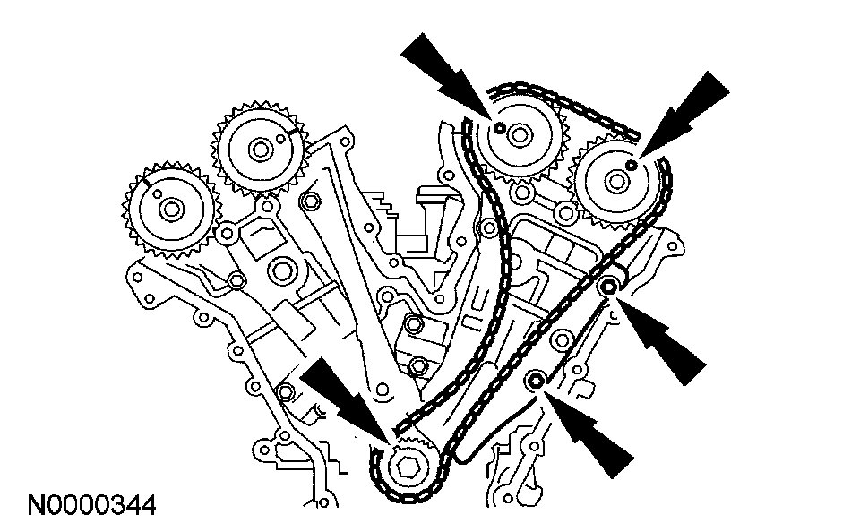

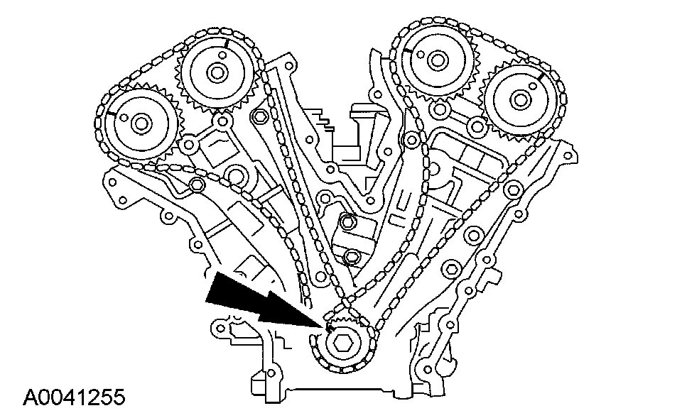

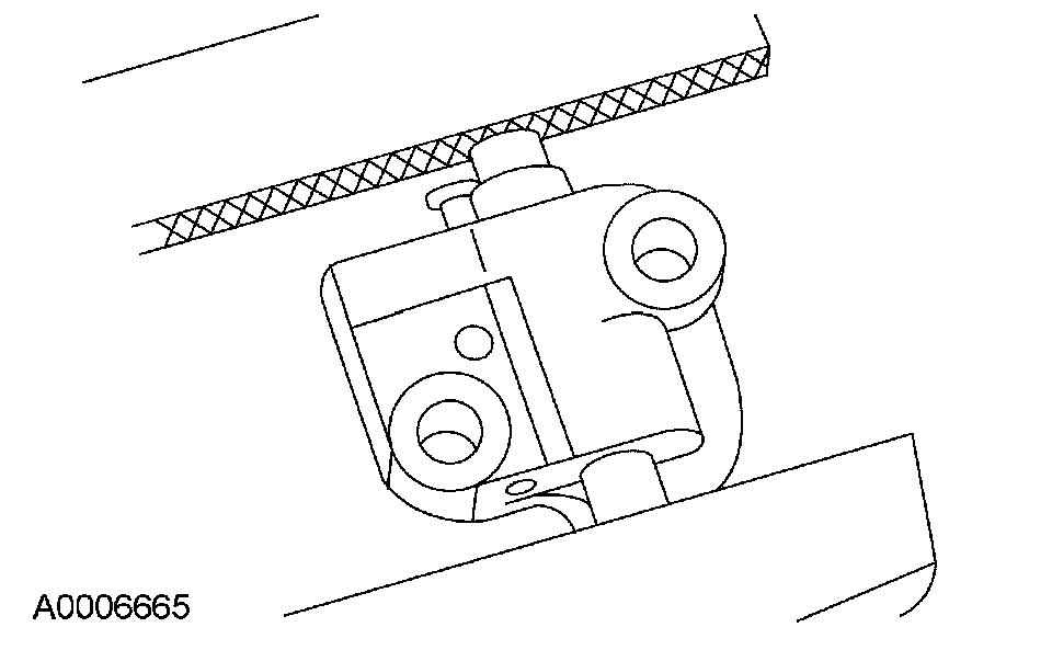

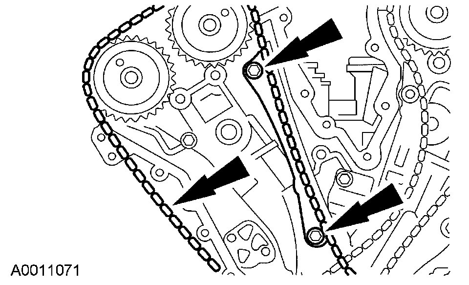

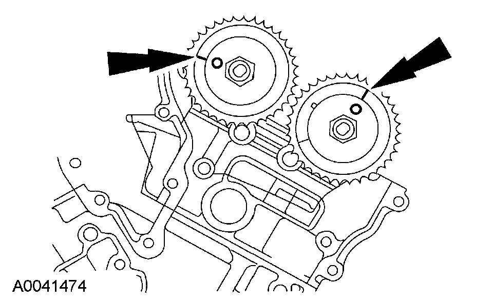

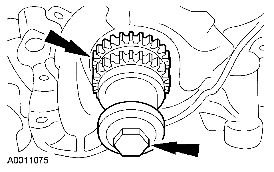

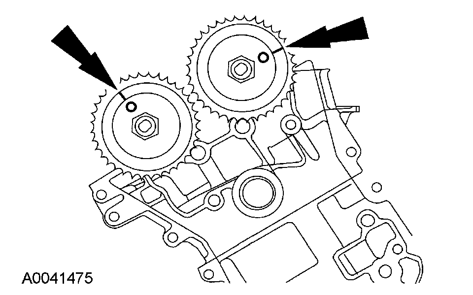

Here are the directions from Alldata for removal and replacement. The attached pictures correlate with these directions.
_________________________________________________
TIMING DRIVE COMPONENTS
Timing Drive Components
Removal
NOTICE: During engine repair procedures, cleanliness is extremely important. Any foreign material, including any material created while cleaning gasket surfaces that
enters the oil passages, coolant passages or the oil pan, can cause engine failure.

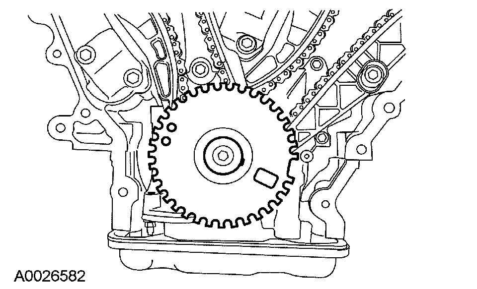

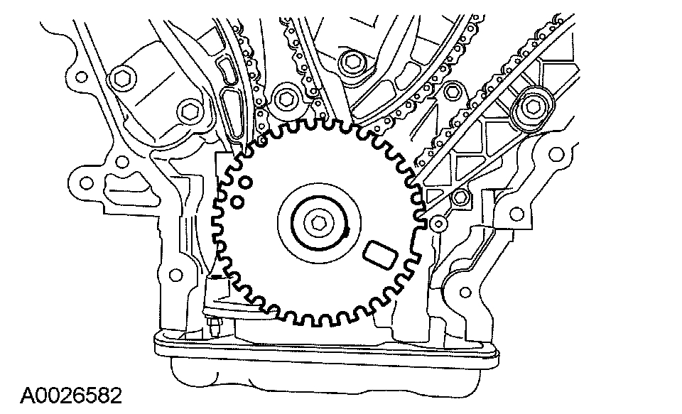

2. NOTICE: This pulse wheel is used in several different engines. Install the pulse wheel with the keyway in the slot stamped "25-25-34Y-30M"(color blue).
Pic 1
Remove the ignition pulse wheel.
Pic 2

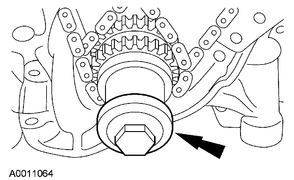

3. Install the damper bolt.

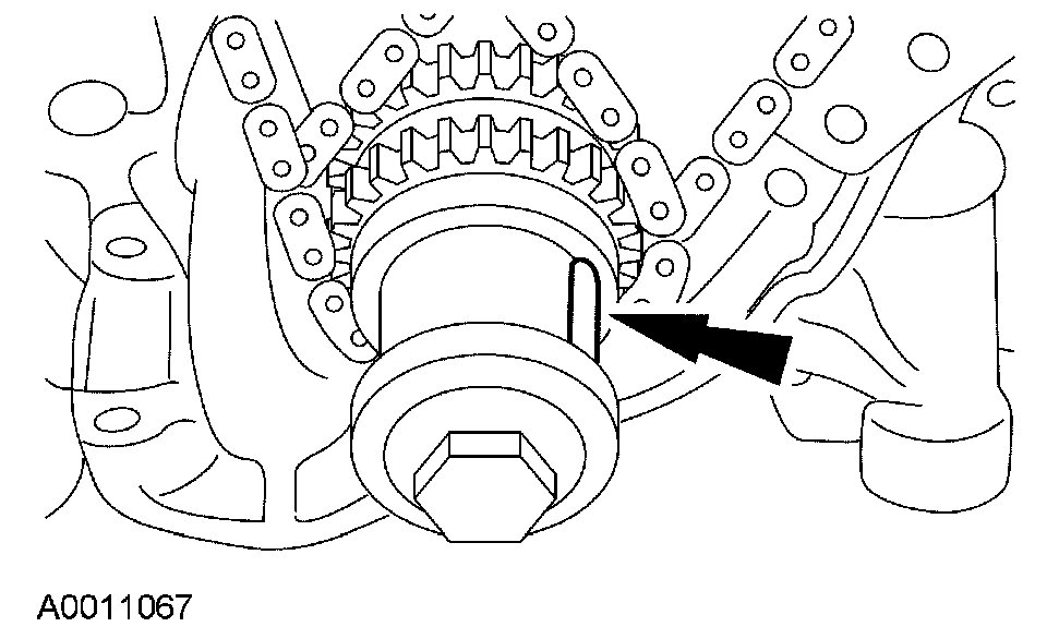

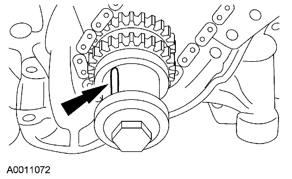

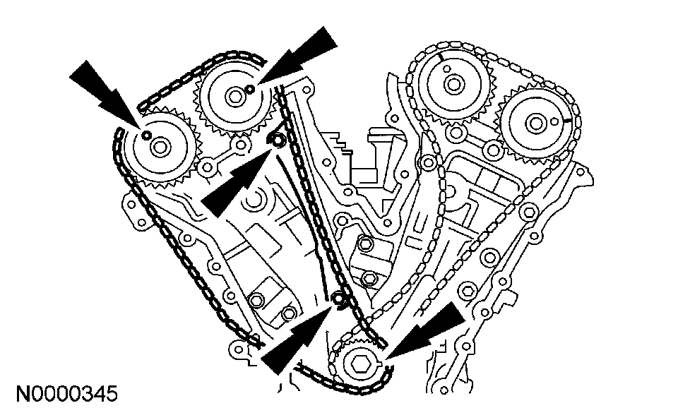

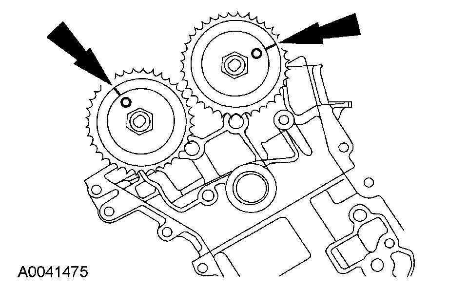

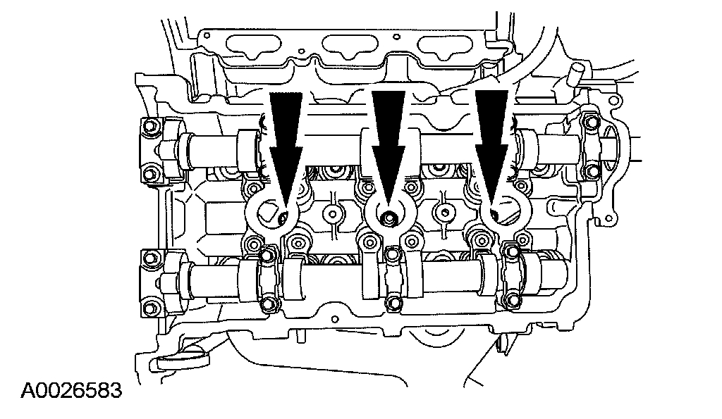

5. Rotate the crankshaft clockwise to position the crankshaft keyway in the 11 o'clock position and position the camshafts in the correct position. This will position the number one cylinder at top dead center (TDC).
- Verify that the camshafts are correctly located. If not, rotate the crankshaft one additional turn and recheck.
Pic 5

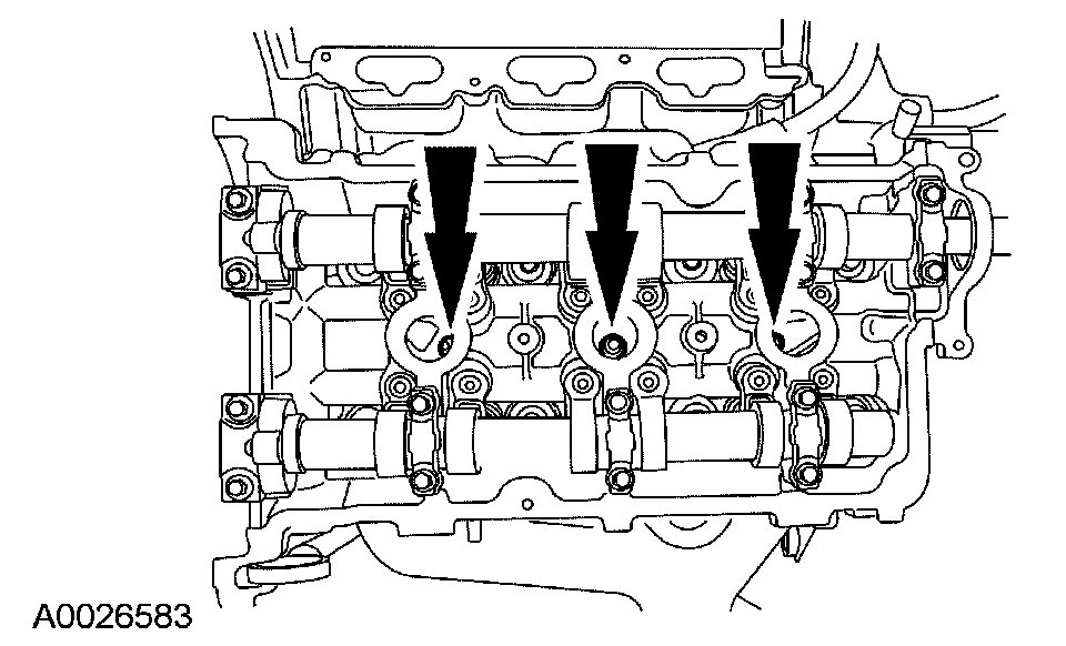

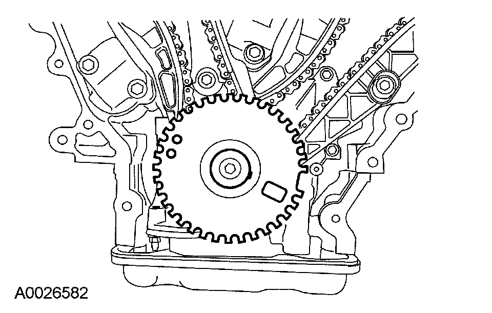

6. Rotate the crankshaft clockwise 120 degrees to the 3 o'clock position to locate the RH camshafts in the neutral position.
Pic 6
7. Verify that the RH camshafts are in the neutral position.

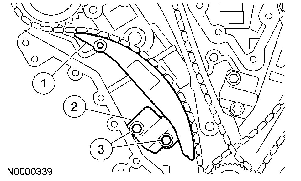

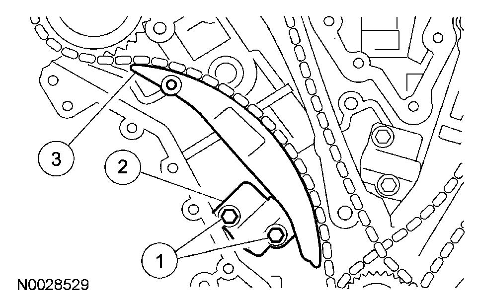

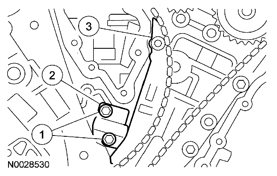

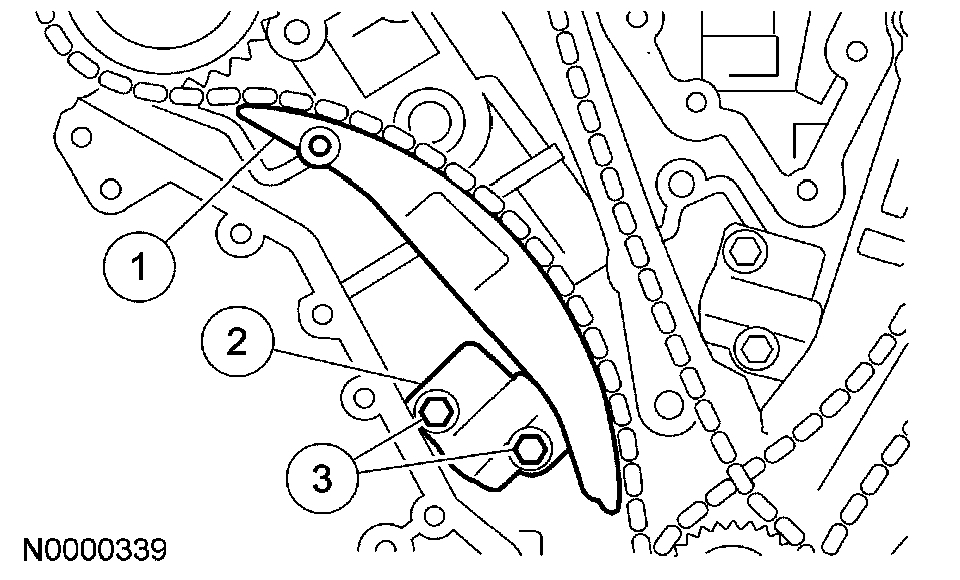

8. Remove the RH timing chain tensioner arm.
1. Remove the bolts.
2. Remove the tensioner.
3. Remove the tensioner arm.
Pic 8

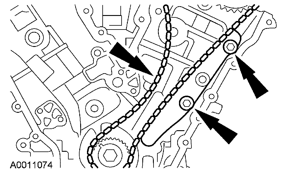

9. Remove the bolts, RH timing chain guide and the timing chain.
Pic 9

11. Verify the LH camshafts are in the neutral position.

12. Remove the LH timing chain and tensioner arm.
Pic 12

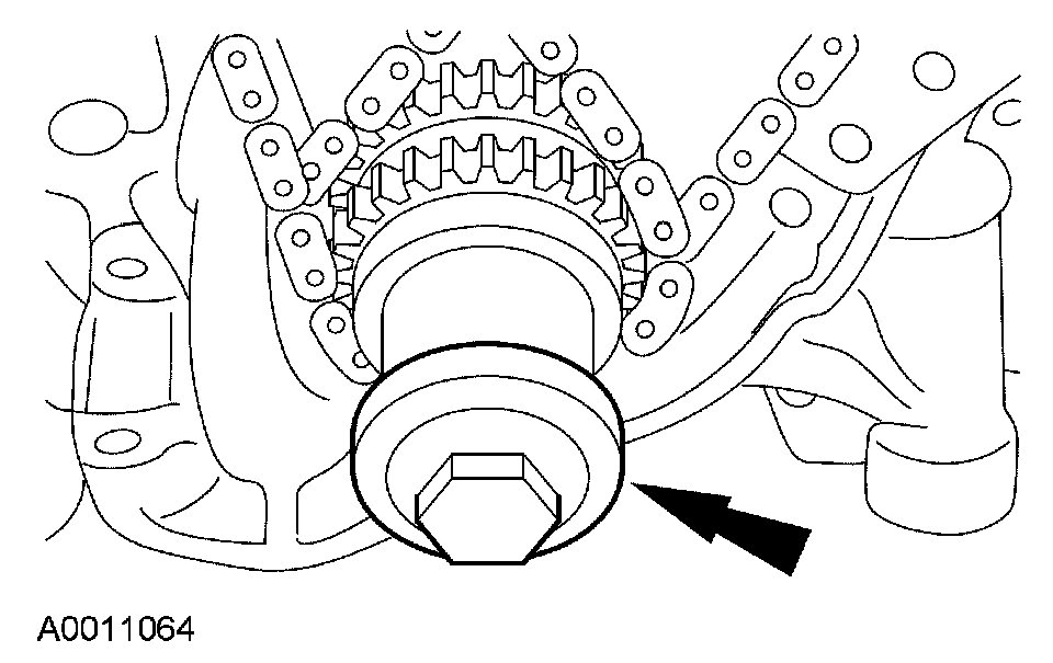

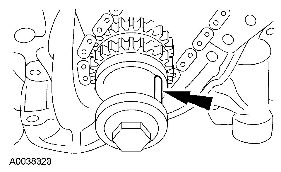

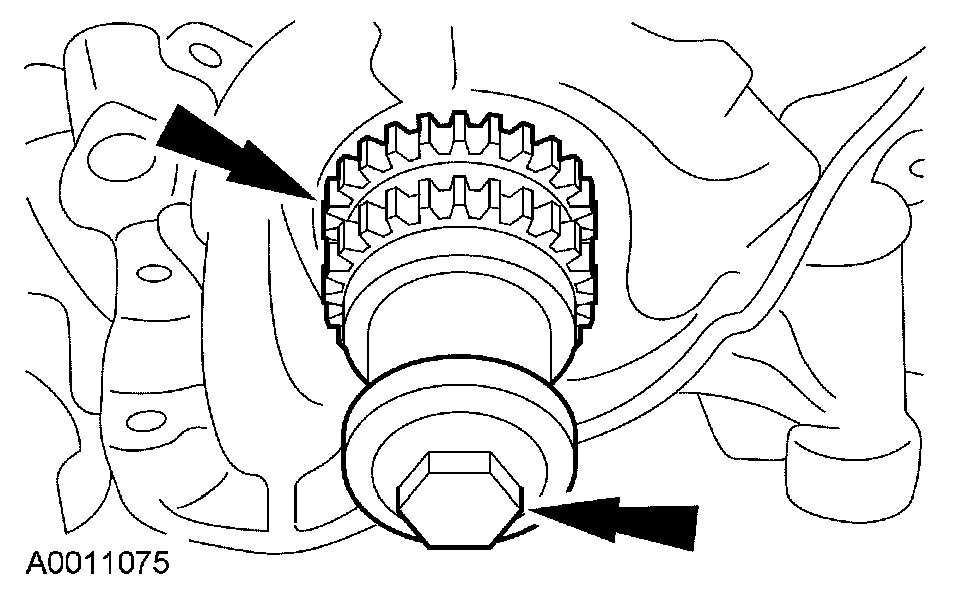

14. Remove the damper bolt and the crankshaft sprockets.
Installation
1. NOTICE: Failure to verify correct timing drive component alignment will result in severe engine damage.
Pic 14
Install the crankshaft sprocket with the timing mark facing out.

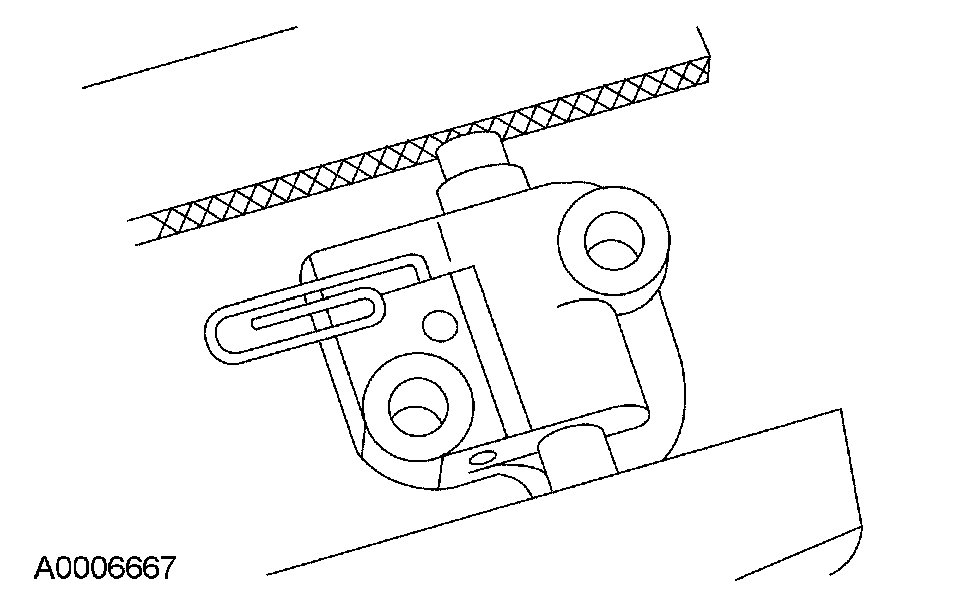

Position the chain tensioner in a soft-jawed vise.
3. NOTE: LH shown, RH similar.
Pic 16

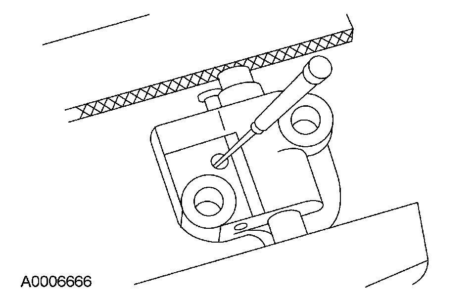

Hold the chain tensioner ratchet lock mechanism away from the ratchet stem with a small pick.
4. NOTICE: During tensioner compression, do not release the ratchet stem until the tensioner piston is fully bottomed in its bore or damage to the ratchet stem will result.
Pic 17
Slowly compress the timing chain tensioner.
5. Retain the tensioner piston with a 1.5 mm (0.05 in) wire or paper clip.

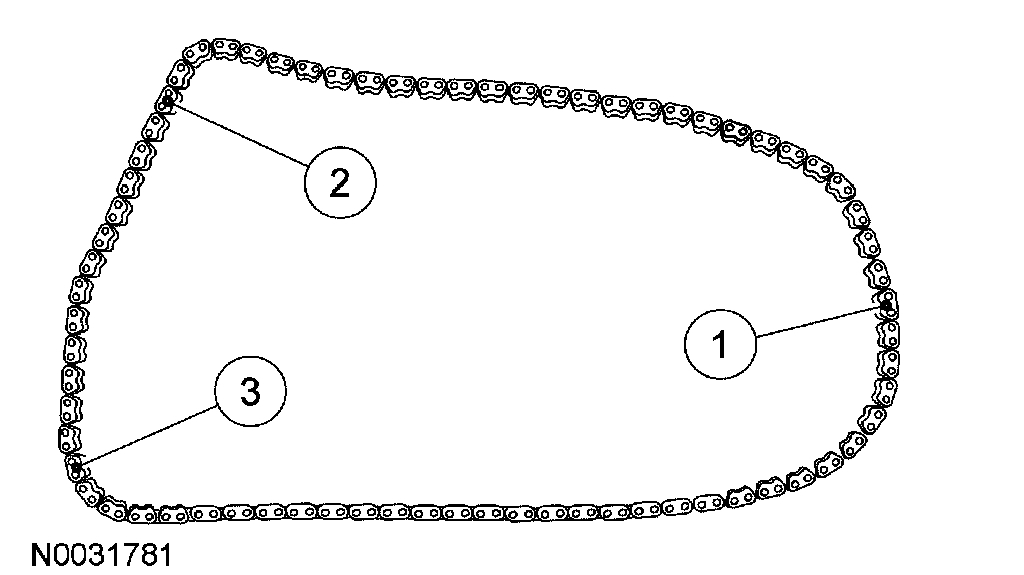

6. If timing marks in the timing chains are not evident, use a permanent-type marker to mark the crankshaft and camshaft timing marks on the LH and RH timing chains.
1. Mark any link to use as the crankshaft timing mark.
2. Starting with the crankshaft timing mark, count 29 links and mark the link.
3. Continue counting to link 42 and mark the link.
Pic 19
7. Position the LH timing chain and guide and install the bolts.

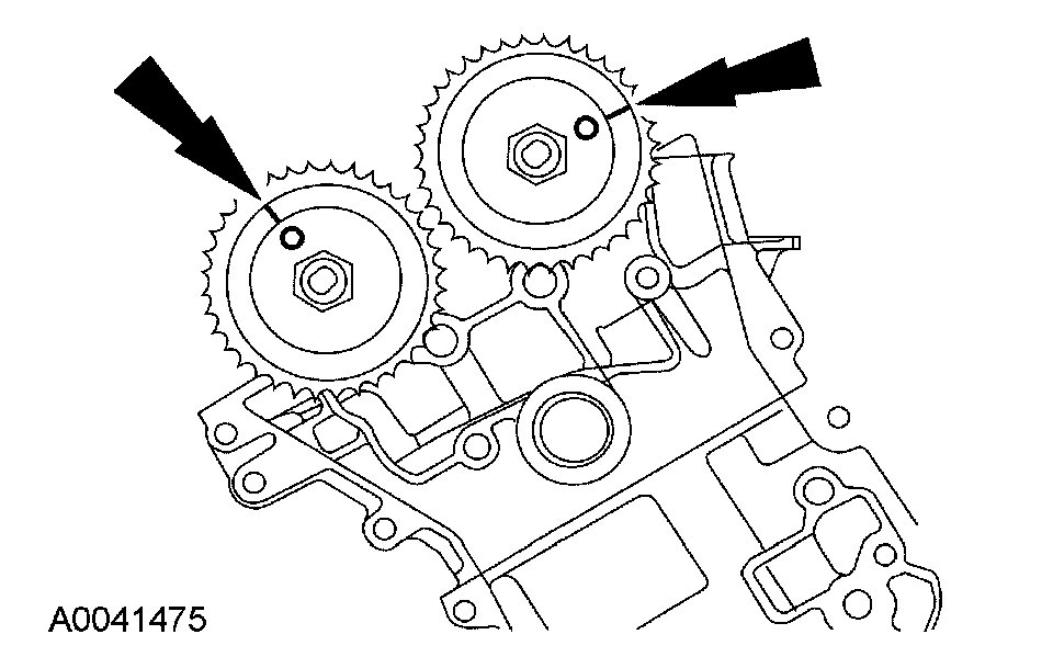

- Align the marks on the timing chain with the marks on the camshaft and crankshaft sprockets.

8. Install the LH timing chain tensioner arm and the LH timing chain tensioner.
1. Install the tensioner arm.
2. Position the tensioner.
3. Install the bolts.
-Tighten to 25 Nm (18 lb-ft).

9. Install the crankshaft damper bolt and rotate the crankshaft clockwise 120 degrees until the crankshaft keyway is in the 3 o'clock position.
Pic 22
10. Verify that the RH camshafts are correctly positioned.

12. Install the RH timing chain tensioner and tensioner arm.
- Tighten to 25 Nm (18 lb-ft).

Verify the timing with the following steps.
1. There should be 12 chain links between the camshaft timing marks.
2. There should be 27 chain links between the camshaft and the crankshaft timing marks.
3. There should be 30 chain links between the camshaft and the crankshaft timing marks.
Pic 26

18. NOTICE: This pulse wheel is used in several different engines. Install the pulse wheel with the keyway in the slot stamped '20-25-34Y-30M" (color blue).
Pic 28
-Install the ignition pulse wheel.

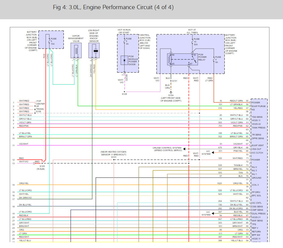

Did everything according to the Alldata directions. Problem, the engine wan't start. Sounds better than before. Cranks over good, but wan't start. First I didn't have spark or fuel. After I put the crankshaft pulley back on I got spark, (I don't know how that effected things). Before I started this project everything run well, just used too much water (with condensation coming out the exhaust). I've had this thing (the timing chain cover) apart three times now and I don't understand why it doesn't work. Each time I put the timing chains back on according to all the instructions I've received, everything looks just like the diagrams you sent. All the electrical connections are right. And I can't find any loose ends or anything disconnected. What I wouldn't give for a distributor, then I could tell where number one is or how far off I am.

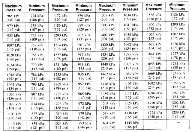

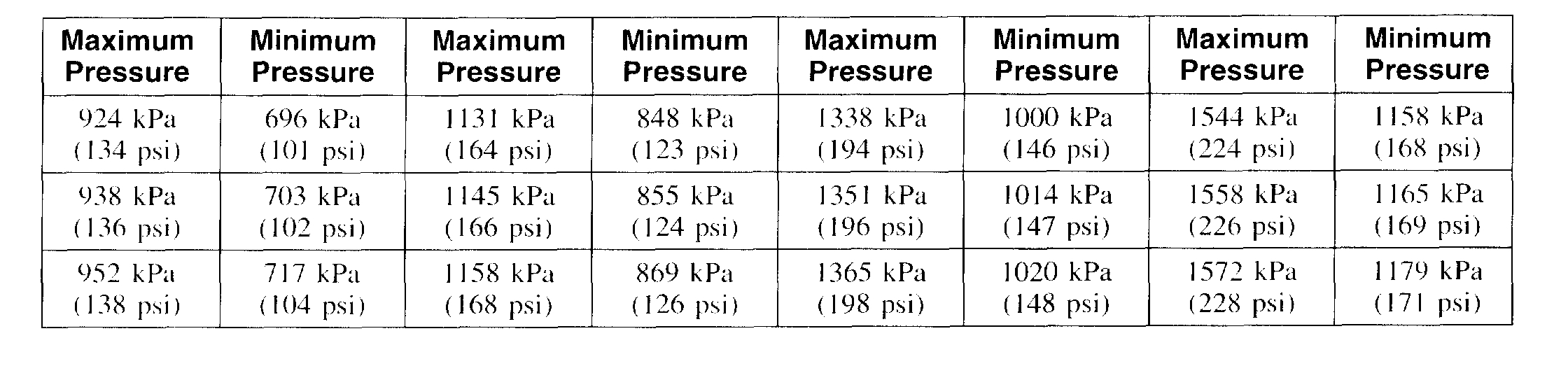

Okay, I need you to check one more thing, engine compression. By doing that, I will know if something isn't together correctly, specifically timing. They are not easy to time. My biggest concern is if you had it together wrong and tried starting it. Ford's 3.0L engine is an interference engine. If not timed correctly, internal damage can occur when cranking.
Do this compression test and let me know the results.

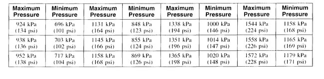

Here are the directions specific to your vehicle. The two attached pictures are related to compression readings. If you have questions related to them, let me know.
AllData Editors Note - Ford does not provide a cranking pressure specification, only an acceptable range.
Compression Test Compression Gauge Check
1. Make sure the oil in the crankcase is of the correct viscosity and at the correct level and that the battery is correctly charged. Operate the vehicle until the engine is at normal operating temperature. Turn the ignition switch to the OFF position, then remove all the spark plugs.
2. Set the throttle plates in the wide-open position.
3. Install a compression gauge such as the Compression Tester in the No. 1 cylinder.
4. Install an auxiliary starter switch in the starting circuit. With the ignition switch in the 0FF position, and using the auxiliary starter switch, crank the engine a minimum of five compression strokes and record the highest reading. Note the approximate number of compression strokes required to obtain the highest reading.
5. Repeat the test on each cylinder, cranking the engine approximately the same number of compression strokes.
Compression Test-Test Results
The indicated compression pressures are considered within specification if the lowest reading cylinder is at least 75 percent of the highest reading. Refer to the Compression Pressure Limit Chart.
picture 1
picture 2
If one or more cylinders reads low, squirt approximately one tablespoon of engine oil on top of the pistons in the low-reading cylinders. Repeat the compression pressure check on these cylinders.
Compression Test Interpreting Compression Readings
1. If compression improves considerably, piston rings are faulty.
2. If compression does not improve, valves are sticking or seating incorrectly.
3. If two adjacent cylinders indicate low compression pressures and squirting oil on each piston does not increase compression, the head gasket may be leaking between cylinders. Engine oil or coolant in cylinders could result from this condition.
Use the Compression Pressure Limit Chart when checking cylinder compression so that the lowest reading is at least 75 percent of the highest reading.

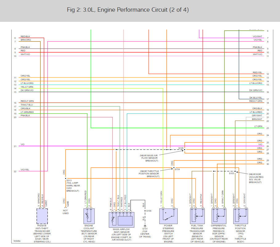

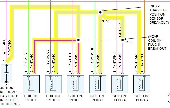

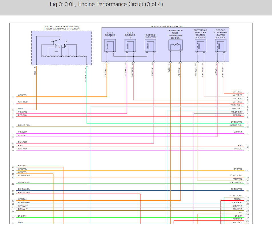

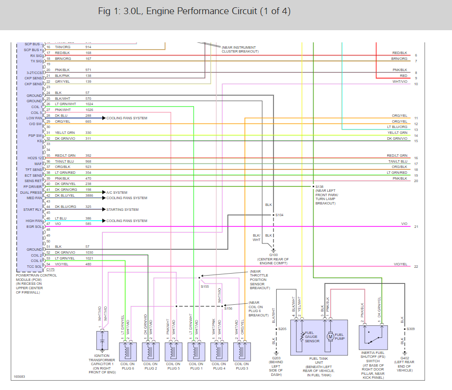

What I found is I'm not getting proper voltage to the coils. I checked #'s 4, 5, and 6. While cranking, each coil connector produced only 1.5 to 3.0 volts. Very low voltage, right? I had my volt meter set to 20 volt D.C. Setting. I hope my meter isn't bad also. Is it common to have to plug in a code reader after changing anything? Will that help? Could the crankcase position sensor have something to do with my problem? I haven't checked the fuel pressure yet. I wanted to correct the voltage problem first.
Wednesday, August 12th, 2020 AT 1:34 PM
  • 110,194 POSTS
Welcome back:
That is too low. Retrace your original steps to confirm there are no wires pinched or damaged where you worked. Take a look at the attached picture. Note that all coils are spliced together (white/violet). I highlighted the wires I'm referring to, so they appear yellow. Note the location of these splices as indicated and confirm condition.
Make sure nothing is loose, damaged, pinched and so on.
Let me know the results.
DWAIN JONES
  • 27 POSTS
I checked the wiring from the coil connectors to the PCM. Have continuity all the way. No wires grounded. Checked again for voltage on coil and on injectors, injectors 12+ volts, coils, zip. Would a code reading help? Is there any way to reset the PCM?

No reset on the PCM. However, have you checked at the PCM for power to the coils? You could have a wiring issue between the two.
DWAIN JONES
  • 27 POSTS
Sorry, Joe. I don't understand your message. I HAVE (not yelling, just can't find the underline key) continuity from the coil all the way back to the PCM. Its like a wire straight from the coil to the PCM. If I have power at the PCM it should make it to the coil, right? So, If I don't get voltage to the coils then could I have a problem with the PCM? You say there is no reset?
  • 110,194 POSTS
Welcome back:
No problem. If you have power at the PCM but not to the coil, there is a break in the wire. Check it for continuity. If there is no continuity, the wire is broken at some point and creating an open circuit. Thus, the power can't make it to the coil.

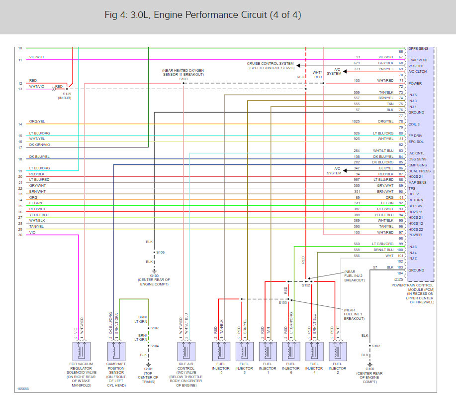

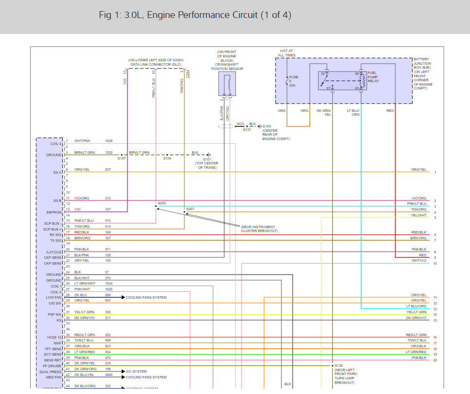

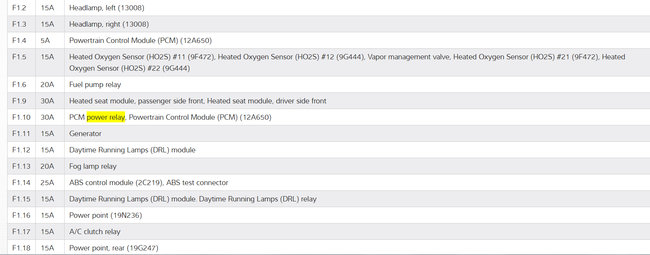

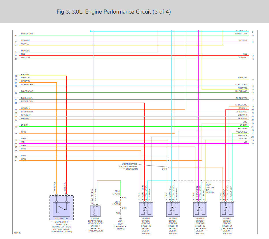

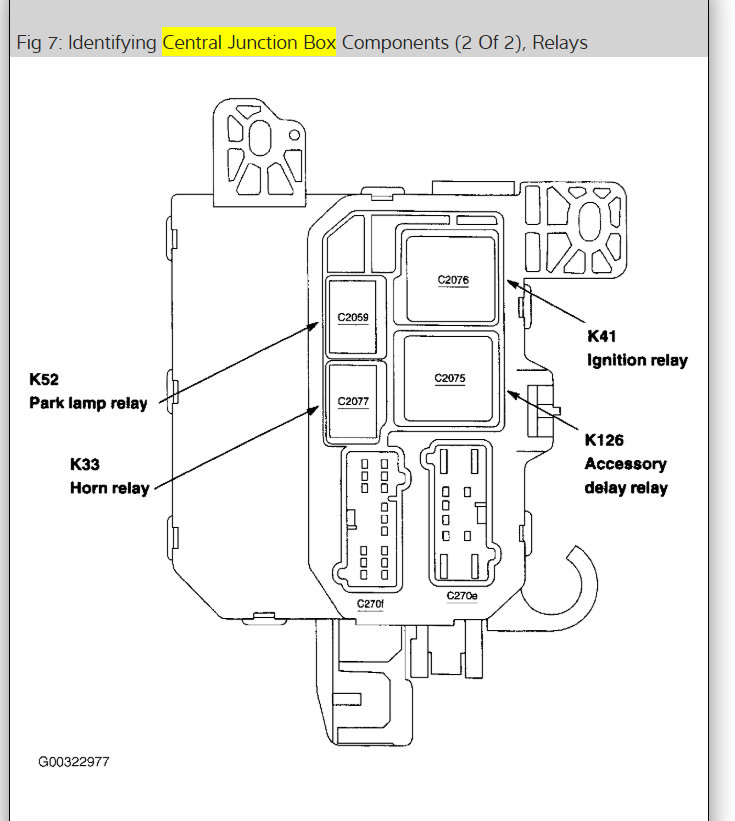

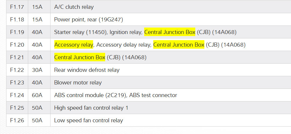

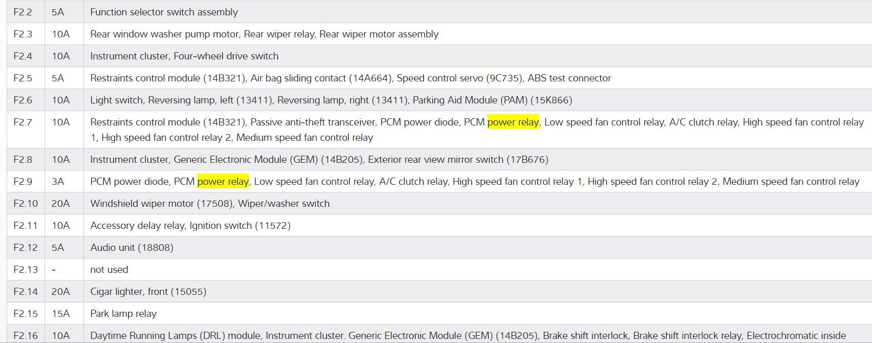

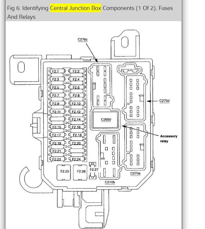

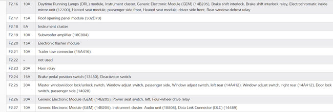

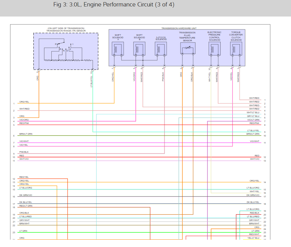

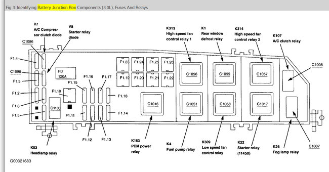

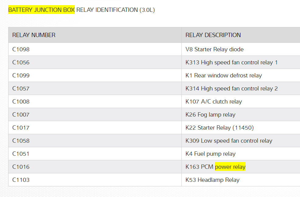

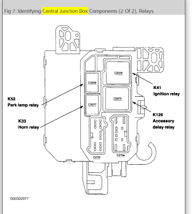

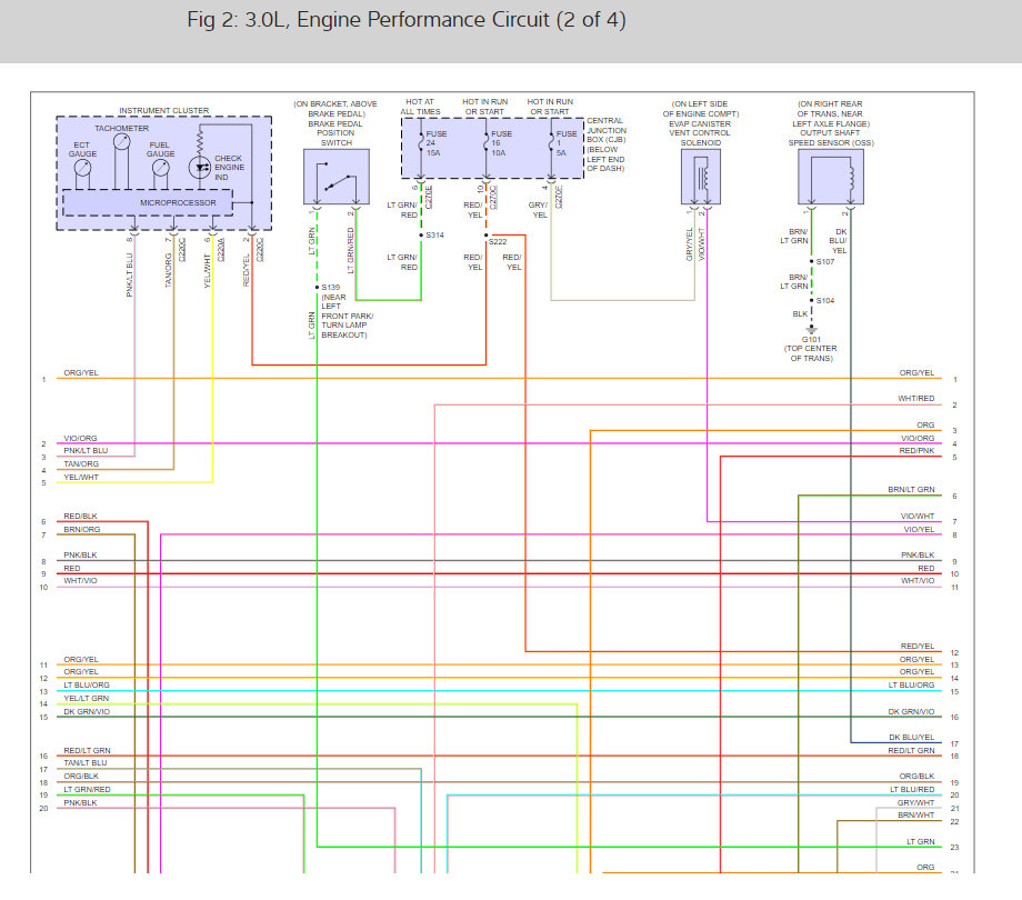

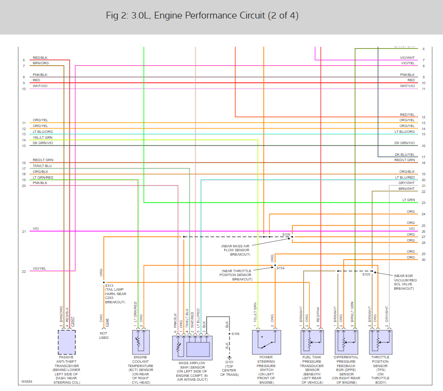

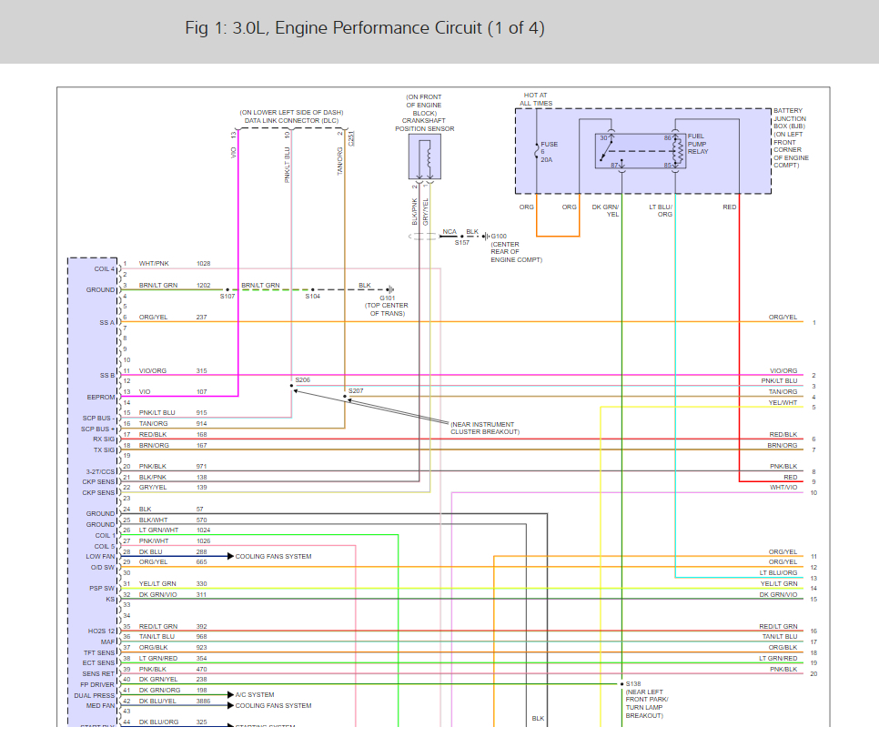

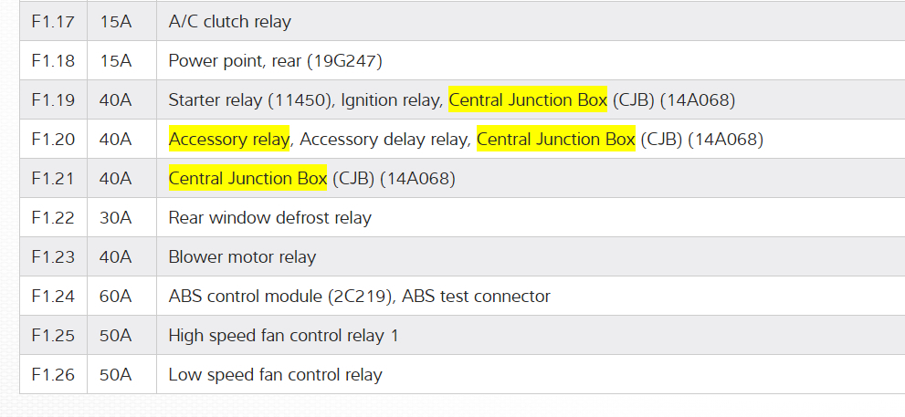

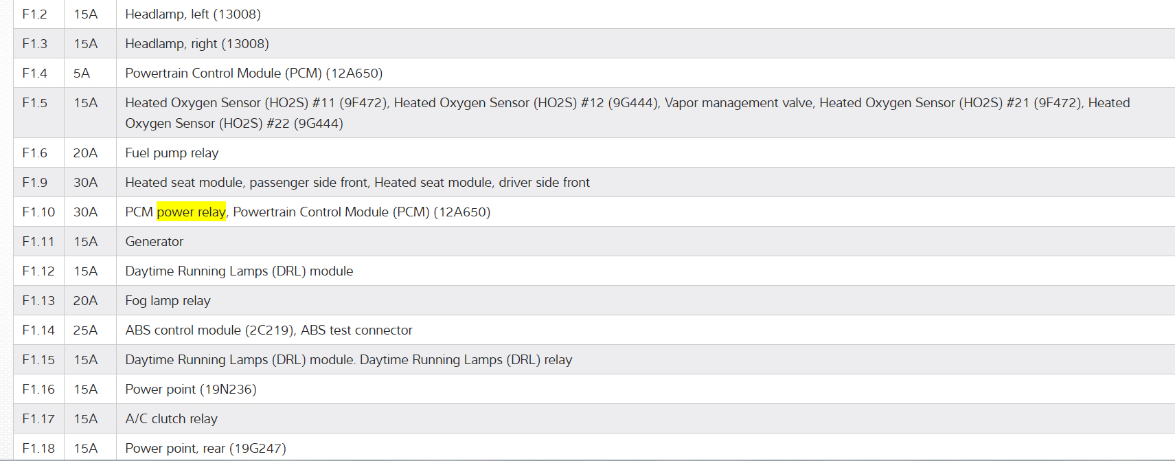

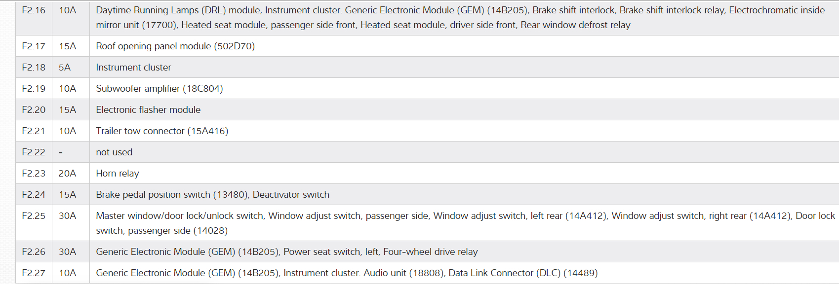

Will it run on starting fluid? With the key on do you have 12 volts at the coils? I would check all system grounds here is a guide to help you test the wiring and the engine wiring diagrams so you can see how the system works.
Make sure the PCM and ignition relay is working as well. Check out the diagrams (Below). Please let us know what you find. We are interested to see what it is.

At the moment I have the timing chain cover off again. I was waiting for the mechanic I hired to look at the timing, but I've lost all confidence in him after he tells me he would take time to look but he changed that to when he had time. He also told me there is a special tool to set the timing on this engine, plus, he told me over the phone the timing marks could not be on if I set it right. Back to your request. I think my camera could pick up the sound. Have a great weekend.
  • 110,194 POSTS
Welcome back:
Since you have it apart again, follow the directions I listed above. There should be marks on the timing chains for each side. If there are no marks, follow the directions for counting the links in the chain. This is very important. I will also add that if it was put together wrong, it may have damaged internal parts (valves).
