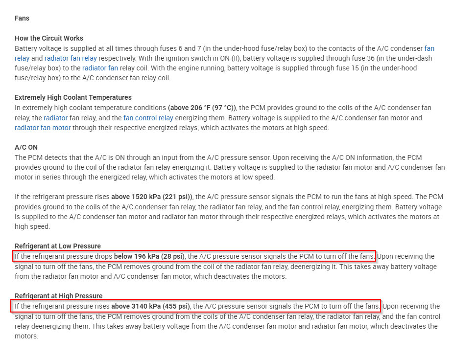

You could be correct but I am starting to wonder if we have a different issue that is causing the fans to be off. Take a look at this that I just found. I highlighted the two sections we need to check. Basically we need to hook up a gauge set and see what the pressure is on the high and low side.
Let's check the pressures of the A/C system and just make sure they are okay. If they are, check to see if the compressor comes on when you turn it on. if it does then the pressure switches are okay.

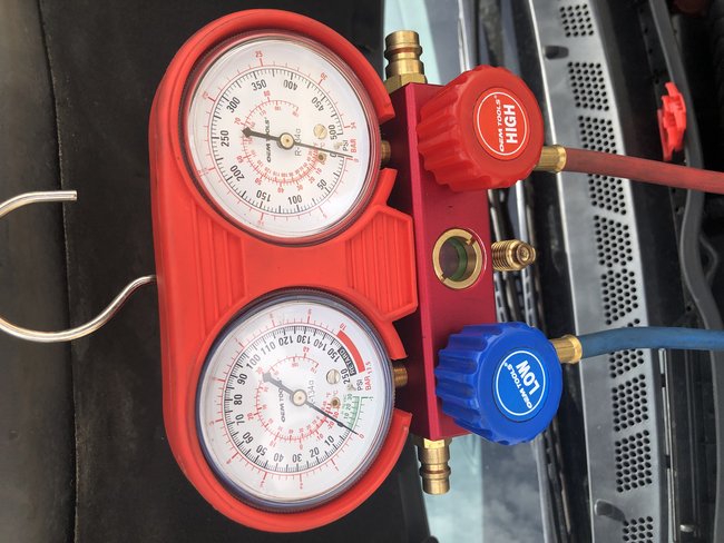

Let's rent a gauge set from a tool rental just to see what the pressure is even though we can probably assume it is pretty empty.

Wow, looks like I have zero. Thought it would be a little something, but nope. Another project for another time.

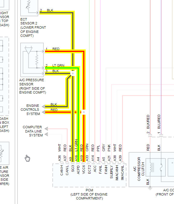

Okay. That is positive news towards the fan issue but the set back is your A/C pressure sensor is a 3 wire sensor that is wired to the PCM. That means it is not an on/off sensor. It actually has a resistor in the PCM and tells the PCM what the pressure is. That means we can't jump the switch and "trick" the PCM that the pressure is above the minimum. If it were a two wire switch then if the pressure is above the minimum threshold then the switch closes and the PCM just senses 12 volts and knows the pressure is not too low.
So this is what I would suggest: Get one of those refill cans so that you can get the A/C pressure above 28 PSI so the PCM will allow the fans to run.
Take a look at the attachment and tell me if you read that the same way I do. The PCM will shut the fans off if the A/C pressure is below 28 PSI. If you agree, let me know what happens.

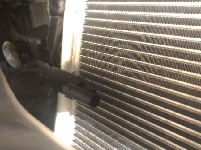

What is this sensor? It’s unplugged. When I trace down the connector, it goes to something else instead.

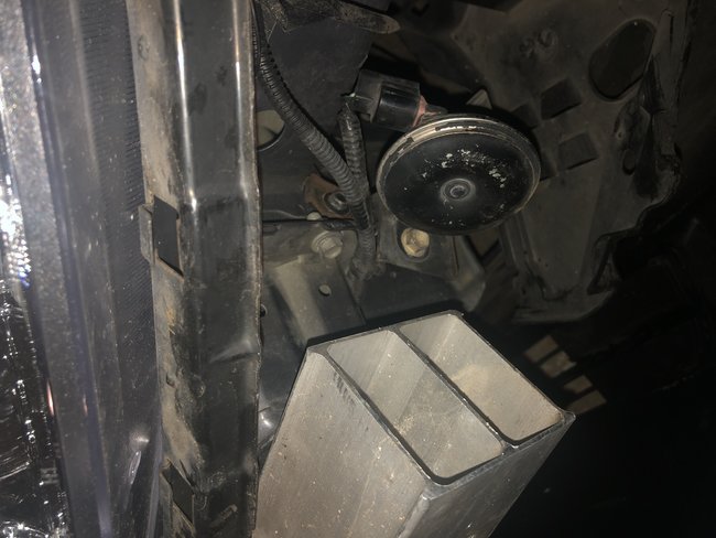

It goes to this round diaphragm thing.
Tuesday, August 25th, 2020 AT 11:19 PM
I am not sure. However, we need to get a new post started for that one because I am sure others in the future will want to identify this and they will not find it on this post. If you can also post these pictures along with a couple others or at least a general location of where this is as it is hard to orientate where this is.

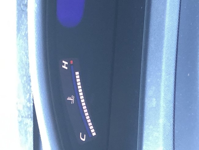

Okay. Replaced the condenser. Recharged the A/C to 35. Everything is holding good. Cold air coming out of the vents. Both fans are spinning. That has got to be an improvement.
Took it for a drive, and after about 10 minutes, temperature drastically started to rise, and starts to overheat. I pull over, and it slowly goes back down to 1/3. Tried again, and same thing. Did not let it get that hot though. Figured over half, it is going to do it again.
Thursday, August 27th, 2020 AT 3:25 PM
Okay. Just to confirm, because this is a long post, originally your fans did not come on and the vehicle was overheating. Now after this repair to the A/C system the fans are coming on but the vehicle is still overheating?
If this is the case we have made progress. Now let's look at just the cooling system. Let's try something to try and narrow this down. If you start the vehicle after making sure the coolant is full and just let it idle does it overheat? The fans should be on and clearly it should not overheat. However, if it overheats just idling then I suspect we have restriction in the cooling system. Let's do this and go to the next step.
