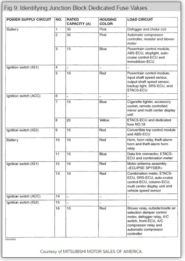

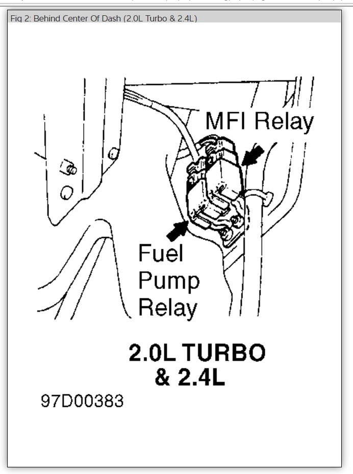

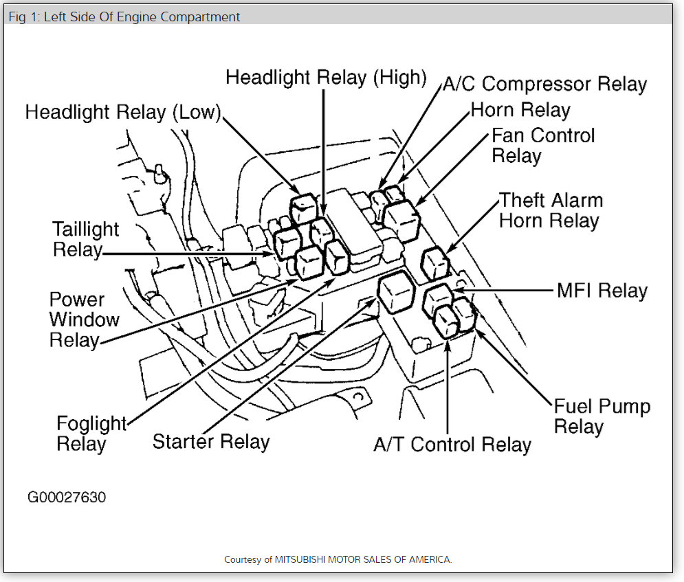

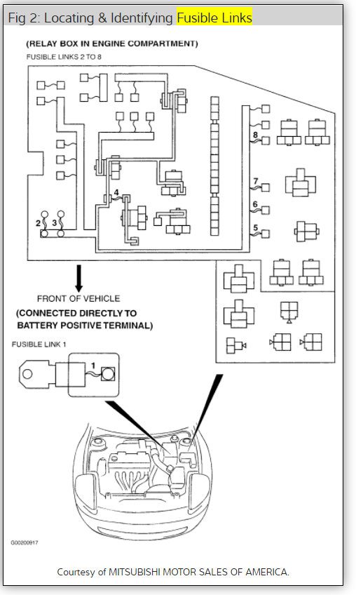

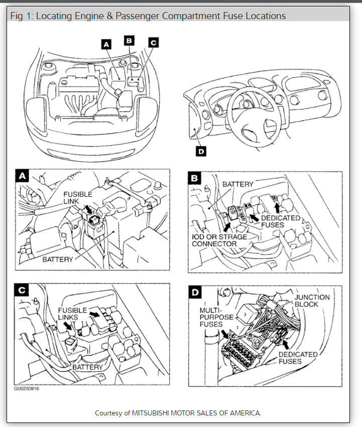

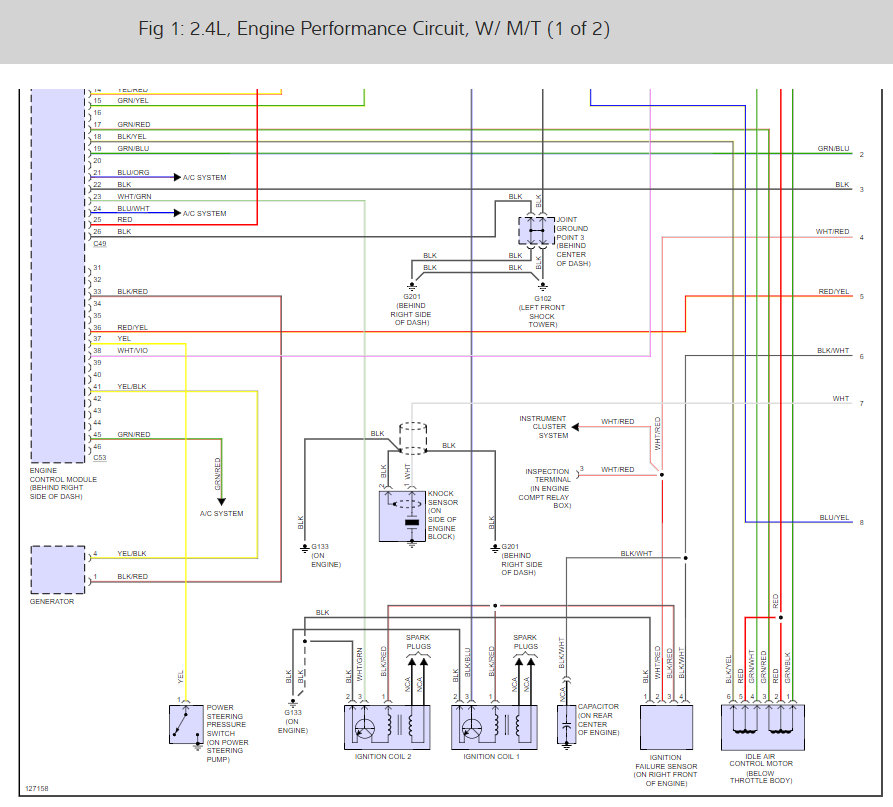

I have a no start issue. the car cranks but will not start. i have no spark ans no power to any of my sensors. i do have power to my coil pack and fuel pump, but my fuel pump will not kick on. i also have a no link when i connect the OBD reader. i have replaced the crankshaft sensor, the camshaft sensor, the fuel pump and one fuel pump relay's. i also replaced spark plugs wires, spark plugs, coil packs and three injectors.
also, when i test for a short using the method of a test light n the negative cable and pulling the fuses one by one the light turns of on the fuse with the picture of car door unlocking, meaning the anti-theft fuse. how can i fix my problem?
Jan 7, 2018 at 3:13 PM
  • CAR REPAIR CONTRIBUTOR
  • 54,334 POSTS

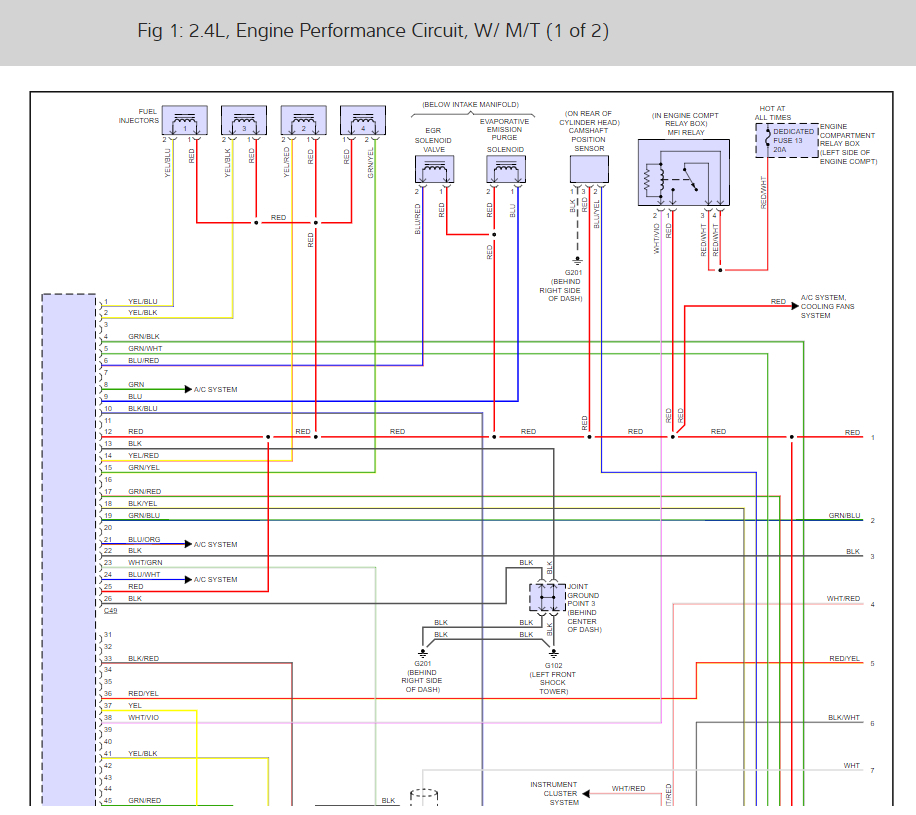

It sounds like you have an MFI relay that is out or a fuse that is blown here are guides to help you do some testing a long with the relay and fuse locations. Also, check the fusible links as well.
and
Jan 9, 2018 at 1:32 PM
YASMIN RAMIREZ
  • 10 POSTS

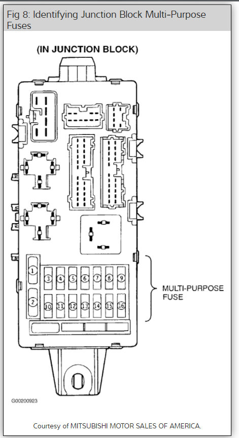

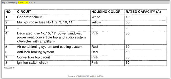

Thank you so much for responding ive checked all the fuses all of them are good except when i first did the finding a short test by disconnecting the negative and clipping the test like from the connecter and the post of the negative battery the light was on then i pulled each fuse one by one until the light shut off which was the fuse that controls the lock and unlock the antitheft fuse 13 i believe the fuse was not blown tho i have no power going to my oxygen sensor camshaft crankshaft sensor i do have power to coil packs the car does crank and there is power going to my fuel pump even with starter fluid being used the car still wont turn on the timing is correct on the car the check engine light also does not turn on in the dash im guessing thats why the obd reader says no link so i will look at all the diagrams u sent me and work on it also the problem started on a cold morning i went out to warm up the car and all of a sudden it turned off n ever since then it hasnt turned back on
Jan 9, 2018 at 10:43 PM
  • 54,334 POSTS
Yep it is sounding more like the MFI relay or the power source to the relay please use a test light and check when you can.

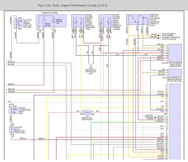

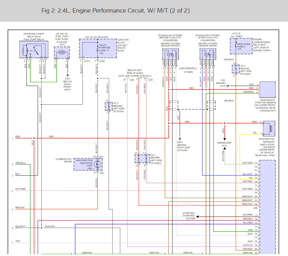

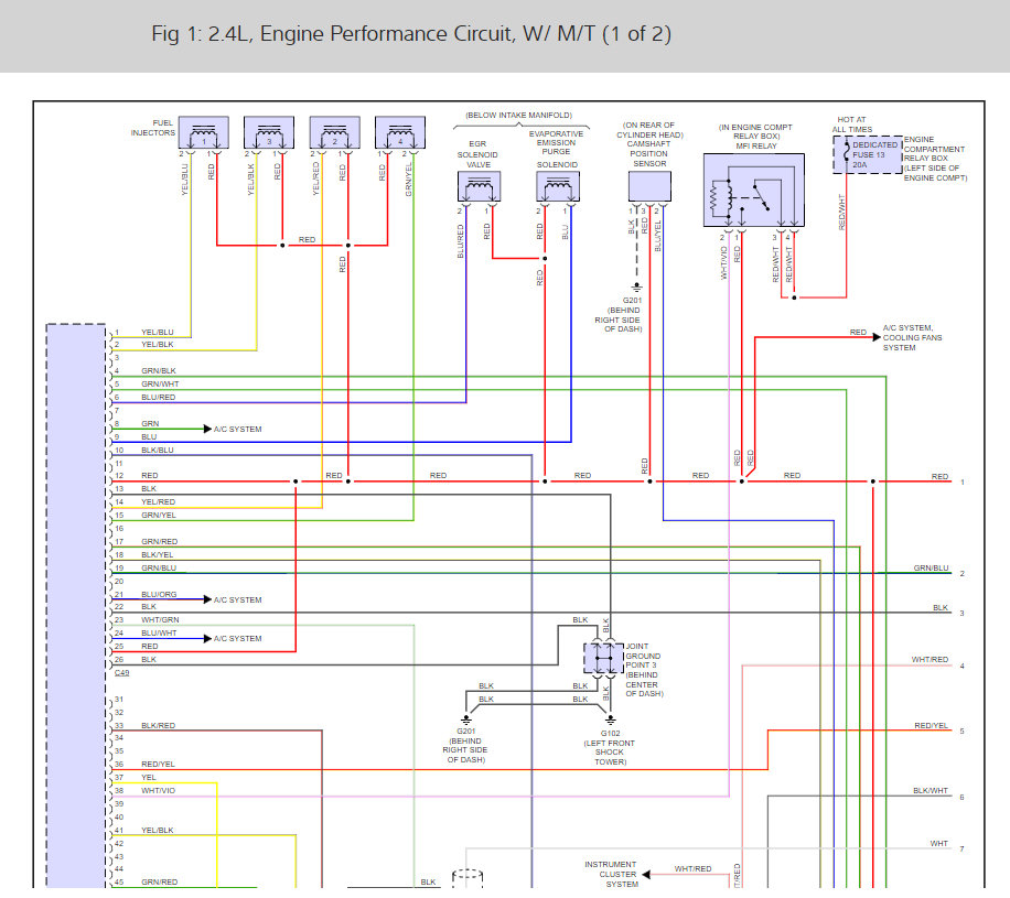

Thank you so after checking and replacing all the fuses and relays with the diagrams you gave me now i have power to my fuel pump and fuses i still have one issue so the car still wont start the o2 sensor if the front had been previously cut by the previous owner and i dont no how its suppose to wire it has a total of 5 wires 1 black 1 white 1 stripped just copper wire 1 red and 1 brown
Jan 14, 2018 at 9:38 AM
YASMIN RAMIREZ
  • 10 POSTS

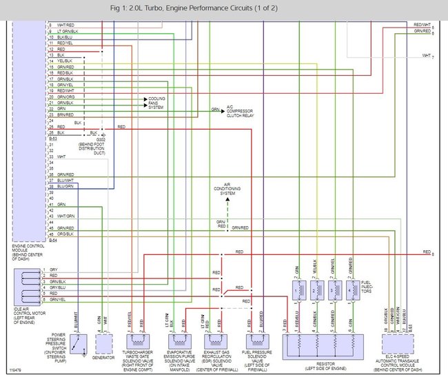

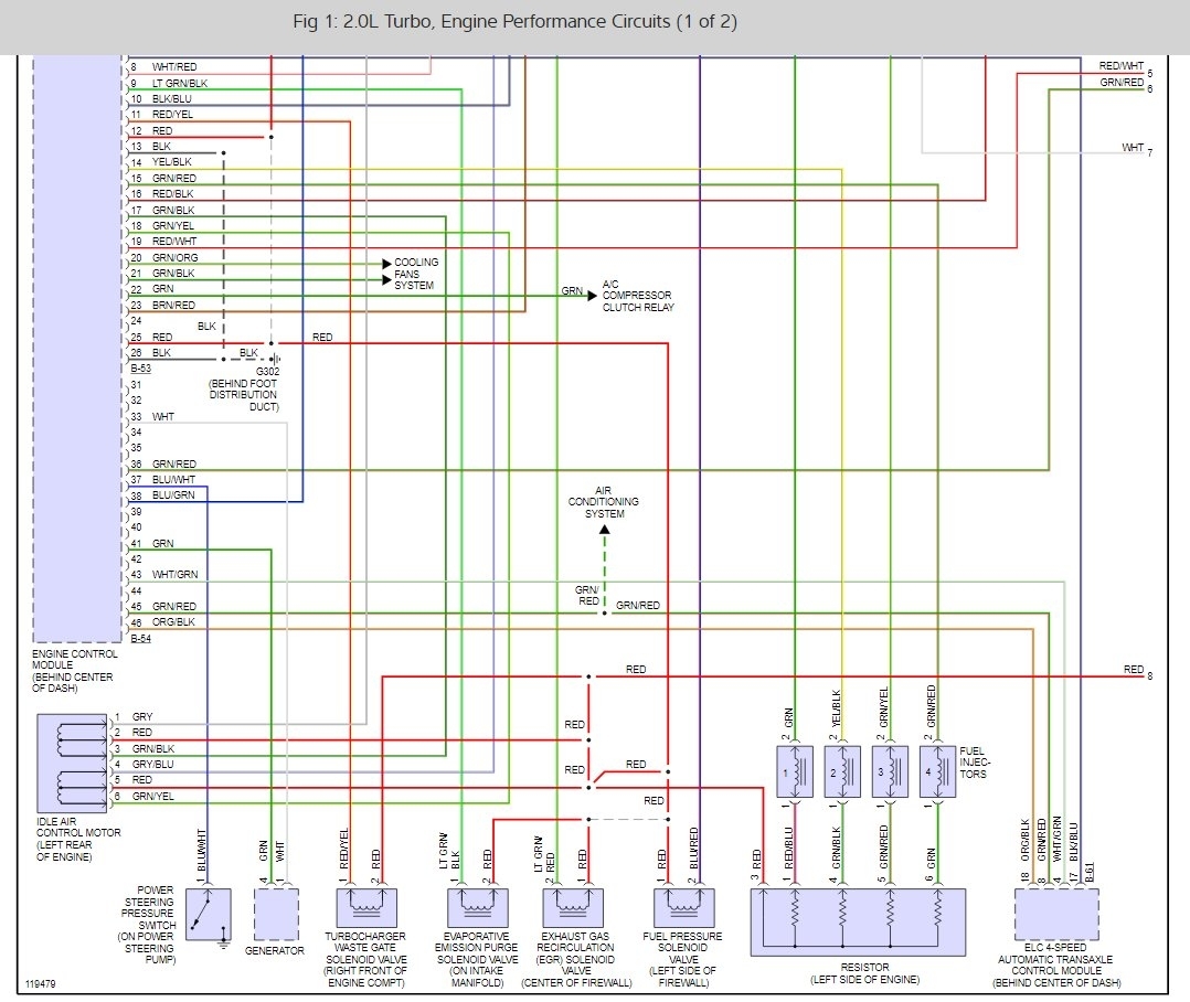

I guessed on the wiring n connected the white the black n copper wite together and left the brown trigger wire alone n connected the red to the black and red ignition wire to get power to the sensor when i move the wiring i hear a poopping noisr from the fuse box meanig something is not connected correctly i cant find a wiring diagram anywhere for the front oxygen sensor
Jan 14, 2018 at 9:42 AM
  • 54,334 POSTS
The wiring for the oxygen sensor are on the third wiring diagram over toward the top. Let me know if you need further instruction.

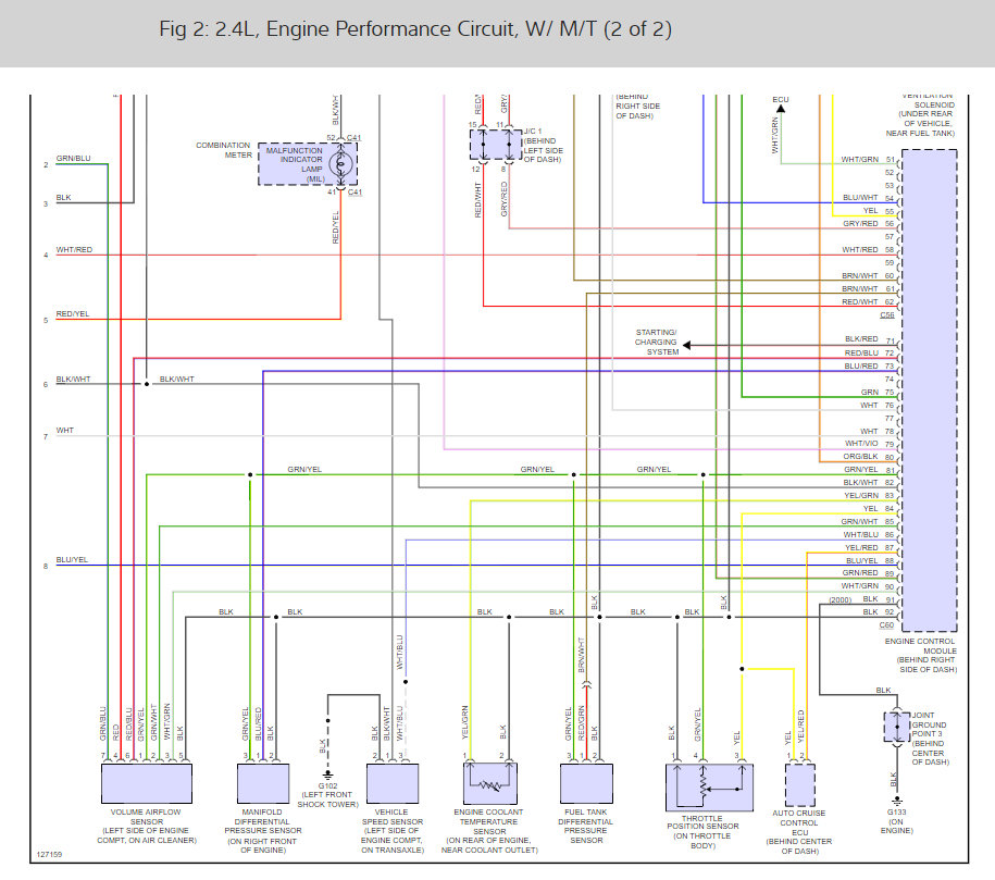

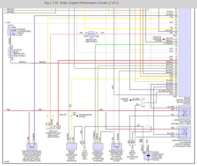

So i checked everything as you advised and replaced some relays and fuses and the car started but the obd reader gave me a po340 code i drove the car down the street and the car died on me now it wont start back up i checked all my sensor they all have power i also replaced the starter because the starter was bad
Jan 19, 2018 at 6:26 AM
  • 54,334 POSTS
That code is for the camshaft position sensor. I am wondering if you have a timing belt that is slipping or moved a tooth. Have you done a timing belt on it or can you confirm that it is correct?

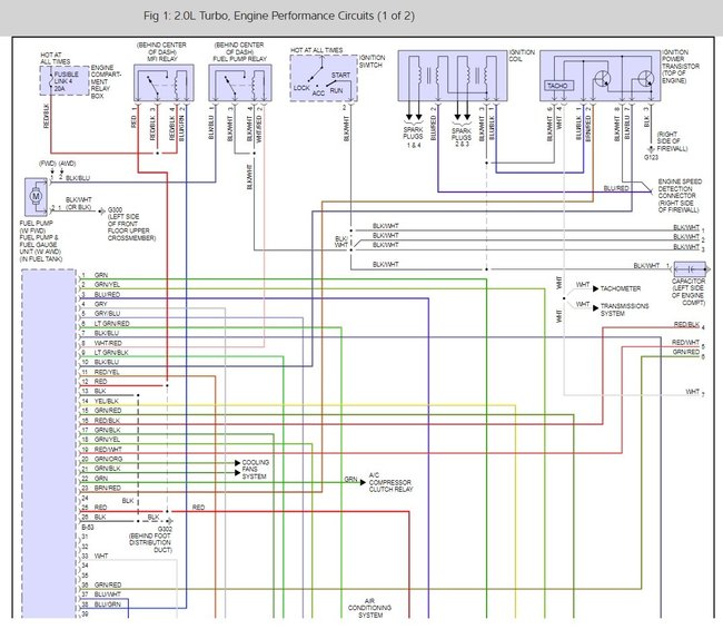

Yes the timing is correct i have spark i have fuel and power to all my sensors what i dont have power to is to my starter relay and a small black relay in the engine compartment i have no idea why need a diagram for the starter relay
Jan 23, 2018 at 8:07 PM
  • 54,334 POSTS

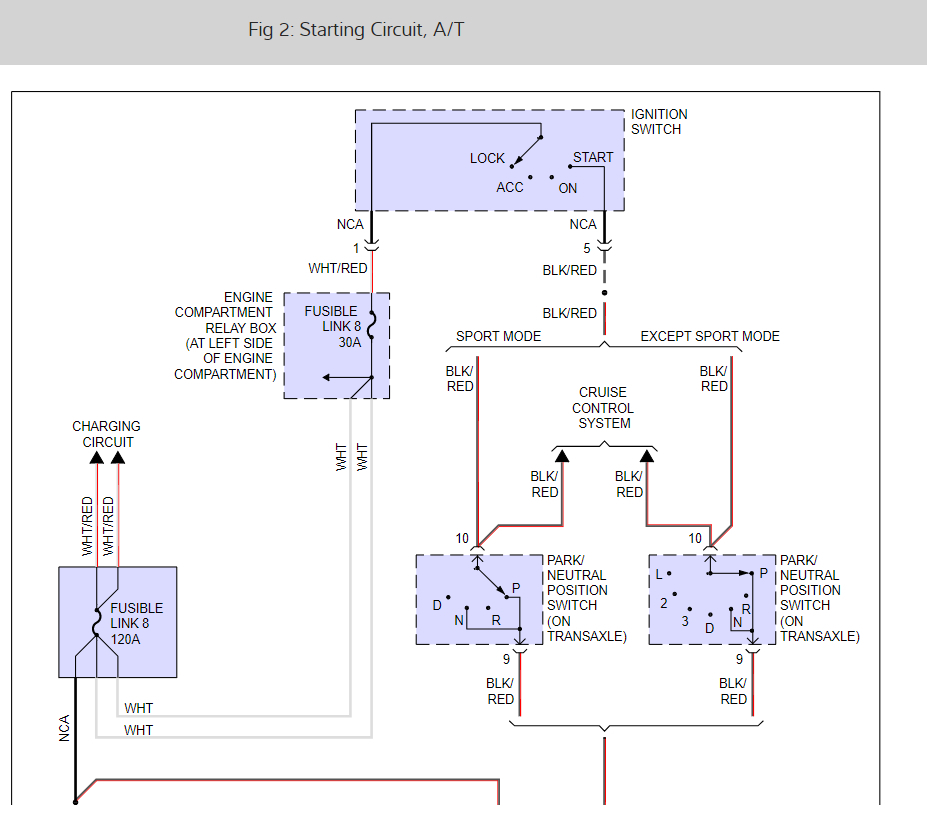

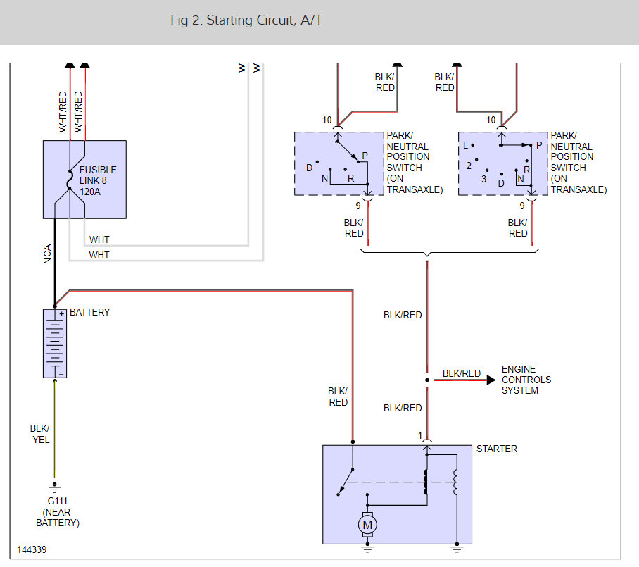

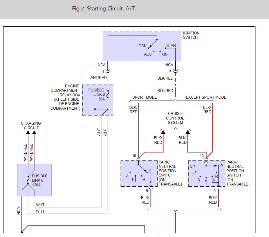

Lets check for where you are losing power. Here is a guide and a wiring diagram to help you do some testing.
It doesn't seem to have a starter relay.

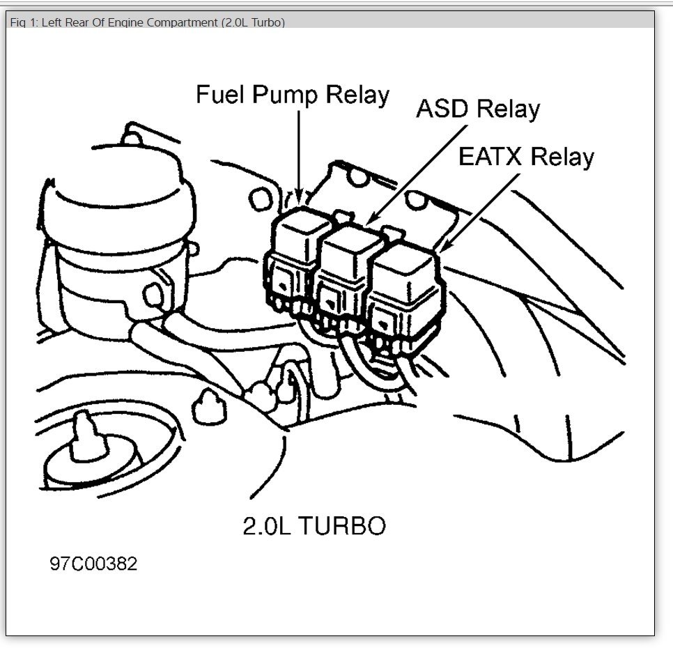

When I first got the car it would not crank at all. After I bought a new fuel filter, spark plugs, and cam shaft sensor, It cranked right up. the only problem after that is that when the engine warmed up, if I cut it off, it wouldn't start back up until it cooled all the way down. I was advised that the new problem could be a faulty crankshaft position sensor. Before I could put the crankshaft sensor on, it started having the original turn but no start problem. I know the fuel is still pumping but when I checked the spark plugs, they where receiving no power. What could stop power from flowing to the coil pack and injectors.
Apr 1, 2019 at 6:19 PM (Merged)
CARADIODOC
  • 34,309 POSTS
First lets clear up some terminology so we're both talking about the same things. "Would not crank at all" is a starter problem. The spark plugs and fuel filter aren't even in the picture yet. If the starter is cranking the engine, you have most likely had the same problem all along but you replaced the wrong parts. The place to start is by reading the diagnostic fault codes. Mitsubishi and Chrysler have a lot of things in common but I don't know if reading codes is one of them. With Chryslers, cycle the ignition switch from "off" to "run" three times within five seconds, leave it in "run", then count the flashes of the Check Engine light. You'll get from one to five flashes for the first digit, a short pause, then a series of flashes for the second digit. After a longer pause the next code will flash the same way if there is one.
The most common failure is the camshaft position sensor. The Engine Computer needs to see pulses from it and the crankshaft position sensor, then it knows the engine is rotating, (cranking or running). When it sees engine rotation, it turns on the automatic shutdown (ASD) relay. That relay sends current to the ignition coil, injectors, and fuel pump or pump relay.
Both of these sensors commonly start to fail by becoming heat-sensitive. They will either stop working after the engine has warmed up, resulting in stalling, or they'll fail right after a hot engine is turned off and that heat migrates up to them. You'll have a "cranks / no-start" condition, but it will work again once it cools down for an hour.
To verify the rest of the ASD relay circuit is working, monitor the voltage at the ignition coil or any injector with a test light. A voltmeter will work too but some don't respond fast enough to be accurate. You will see the test light light up for one second after turning on the ignition switch. That tells you the circuit is working and the computer has control over the relay. The test light should turn on again during engine cranking. If it does, and it stays on steady, you have a fuel pump OR a spark problem. Both are relatively rare. Most commonly the light will not turn on during cranking. That's when you look at those two sensors.
