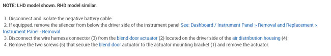

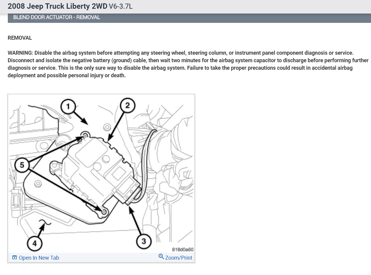

My heater is not working correctly you can feel heat coming out of the vents on the first notch and a little bit on the second after you move it up further it blows out cold air. The coolant level is fine my car does not overheat to as far as I'm aware the thermostat is fine and when you touch me heater core it's hot. In the air conditioning works fine with all the vent I have been told so many different things I was told I need to flush the heater core, it could be the heater switch that controls it and I was also told I can be the vent relay control console. I'm just wondering if you have any ideas. Another thing that happened is yesterday when I got in the car nothing is coming out of the vents when I would turn the knob I could hear some clicking like from underneath the dashboard. Don't know if that's related not. That help when I restarted the car everything was fine. Please help I don't have a lot of money to be putting in to checking everything. Also if I had hooked up to one of those computer machines would that be able to tell me what it would be?
Friday, September 11th, 2020 AT 12:07 PM (Merged)
KEN L
  • MASTER CERTIFIED MECHANIC
  • 55,512 POSTS

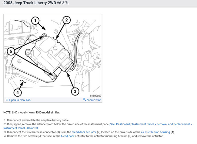

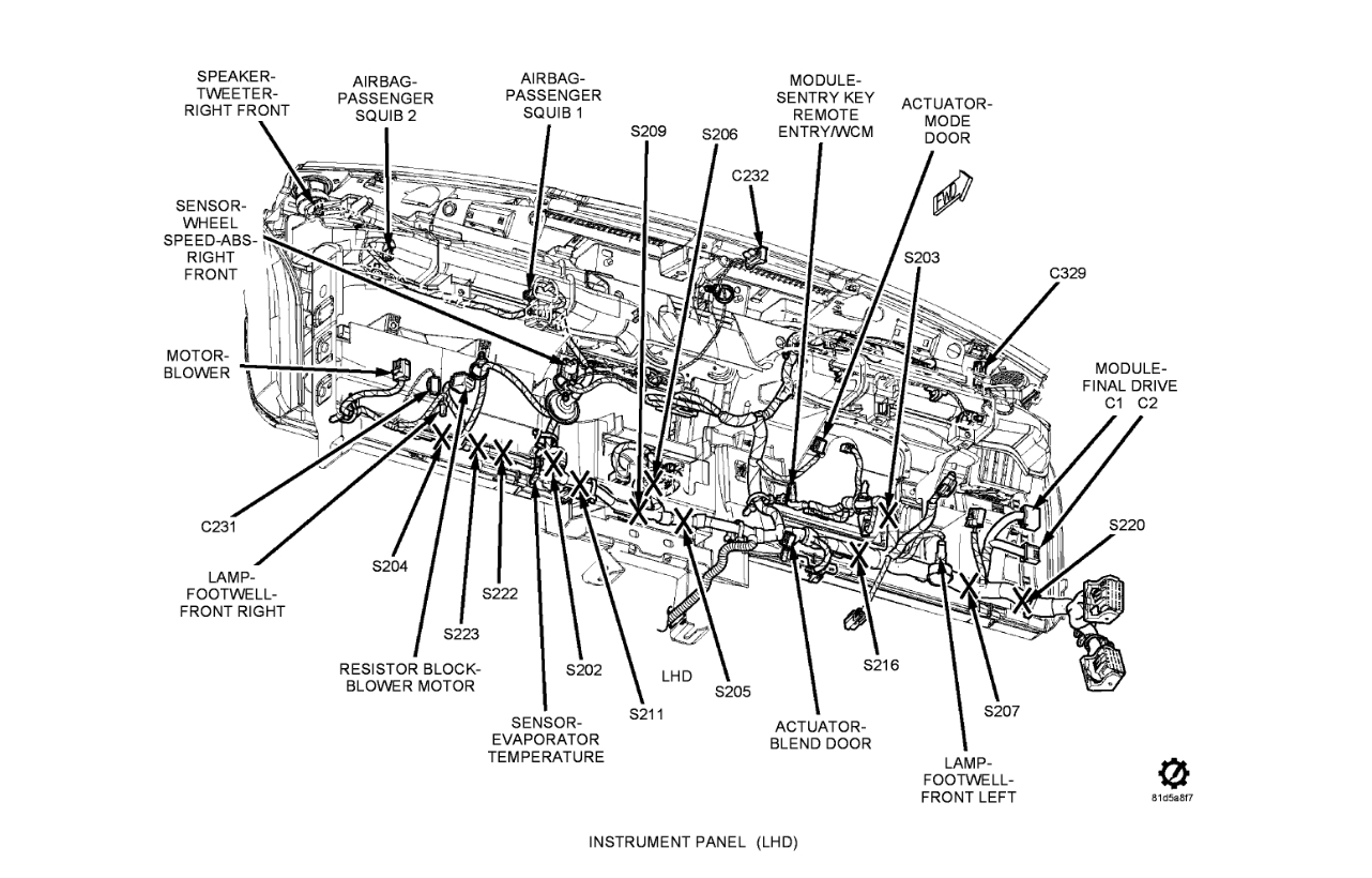

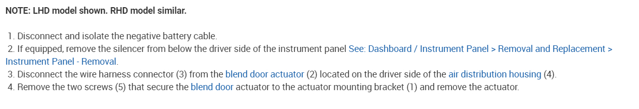

The clicking is a clue that the temperature blend door actuator is not working correctly. Here is a guide to help you step by step with instructions in the diagrams below to show you how on your car. Turn the system on so you can hear the noise then use your hand to feel which actor is making the noise.
This guide can help as well:

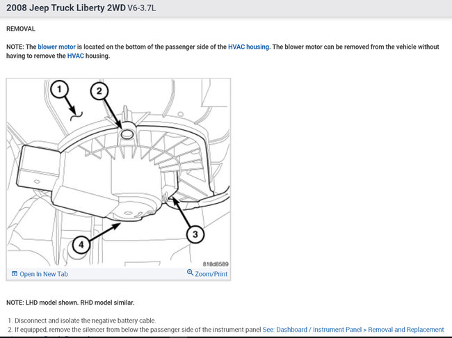

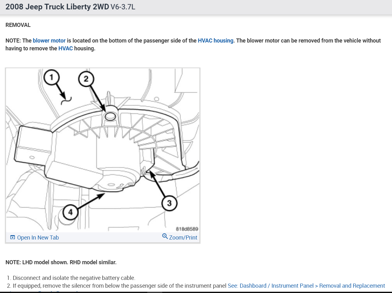

Okay, it sounds like the blower motor might be going out which is common. here is a guide to help test the motor and show you how to check the power and grounds. The heat will still be the actuator.
https://www.2carpros.com/articles/blower-fan-motor-works-on-high-speed-only

HOMER1967
  • 875 POSTS
It sounds like you have a temperature blend door actuator that is not working here are two guides to help walk you through the steps of changing it with the location in the diagrams below to show you how on your car.
+3
DEA10
Thank you for this post I got a new actuator everything works again FYI.

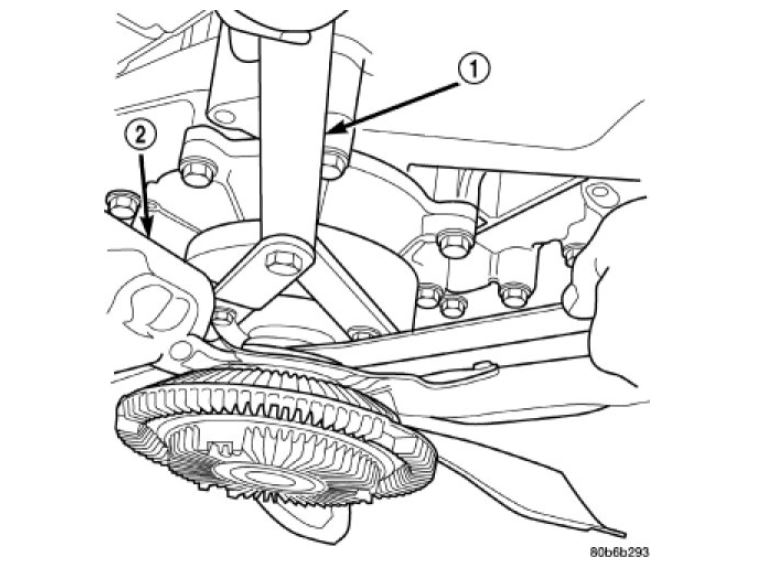

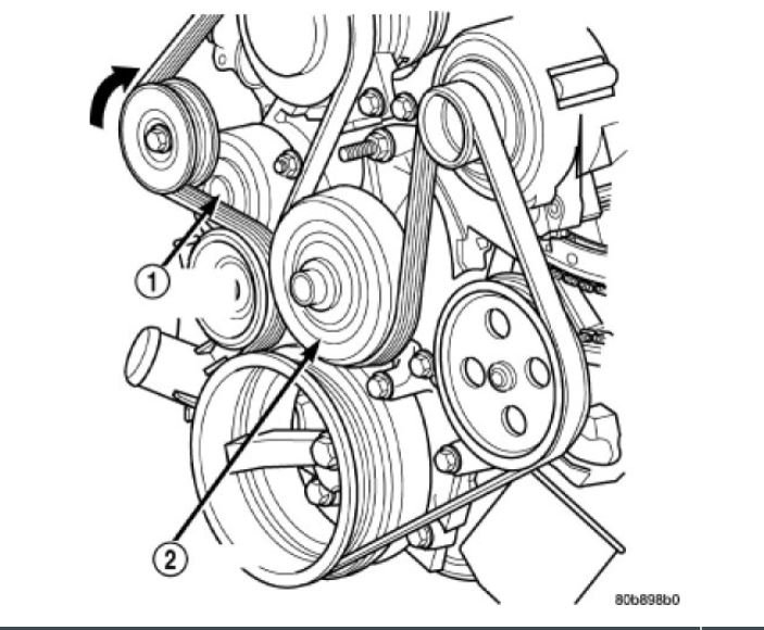

Good afternoon,
If you have no flow to the core, then you either have clogged hoses or a bad water pump. Was the coolant level topped off when you removed the hoses?
Does the car overheat?
1. Disconnect negative battery cable.
2. Drain cooling system See: Cooling System > Procedures > Cooling System - Standard Procedures.
3. If water pump is being replaced, do not unbolt fan blade assembly from thermal viscous fan drive.
4. Remove two fan shroud-to-radiator screws. Disconnect the coolant overflow hose.
5. Remove upper fan shroud and fan blade/viscous fan drive assembly from vehicle.
6. After removing fan blade/viscous fan drive assembly, do not place thermal viscous fan drive in horizontal position. If stored horizontally, silicone fluid in viscous fan drive could drain into its bearing assembly and contaminate lubricant.
ImageOpen In New TabZoom/Print
7. Remove accessory drive belt (1) See: Drive Belt > Removal and Replacement > Accessory Drive Belt - Removal.
8. Remove lower radiator hose clamp and remove lower hose at water pump.
9. Remove seven water pump mounting bolts and one stud bolt.
CAUTION: Do not pry water pump at timing chain case/cover. The machined surfaces may be damaged resulting in leaks.
10. Remove water pump and gasket. Discard gasket.
