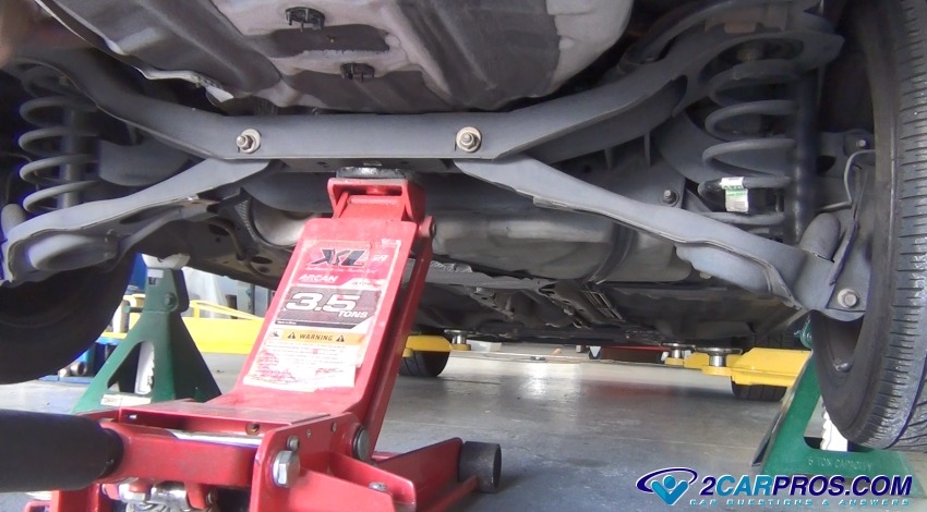

Step 4 - This problem happens more than I thought at first, but after reviewing many posts with the same problem the fix was relatively simple. With the engine running at full temp jack the front of the car up and let it run for 2 minutes then go to the rear of the car and do the same thing, this will burp or purge the air bubbles locked in the heater core and allow the heater to work again.

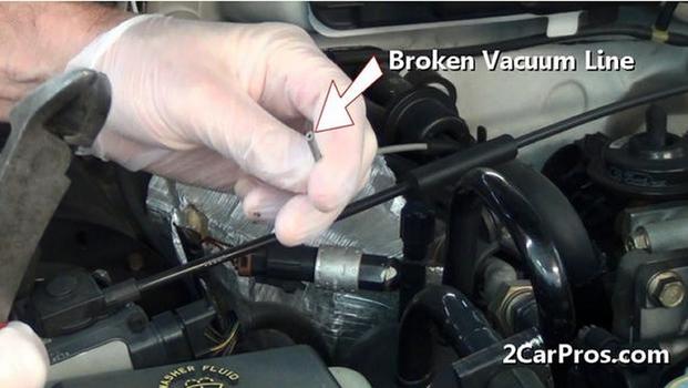

Step 5 - Inspect heater system vacuum lines especially to the heater control valve. These vacuum leaks can cause the system to not function. If a hissing noise is present under the dash when the engine is running a vacuum leak exists and must be repaired to restore the heater functionality.
broken vacuum line

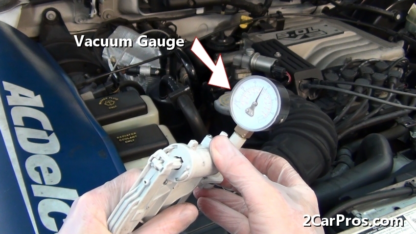

Step 7 - Use a vacuum gauge to test various control tubes which are used to move blend door actuators, also use a hand held vacuum pump to test servo diaphragms by connecting to the vacuum port directly. If no vacuum is present, open the hood and inspect all small vacuum lines from the engine to the firewall and under the dash, this test can be used for the heater control valve as well.
vacuum gauge

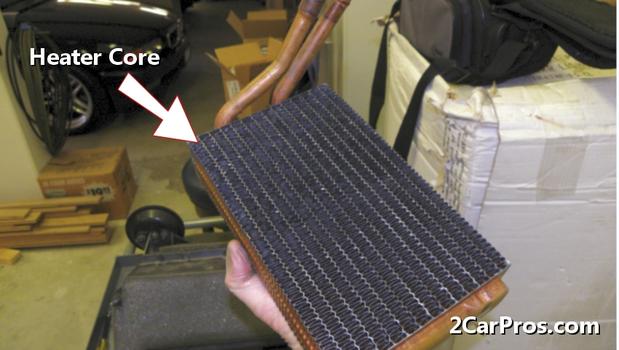

Step 8 - The heater core is responsible for converting hot coolant into heated air, if this core becomes plugged it will not operate correctly. To check for a plugged heater core, start the vehicle and allow the engine to warm up to normal operating temperature while turning the heater to its hottest setting. Grasp both heater hoses, they both should be hot, if only one is hot, the core could be plugged or the heater control valve is malfunctioning.
heater core

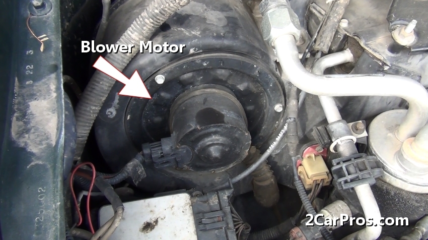

Step 9 - If no air is being produced from the vents while the heater is in operation inspect the blower motor system.
blower motor
