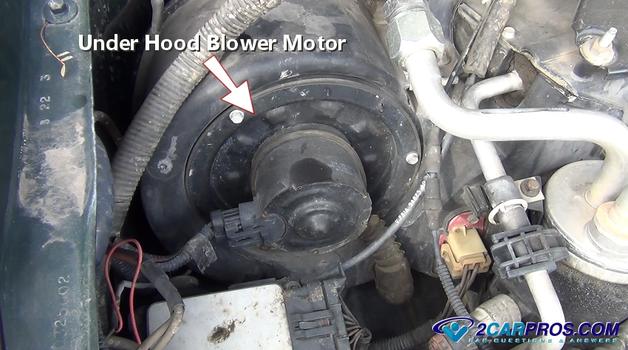

The blower motor can be located in one of two places which is under the dash or hood on the passenger side of the vehicle. There is one blower motor that works for all climate control modes: air conditioner, heater and defroster. Some manufactures make accessing this motor difficult and you will need to remove the complete or a portion of the heater plenum (box) for replacement, this is not common.
Start by checking under the hood and looking around the passenger's side for something that looks like this:

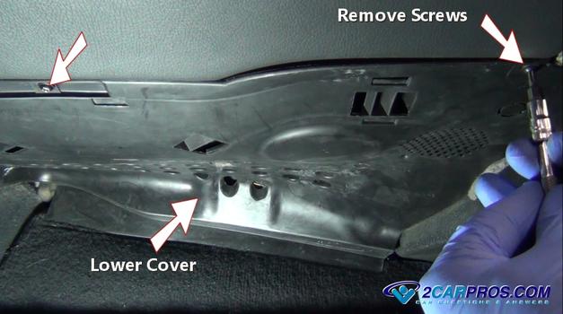

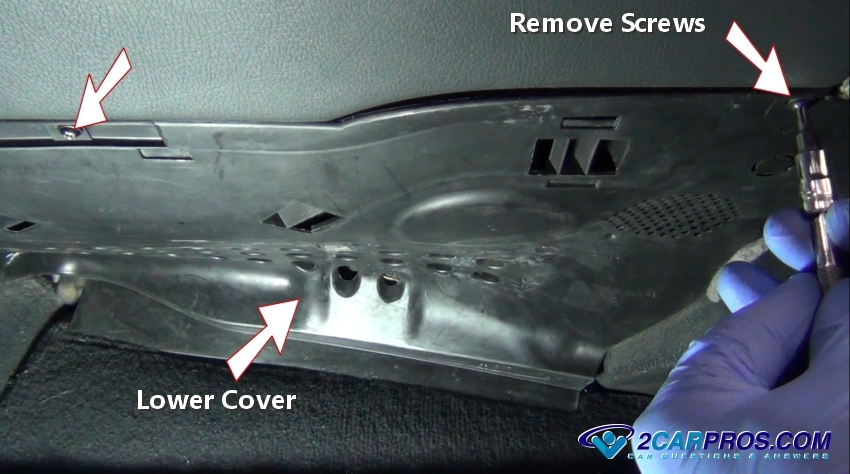

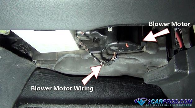

If you cannot find the blower motor under the hood it will be located under the dash on the passenger side. You may need to remove the mounting screws of the lower panel to gain access to the motor for removal.
This heater motor location is under the dash. Let's start the removal which is the same for under hood or dash applications.

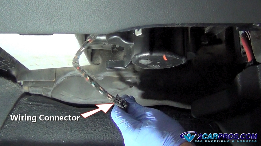

Locate and disconnect the a/c blower motor wiring by releasing the safety tab on the side of the connector. This connector can have one or four wires depending if the system is manually or automatically controlled. These different systems will vary the fan speed by using a solid state speed controller apposed to a basic resistor.

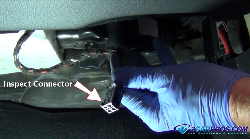

Once the electrical connector is removed check its condition while looking for corrosion or burned terminals which are a sign of high resistance or increased amperage draw. If the connector is melted it must be replaced by splicing in a new part which you can get from the dealer, auto parts store or Amazon. Opposed to a crimp connector, it's best to solider these wires together to cut down on resistance which helps the motor last longer.

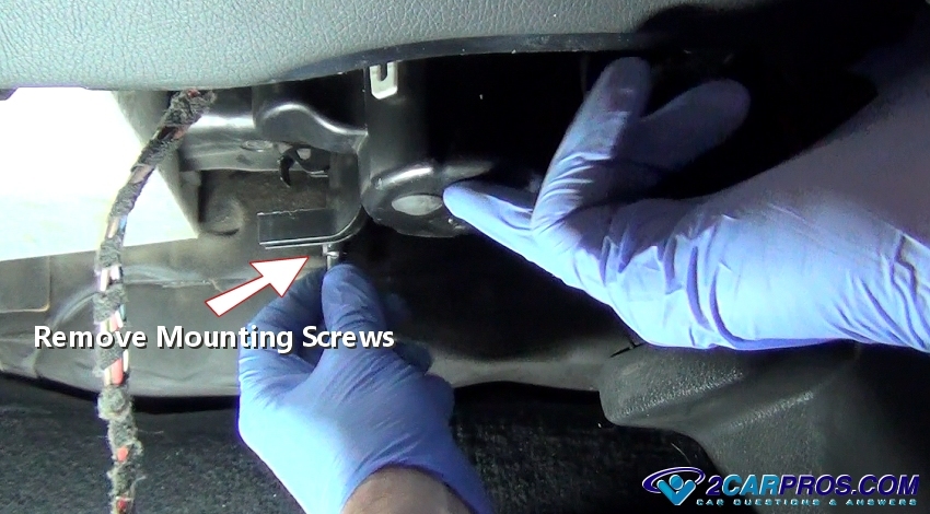

Identify the heater motor and the mounting screws holding it into the heater box. These screws are mounted in the plastic housing and are not to terribly tight so they can be removed easily. Some of these screws can be hidden under metal braces, plastic tabs or wiring so use a small mirror if needed.
Start by removing the mounting screws one at a time. The motor will then start to fall out of the heater box. While holding the blower motor in place remove the last screw.

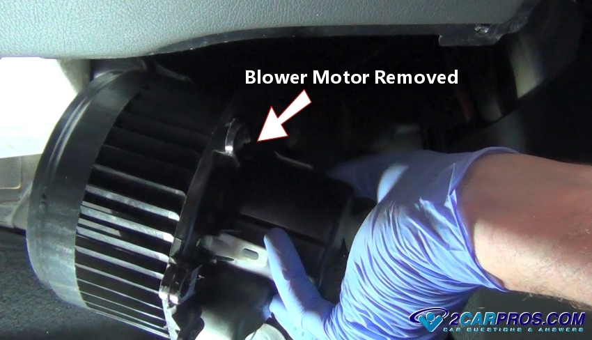

After all of the screws have been undone grasp the motor and remove it from the housing. This can take some maneuvering so hang in there and be careful not to damage the fan blade (squirrel cage) against the heater plenum.

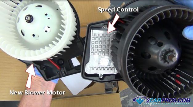

Once the old motor has been removed compare it to the new unit. In some cases an electronic speed controller is used in climate controlled systems and will need to be transferred to the new motor but this is not typical. On some replacement units you will need to transfer the old fan blade over to the new assembly. This is done by removing the mounting nut or clip and then forcing the blade off of the motor shaft using a large standard screwdriver. Do not use oil or lube of any kind to help installation of the fan onto the replacement motor because it will allow the fan to slip on the shaft which will create problems.

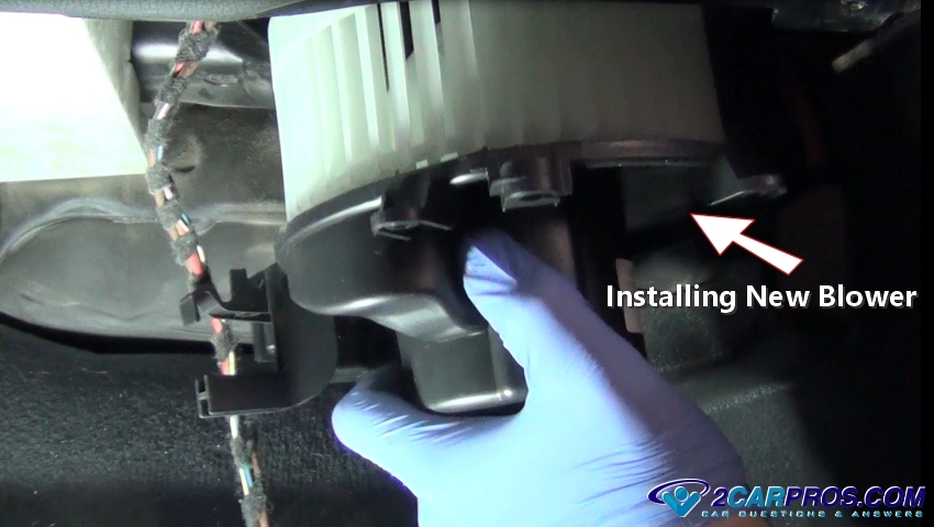

Before installing the new motor into the plenum check for obvious obstructions such as leaves, sticks, ink pens, tooth picks or small toys which can get into the system via the inlet or outlet vents. These foreign partials can keep the motor from working freely and could cause premature failure. When the new assembly is ready to be installed fit the motor by maneuvering and rotating it gently. Then push it back into the plenum while lining up the mounting holes.

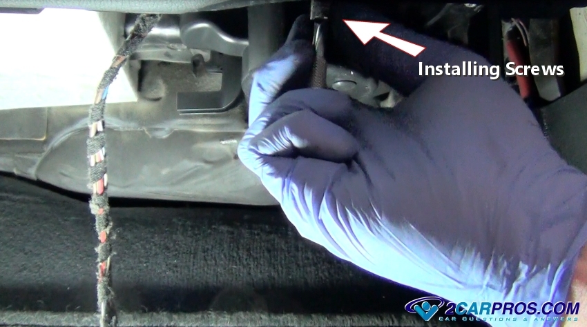

While the motor is in place start to install the mounting screws while holding it toward the plenum. Do not tighten any of the screws until all screws have been threaded in by hand. This will make the installation go mush easier without the potential of stripping the screws out. Tighten each screw in a cross pattern, do not over tighten. This will ensure the proper alignment of the fan blade in the housing. If this step is not done properly it can cause the blade to contact the housing creating a rubbing or clicking noise when the motor is operating.

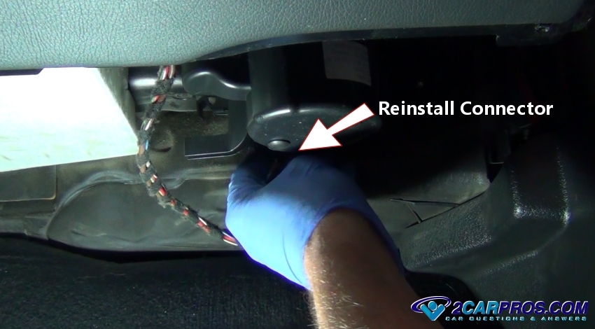

Check the wiring connector locating tang which indicates the orientation of the connector before it's installed into the motor. This tang is to ensure you don't install the connector incorrectly which would cause electrical problems.
Then carefully re-insert the blower fan motor electrical connector by securing it into position. You should hear an audible click telling you the connector is installed correctly. Gently tug on the wiring to ensure its correct installation. Then reinstall the lower dash cover and install the mounting screws by hand. Tighten them snuggly, do not over tighten, again these screws are going into plastic.

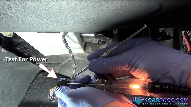

Locate and disconnect the motor wiring connector. Use a test light and a sharp metal object such as a hooked scribe to check for power at the connector (large wires). This test confirms power and the ground of the circuit. If the test light illuminates then power is getting to the blower motor which is telling you the blower motor is bad. This test can also be used by piercing the wires of the wiring harness as well.
If the test light fails to light up the ground or power circuit has shorted and a wiring schematic is needed to troubleshoot the problem further. If the blower motor only has one wire it is used for power. In this case a grounded test light is used for testing.

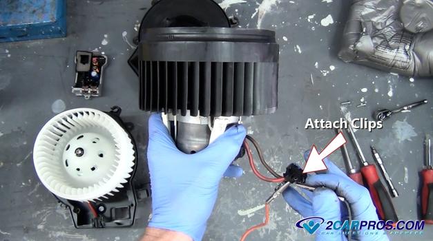

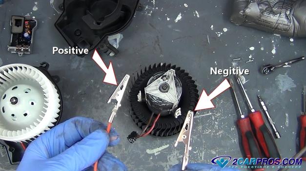

To test the motor prepare a positive power and negative ground lead from a 12 volt power source (car battery). Use caution to not allow the clips to contact each other or sparks and heat will occur.
While grasping the motor firmly attach the power and negative wiring clips to the wiring harness. If the unit only has a power lead attach the ground wire to the frame of the motor.
Once the circuit is completed the motor will or wont spin confirming the motor failure. These units typically fail intermittently. Intermittent power failure from the heater switch, fuse holder or climate control relay could also be a problem so even though the circuit might currently have power.

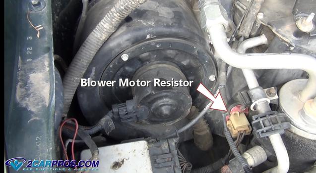

The location of this resistor is usually near the blower motor itself which cools the unit when it's in operation. Both of these parts are located in the heater plenum box either inside the vehicle on the passenger side or under the hood mounted near the firewall on the passenger side.
Use a grounded test light and locate the outgoing wire from the resistor to the blower motor (usually orange or red). While moving the switch to each fan speed test for power. If there is no power on any of the lower speeds the resistor has failed and needs replacement.
