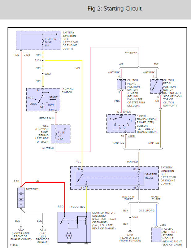

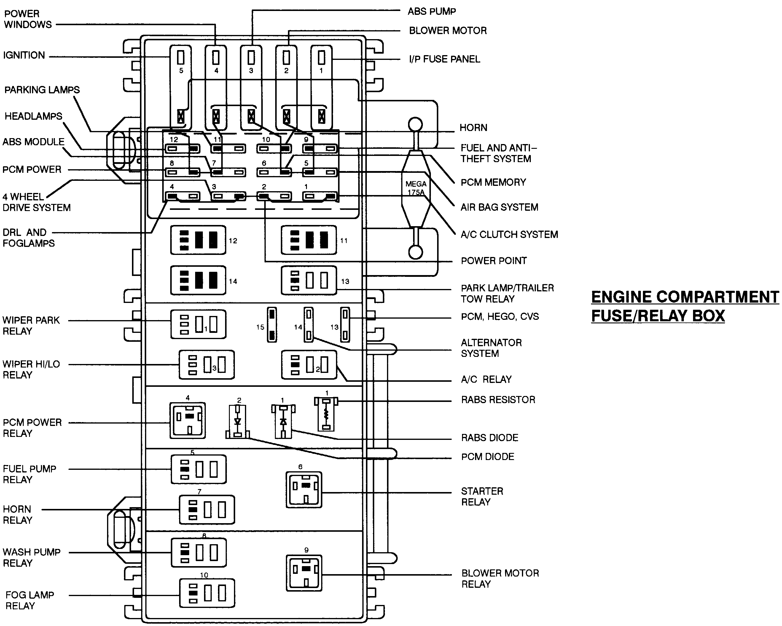

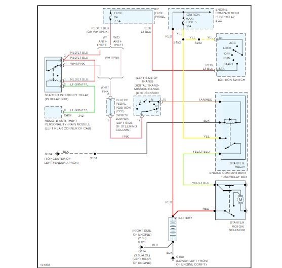

Truck turns over in all power positions. With the clutch depressed, the engine turns over with the ignition in accessories, on as well as the start position. It will not actually start in accessories position but it will in the on position, but the starter is still spinning.
Monday, March 8th, 2021 AT 5:27 PM (Merged)
KEN L
  • MASTER CERTIFIED MECHANIC
  • 42,973 POSTS

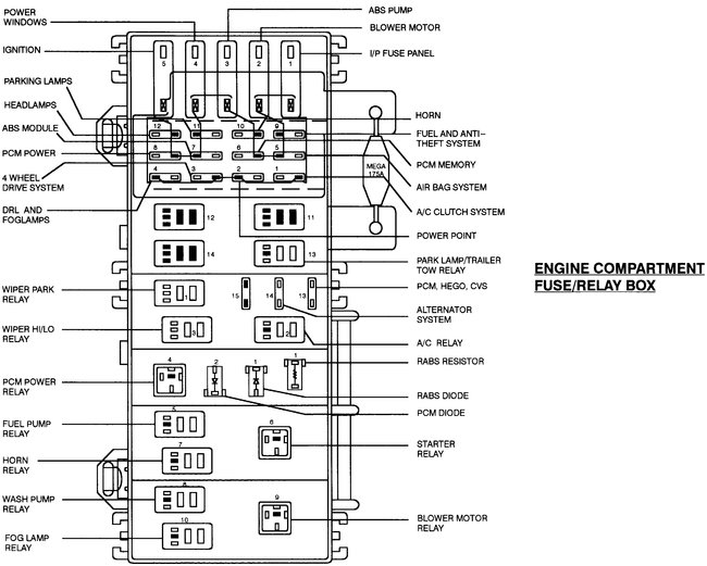

This sounds like you have a starter relay that is stuck. Here is the location of the relay (#6) guide to test it and the wiring diagrams so you can see how it works:

So I replaced my starter it is brand new I know it is not this but when I turn my key all the lights come on on the cluster but when turn the key nothing the truck wont start I had to put a push button on the truck till I can fix it and the push button works every time no problem idk if it is the starter switch or the the key part it self

Unplug the RED LT/BLU wire on the strter solenoid, connect a test light to that wire and try starting the engine with the ignition switch. The testlight should come on (if the ignition switch is working properly).
Secondly, you should quickly jumper the unplugged terminal on the solenoid (the one where the RED LT/BLU wire was connected) with the terminal where the battery cable connects to the solenoid (this simulates turning the ignition switch to the ON position); the starter should operate as long as the jumper is in place.
If the starter works when you lumer it, but not when you turn the key; replace the solenoid.

Started when cold run until I turn it off. When hot won't crank when I try to start until cool again.
Monday, March 8th, 2021 AT 5:31 PM (Merged)
  • 52,797 POSTS
Good morning,
I suggest you load test the battery when it is hot to determine is the battery is the issue. It may be a weak battery.
I also attached a wiring diagram of the starting system. Verify power to the starter solenoid when cranking.

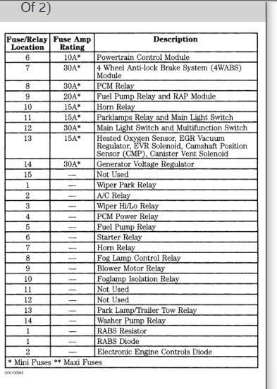

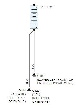

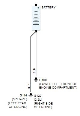

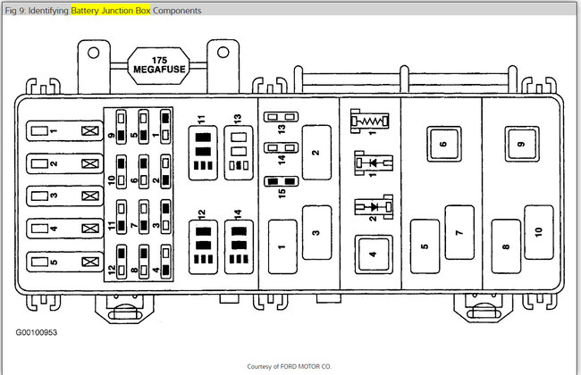

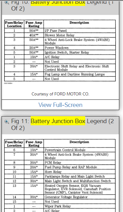

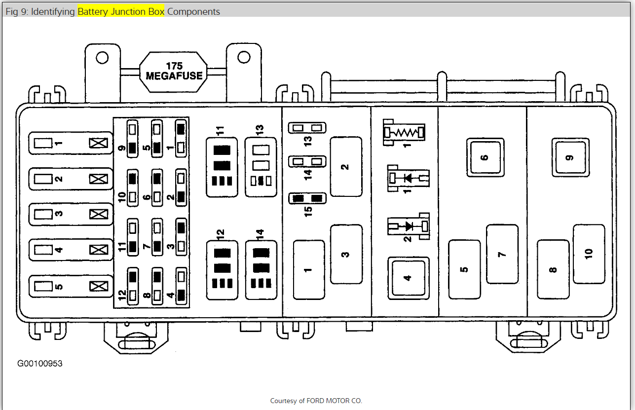

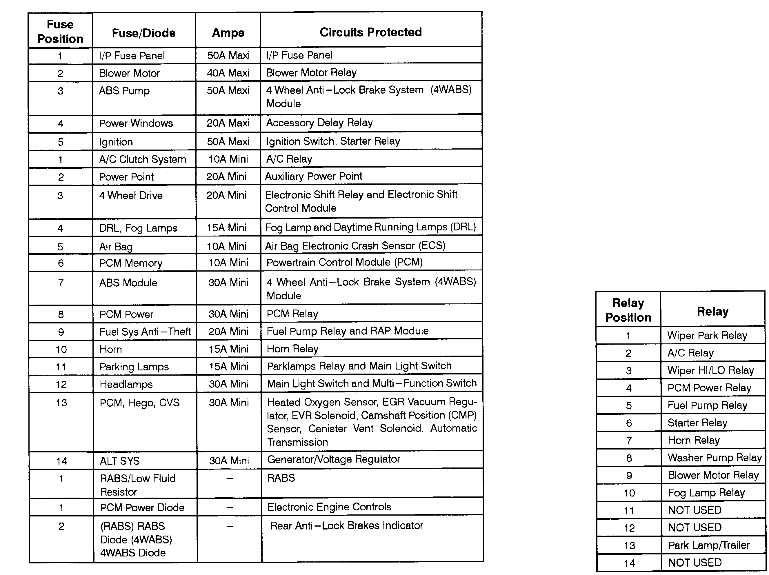

I put in a new flex plate and torque converter and after I did that it wont turn over. No power inside the truck and a good battery.
Monday, March 8th, 2021 AT 5:32 PM (Merged)
  • 108,271 POSTS
Since you did a major repair, I suspect that something was left disconnected. First, since there is now power to the vehicle, my first guess would be the main ground from the battery. Check to make sure you reattached it or if it was damaged.
I attached a portion of the wiring schematic for you to review. It indicates two grounds from battery. First, check the one that is lower left of the engine block.
Next, check the 50 amp maxi fuse (number 5) in the under hood power distribution box. See pictures 2 and 3. This guide can help us fix it
Check out the diagrams (Below). Please let us know what happens. Let me know what you find. Joe

STACY BAKER
Thanks for the tip. It turned out to be the ground wire the small one from the main ground that grounds to the front of the radiator support.
