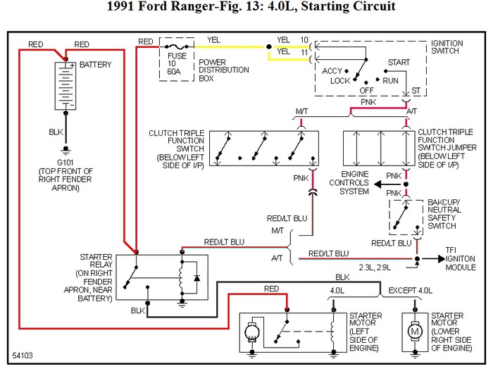

What litre size of engine? Automatic or manual tranny? Could be issue with neutral switch or clutch switch, depending on your tranny? The wiring below is for a 4.0L engine. This guide can help us fix it

It's a manual trans, not sure on litre, I think it's a 4.0L. I've checked the wiring, it all looks good, but still won't start with the switch.

At the starter relay, the red wire with lite blue tracer should be hot with key in the crank position? Is it?If not, need to check voltage to and from clutch switch. Use a voltage tester/testlite.

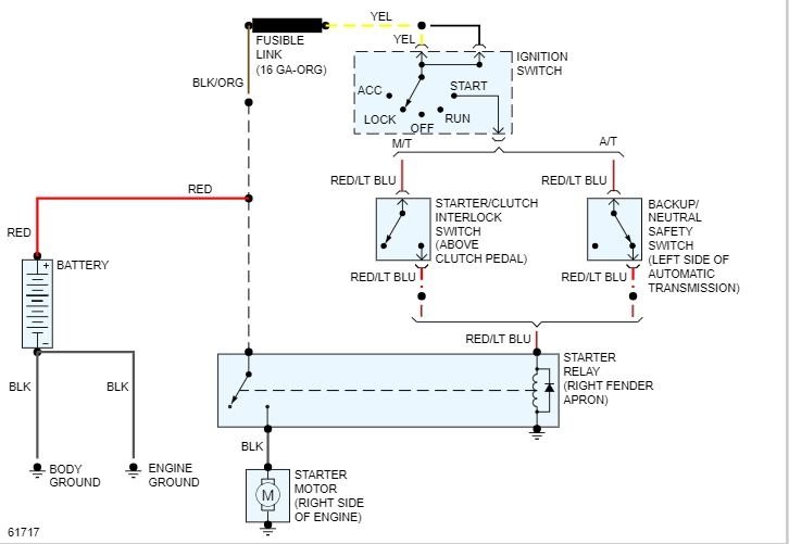

  • CAR REPAIR CONTRIBUTOR
  • 110,190 POSTS
I need you to check a couple things. First, the starter relay needs ground for the system to operate. Check the relay first. Switch it with a different relay with the same part number.
or check this link.
Next, there could be a problem with the neutral safety switch. See if the starter will engage if you put the shifter in neutral. Also, if it does not, put it in park, parking brake on, and slid under the truck to see if the switch is disconnected or damaged. The switch is on the left side of the transmission.
If all of that fails, I want you to try this test:
I attached a schematic of the starter system for you to review. Let me know what you find.
