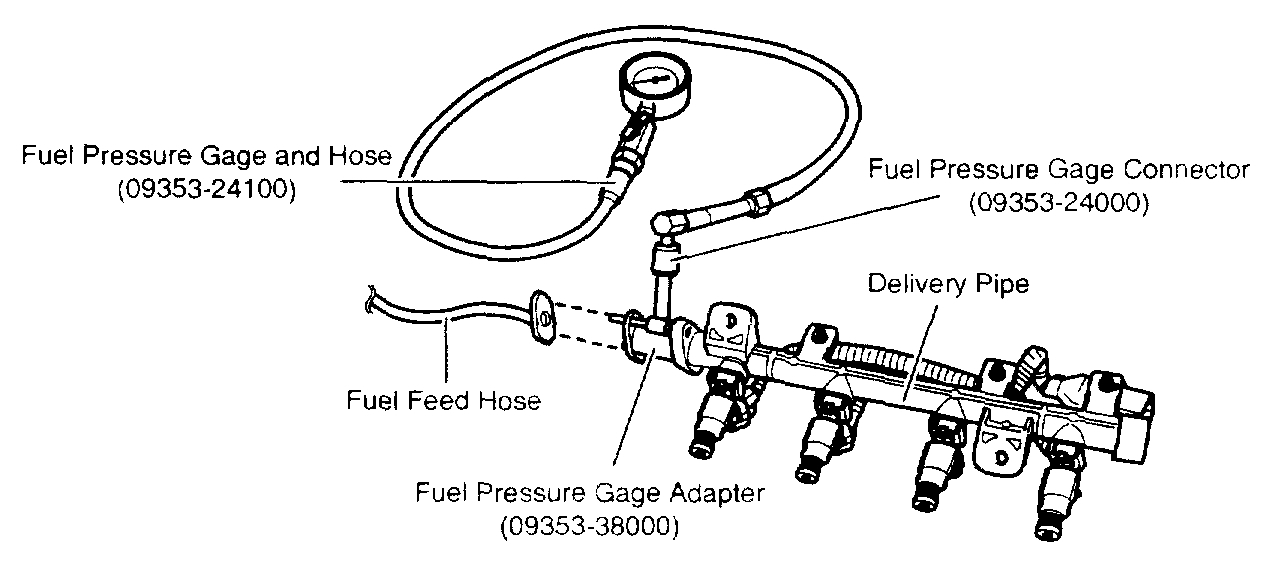

Fuel Pressure Special Service Tool
pic 1
3. INSTALL THE SPECIAL SERVICE TOOL (SST) FOR MEASURING THE FUEL PRESSURE
1. Disconnect the fuel feed hose from the delivery pipe.
Caution: Cover the hose connection with a shop towel to prevent splashing of fuel caused by residual pressure in the fuel line.
2. Install the Fuel Pressure Gage Adapter (09353-38000) between the delivery pipe and the fuel feed hose.
3. Connect the Fuel Pressure Gage Connector (09353-24000) to the Fuel Pressure Gage Adapter (09353-38000).
4. Connect the Fuel Pressure Gage and Hose (09353~41 00) to Fuel Pressure Gage Connector (09353-24000).
5. Connect the fuel feed hose to the Fuel Pressure Gage Adapter (09353-38000).

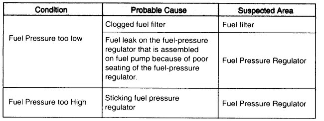

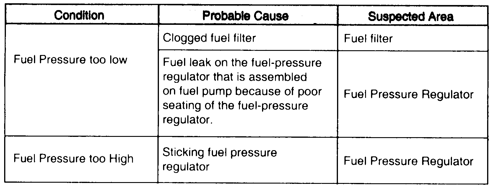

5. FUEL PRESURE TEST
1. Disconnect the negative (-) terminal from the battery.
2. Connect the fuel pump connector.
3. Connect the battery negative (-) terminal.
4. Start the engine and measure the fuel pressure at idle.
Standard Value: 343 Kpa (3.5 kgf/cm cm, 49.8 psi)
Incorrect Pressure
pic 2
If the measured fuel pressure differs from the standard value, perform the necessary repairs using the table below.

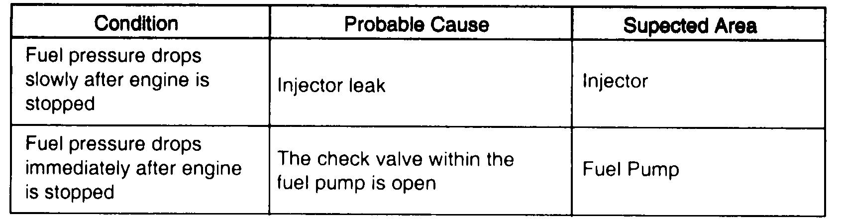

Pressure Drops
pic 3
5. Stop the engine and check for a change in the fuel pressure gauge reading.
After engine stops, the gage reading should hold for about 5 minutes
Observing the declination of the fuel pressure when the gage reading drops and perform the necessary repairs using the table below.

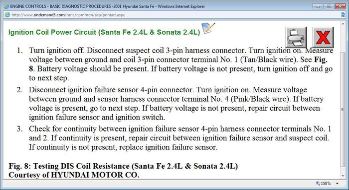

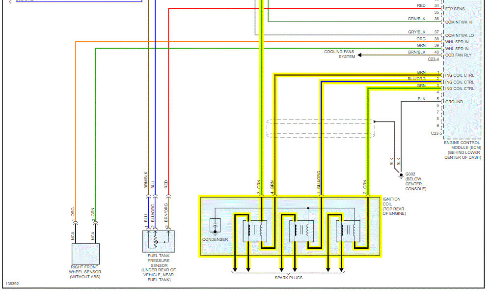

TO2LEGAL1
  • 8 POSTS
replaced plugs and wires now has crank and no start
Jan 2, 2021 at 9:15 AM (Merged)
SATURNTECH9
  • CAR REPAIR CONTRIBUTOR
  • 30,869 POSTS
If changing the plugs and wires caused a crank no start maybe you crossed some of the spark plug wires to the wrong place?
TO2LEGAL1
  • 8 POSTS
only has the 2 plug wires that run to 2 single coils
SATURNTECH9
  • 30,869 POSTS
Alright let me get this stright the engine started and ran good aside from the cyl 1 miss fire before you changed the plugs and wires?Then from the moment you changed the plugs and wires you now have a crank no start?
TO2LEGAL1
  • 8 POSTS
yes. it did run rough but now cranks over but no start
TO2LEGAL1
  • 8 POSTS
ran rough
SATURNTECH9
  • 30,869 POSTS
Have you checked to make sure you have a nice blue spark on each cylinder?Also inspected the spark plugs to make sure the gaps arent closed up completly?Does it even try to start?
TO2LEGAL1
  • 8 POSTS
pulled no.1 plug see no spark when cranking over
SATURNTECH9
  • 30,869 POSTS
Have you checked all the fuses?Any new codes?
TO2LEGAL1
  • 8 POSTS
checked all fuses, no new codes. i replaced both coils and still nothing

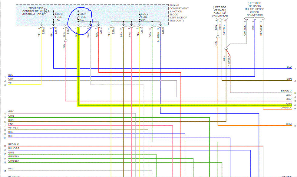

CA7922303
  • 165 POSTS
New fuel pump, all sensors have been replaced. Crank sensor has an ohms reading, cam sensor does not. Fuse block ECU fuses show 12 volts. Fuel pump check shows 12 volts. Key in start position with good pump relay fuel line disconnected at pump, does not pump fuel. Jump pump relay fuel pump operates. pulled #2 spark plug cranked with plug connected to wire, could not see any spark.
SATURNTECH9
  • 30,869 POSTS
Did you check for power to the ignition coils?

TO2LEGAL1
  • 8 POSTS
i do not have any power to either coil when cranking over
Jan 2, 2021 at 9:16 AM (Merged)
CA7922303
  • 165 POSTS
Fuel does pump with key on, there is uniform compression, there is no spark. Unable to see spark with plug installed in wire and unable to feel spark with screwdriver in wire and touching screwdriver.
No, it should be battery voltage. 12.2 volts or more.
No tachometer signal could be the crank sensor.

Crank sensor shows an ohms reading. Should it have no reading if bad?

What would be the correct way to test the voltage at coil pack? Maybe I'm not doing something right?
I attached a diagram of the coil for you.
The green is powered by a fuse I circled in one of the diagrams.
Check for power and let me know.
