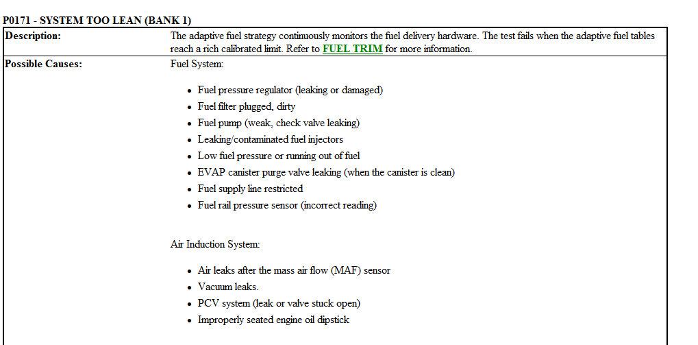

The code with an scanner is P0171 but it has several causes. I replaced the Mass Air Flow sensor, the Oxygen sensor, the gas filter and the Idle Air Control valve, but the problem did not decrease. The mechanic told that another cause could be the intake manifold (Or maybe the gasket at the intake). What's your opinion?

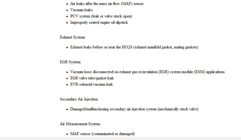

Refer to diagnostic procedure as described (check table below) fault code p0171 related to system too lean, it means too much air entering the system or not enough fuel quantity and pressure. you already changed the fuel pressure, and mass air flow.
Check for vacuum leaks as described the link below.

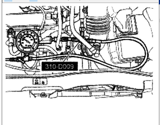

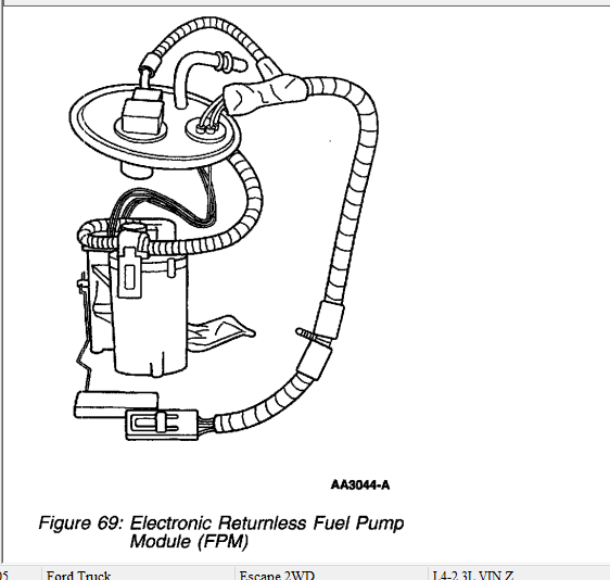

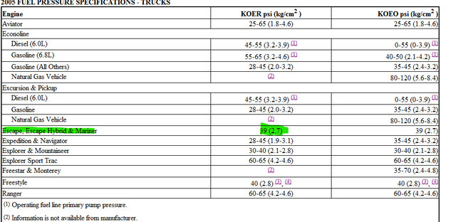

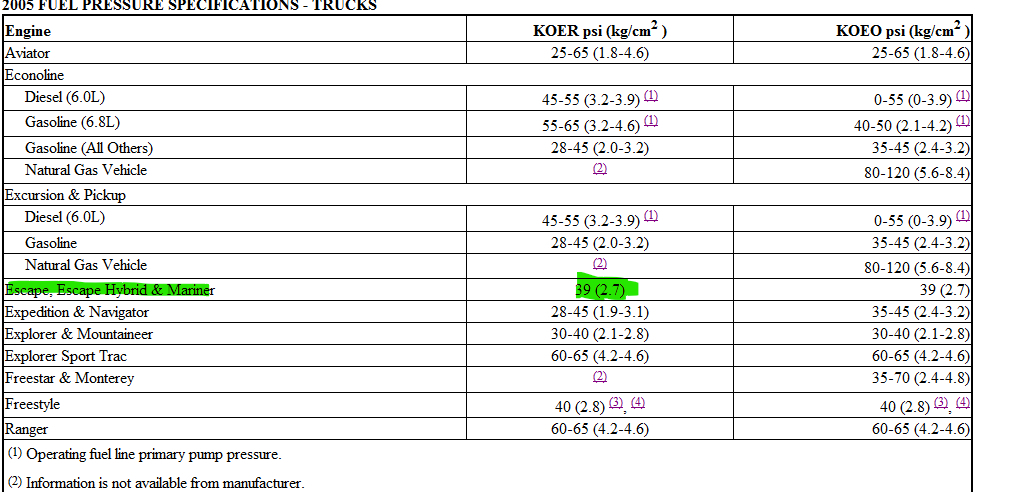

If no leak found check the fuel pressure you must read about 39 PSI (check the table below).
https://www.2carpros.com/articles/how-to-replace-an-electric-fuel-pump
If the pump pressure within specification and no vacuum leak check for exhaust leak and the EGR. check the link below.
