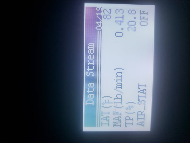

EWC177
  • 144 POSTS

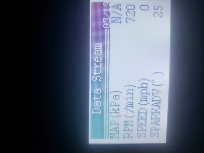

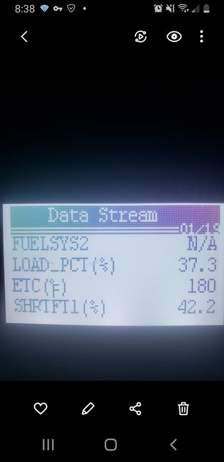

Here are the 6 stream data readings it was giving me.
Tuesday, June 2nd, 2020 AT 6:36 PM
EWC177
  • 144 POSTS

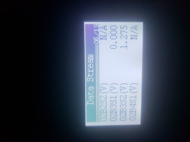

2 more.
Tuesday, June 2nd, 2020 AT 6:37 PM
EWC177
  • 144 POSTS

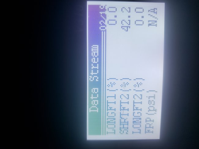

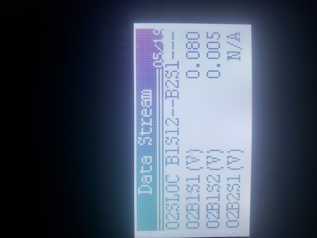

Last 2.
Tuesday, June 2nd, 2020 AT 6:38 PM
  • 52,797 POSTS
Nuts. It does not give the trims and the mass air flow sensor readings.
The O2 sensor readings are full lean.
That tells me there is a lack of fuel.
Tuesday, June 2nd, 2020 AT 6:44 PM
