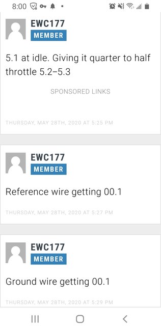

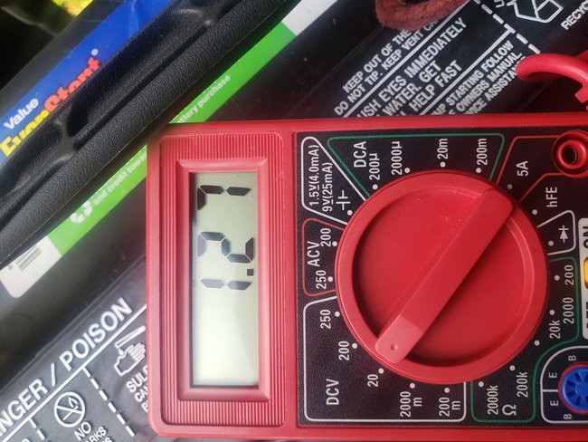

The gray/white wire is the one that needs the varying voltage. If it is constant then the TPS is no good.
Check for voltage on that wire with the connector off the TPS as well with the key on.

But the gray/white was the one staying in the 5 volt range. Tried with multi-meter set on 10 and 20. To see if any change. Wasn't any.
Friday, May 29th, 2020 AT 6:17 AM
  • 52,797 POSTS
Then it needs a TPS sensor.

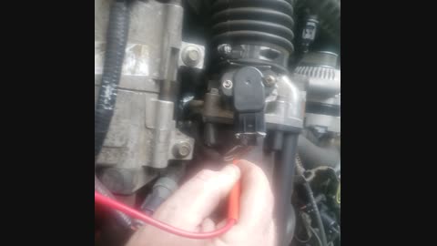

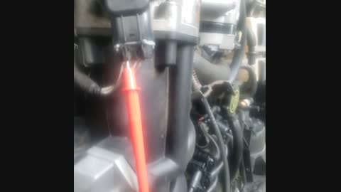

Okay, how you test it is to turn it off. Then turn the key on, back probe the signal wire and check the volts at idle and open to wide open and watch the voltage change.
The videos were not good. 3/4 of them were cut off.
Monday, June 1st, 2020 AT 4:57 PM
EWC177
  • 144 POSTS
Once you pass 1/3 idle the engine starts to rock back and forth. When I first tested it. It was a little over 5 volts at idle. But when you start to accelerate it still doesn't drop voltage.
Monday, June 1st, 2020 AT 6:09 PM
  • 52,797 POSTS
You are not listening to me.
I said turn off the engine. This test is not done with it running. Just turn the key to the on position and test the voltage by moving the throttle on the throttle body. Again, the engine is not running.

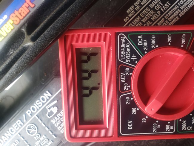

Switch on dark gray and white wire. Only changes to 5.11 at full throttle.
Tuesday, June 2nd, 2020 AT 4:41 PM
EWC177
  • 144 POSTS

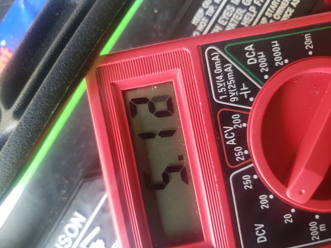

Light gray wire with white stripe in center of plug. 1.21 switch on.4.44 fully depressed throttle.
Tuesday, June 2nd, 2020 AT 4:43 PM
EWC177
  • 144 POSTS
0.03 on the ground wire.
Tuesday, June 2nd, 2020 AT 4:46 PM
  • 52,797 POSTS
Okay, i.21 is too high. It should be.5 to.75 and 4.8 at wide-open throttle.
Can you adjust the sensor? Does it have slots on the sensor at the screws for adjustment?
