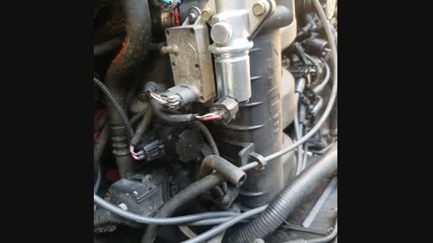

It should idle with the IAC disconnected. It will be a low idle but still idle on its own.
Then when you plug the IAC back in, the idle should come up.
Monday, May 25th, 2020 AT 5:46 AM
EWC177
  • 144 POSTS
Unplugged the IAC and it shuts off.

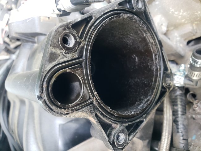

Okay, clean the throttle body real well.

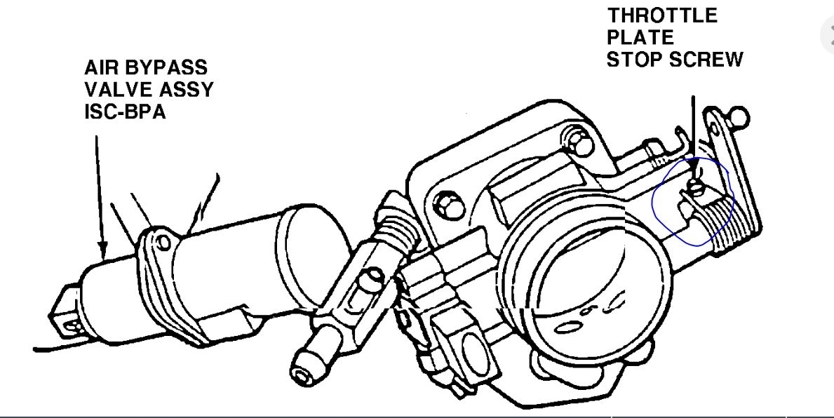

Then adjust the base idle so it will idle on its own. There should be a base adjustment screw on the throttle body.
1. Disconnect idle speed control-air bypass solenoid.
2. With transmission in Neutral or Park, run engine at 2500 rpm/30 seconds.
3. Place automatic transmission in Park, manual transmission in Neutral.
4. Check/adjust idle rpm:
Turn the throttle plate stop screw to 725 rpm
5. Shut engine off and repeat Steps 2, 3 and 4.
6. Shut engine off and disconnect battery for a minimum of 5 minutes.
7. Engine off reconnect idle speed control-air bypass solenoid, verify the throttle is not stuck in the bore and linkage not preventing throttle from closing.
8. Start engine and stabilize for 2 minutes then goose engine and let it return to idle, lightly depress and release the accelerator. Let engine idle, if problem exists, refer to computer engine controls/diagnostic routines for other possible causes.

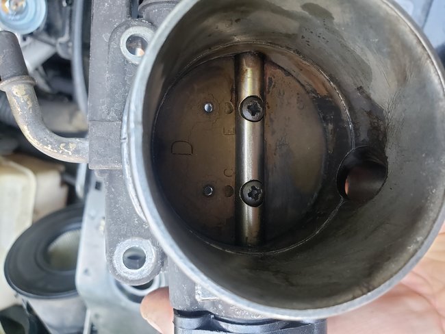

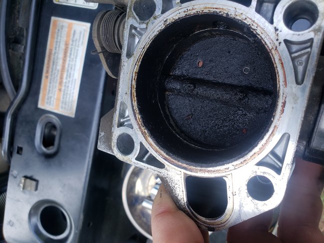

Need something stronger than throttle cleaner. The stuff inside is cooked on. Red can is what I've been using.
Monday, May 25th, 2020 AT 6:52 AM
  • 52,797 POSTS
That stuff does not do squat.
Go to the parts store and get a can of 2+2 carburetor cleaner and a small brush.
That stuff works great.
Monday, May 25th, 2020 AT 6:54 AM
EWC177
  • 144 POSTS
Was originally thinking, remove sensor and soak in gas and use toothbrush.
Monday, May 25th, 2020 AT 7:07 AM
  • 52,797 POSTS
Carburetor cleaner would better but give it a try. Carburetor cleaner is more aggressive and melts away all that carbon.
