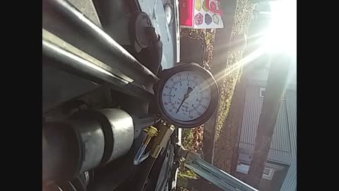

I bought a fuel pressure tester. While key on it is 50 then when the pump stops it drops to 42 in video, holds 42 for 5 minutes but no start today. Or the whole problem could be the catalytic convertor, lol.
Monday, December 7th, 2020 AT 1:21 PM
  • 52,797 POSTS
Okay, fuel pressure is good.
Pressure
48 - 55 psi
Unbolt the head pipe from the exhaust manifold and see if it starts easily. If it is a clogged catalytic converter, it will start right up.

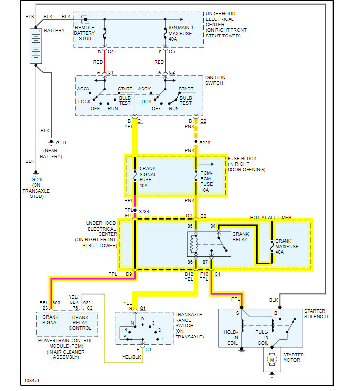

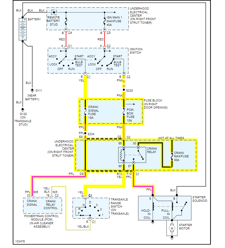

Okay, I attached the wiring diagram for the starting system.
We need to do some testing at the crank relay with a voltmeter.
Let me know when you are ready.

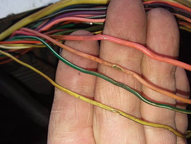

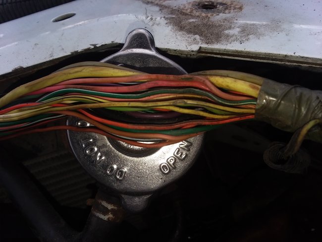

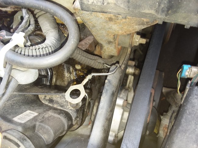

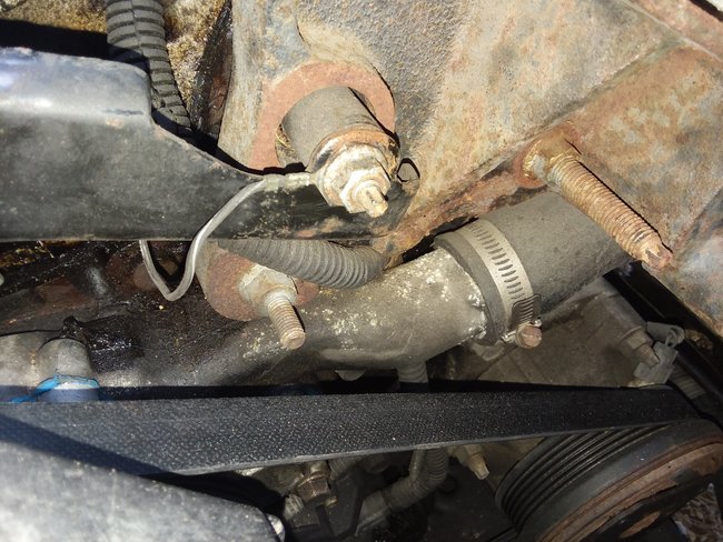

Continued tracing the wire harness and found 7 total grounds and one that I think is a ground and was unattached tucked under the water pump bracket. Pic 1. Negative battery terminal bolt had rust on the threads. After reading another post here about the harness that goes under the battery, I took that apart and it looked good until I got to where it sneaks around the back side of the radiator fill neck. 4 cut wires from the rad cap. I plan on cutting out and soldering new wire. I will also dig up a wiring diagram to make sure that disconnected wire was a ground before reconnecting the battery. As an extra added bonus, since the inspection expired they would not let me renew the registration.
Tuesday, January 26th, 2021 AT 9:29 AM
  • 52,797 POSTS
Where did the cut wires end up?
Can you post the picture of the cut wires?

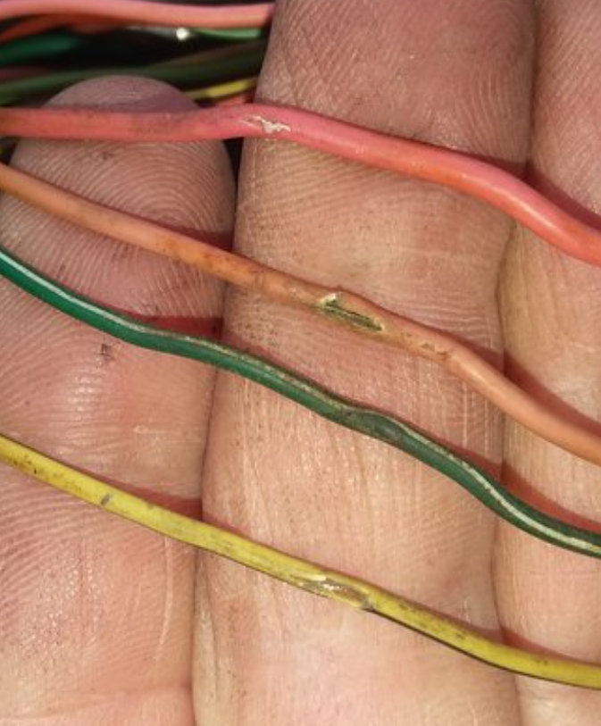

The insulation was cut by the radiator cap. (Click the pics to enlarge) Possibly making an electrical connection with the cap. The harness tucks between the radiator and radiator support. Wrapped with dry rotted electrical tape (no wire loom).
Tuesday, January 26th, 2021 AT 11:09 AM
  • 52,797 POSTS
I would cut out the corroded wires and replace them with new wires. Solder and shrink wrap the connections.

The wire shown here is a ground? I found it tucked under the bracket not attached to anything. Black with white stripe. It comes out of the harness with fuel injectors. When I dig through my nuts i'll relocate it to a stud.
Wednesday, January 27th, 2021 AT 8:11 AM
  • 52,797 POSTS
Correct. It is a ground.
