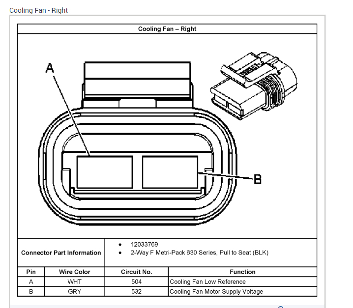

  • 157,000 MILES

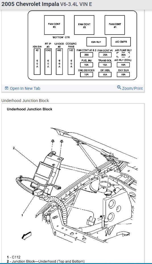

I bought this car used this past december so im unfamiliar with the history. The car seems to be blowing cold air and overheating but once in a while it will blow hot air and then the temperature returns to normal. I topped up the fluid in both rad and reservoir and tested it a few times raising the temp and letting it cool down.I thought it had fixed the problem but when I took it out for a drive it overheated again after a bit and never recovered. Could this hopefully be just the thermostat? Or something more serious?

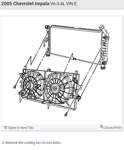

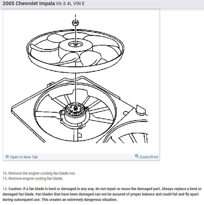

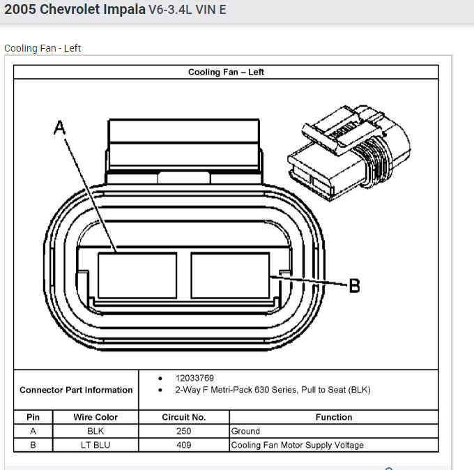

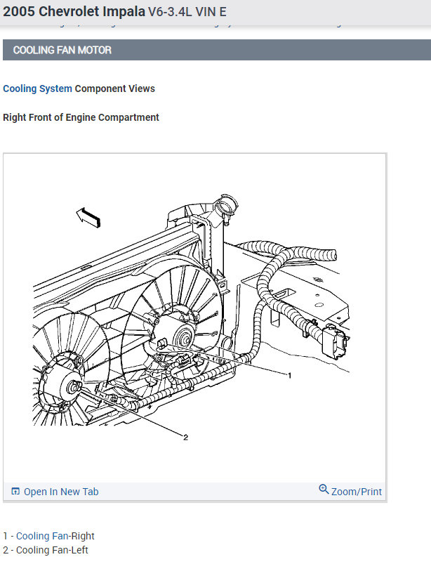

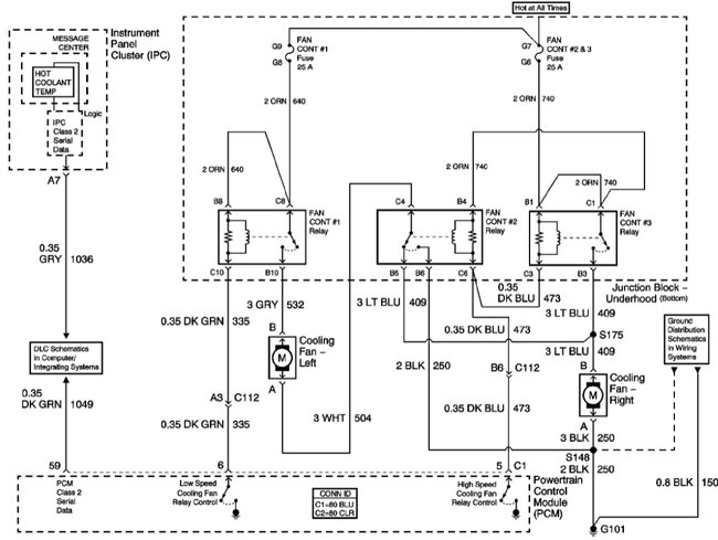

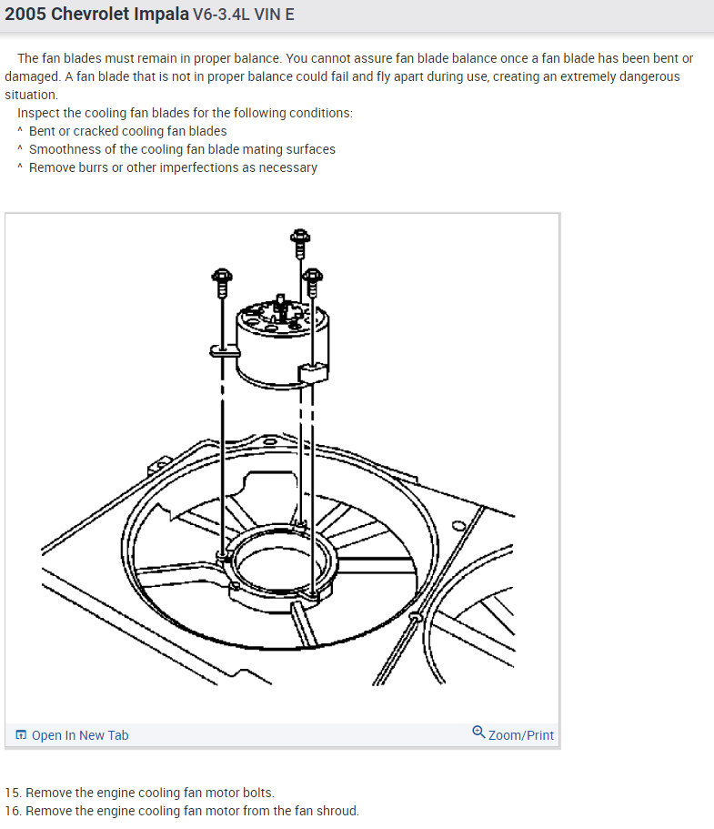

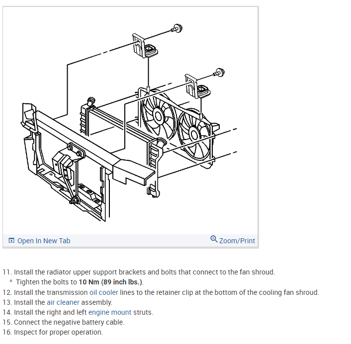

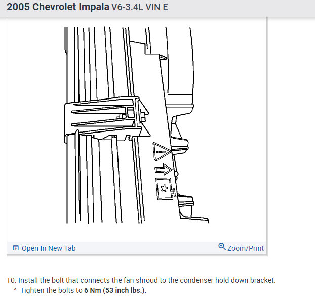

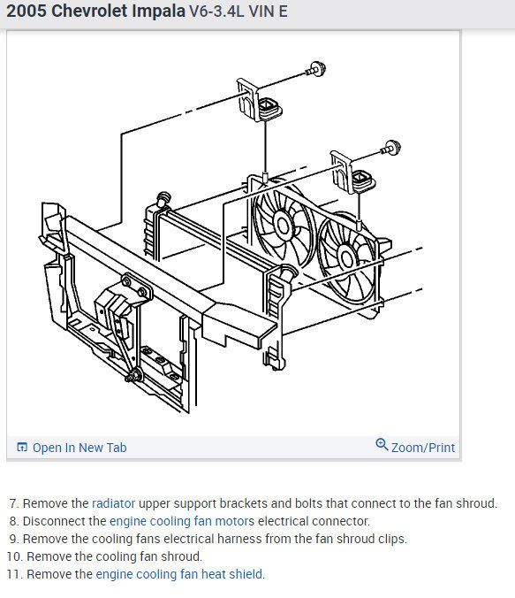

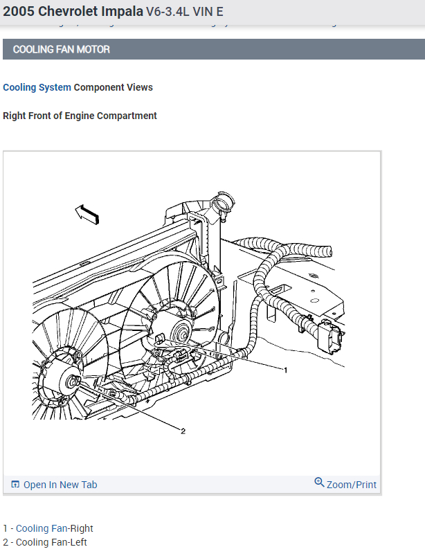

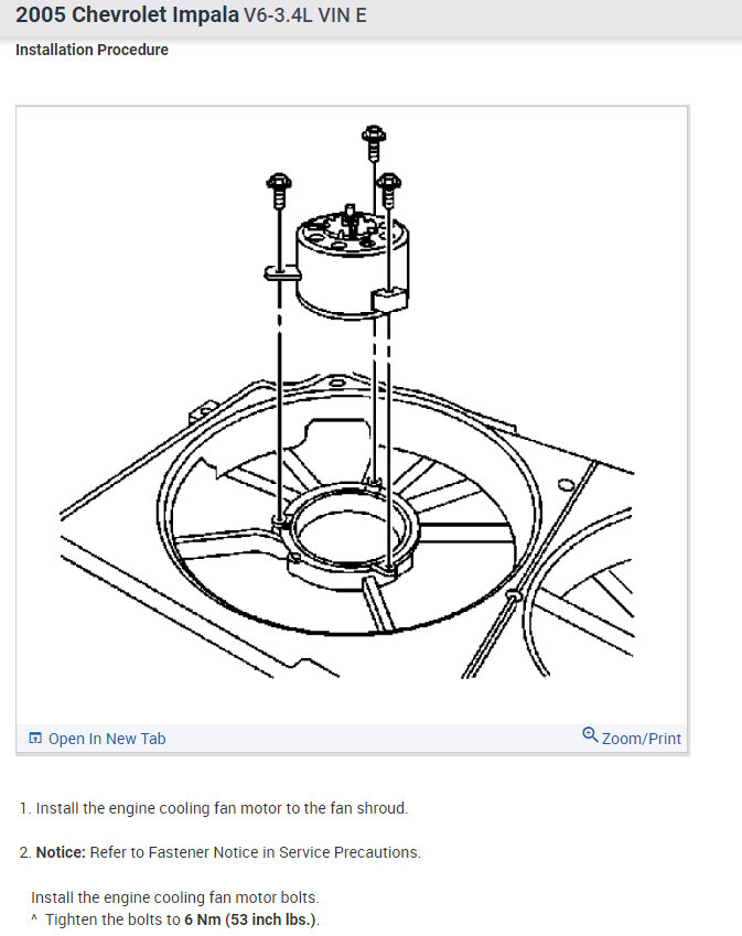

You could also have a issue with the cooling fan. Check to see if the fans come on.
A non functional fan can be the cause of a faulty motor or relay. The relay is located in the junction box under the hood (see below for diagram).
The relay can be tested.
You might find these articles helpful:
https://www.2carpros.com/articles/how-an-electric-cooling-fan-works
https://www.2carpros.com/articles/replace-electric-fan-motor

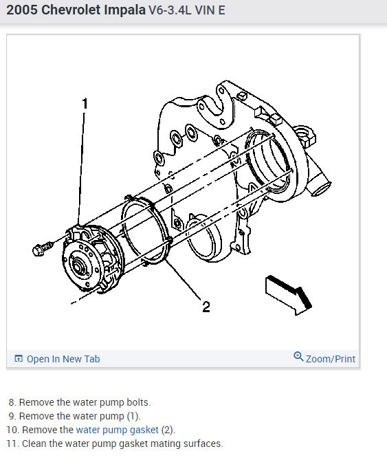

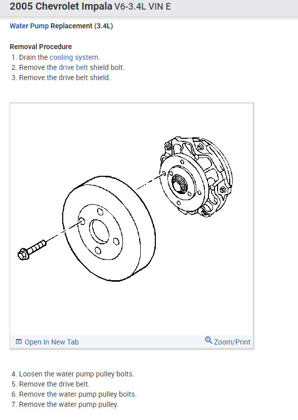

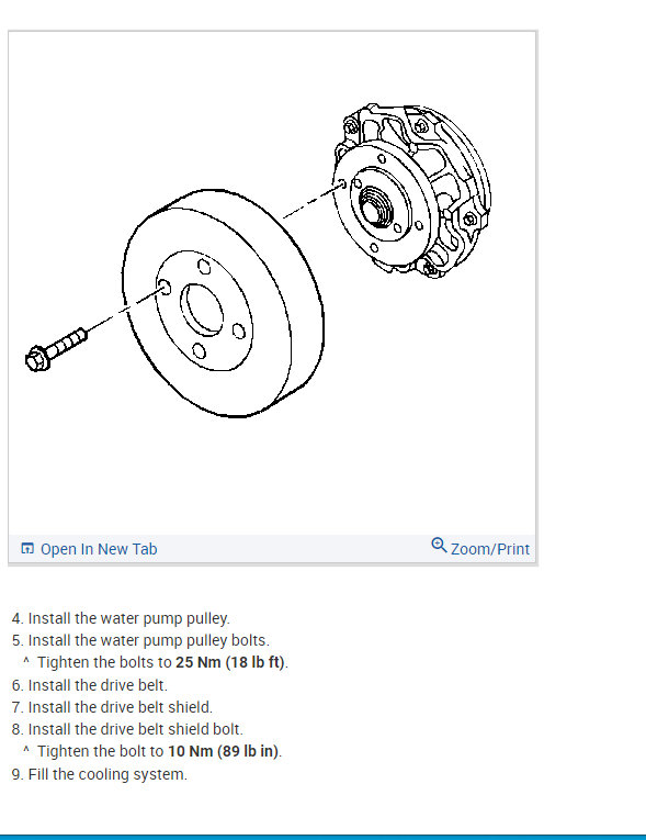

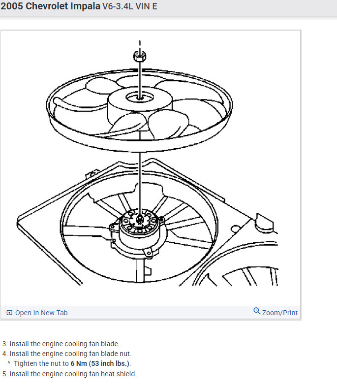

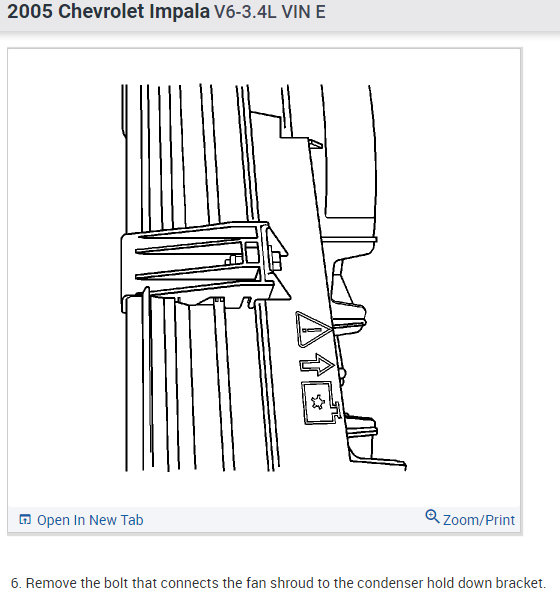

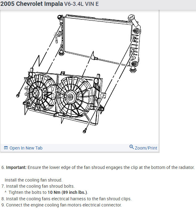

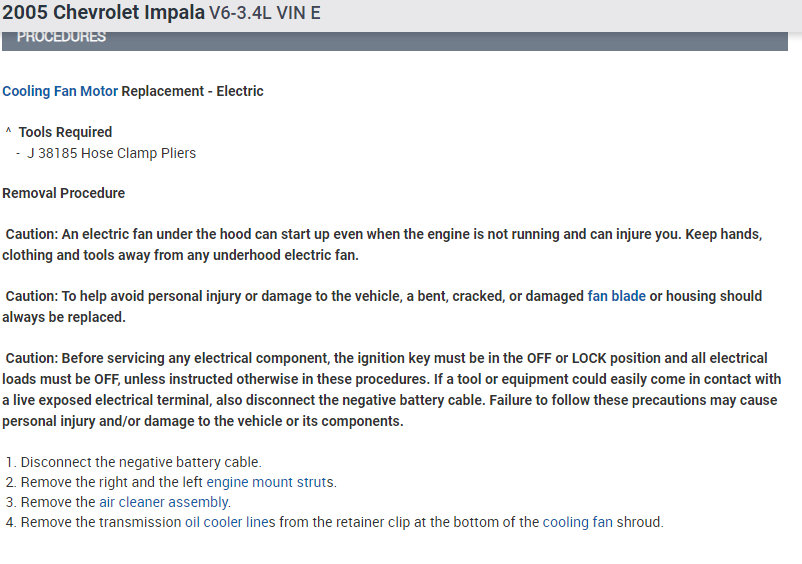

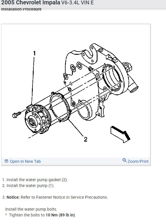

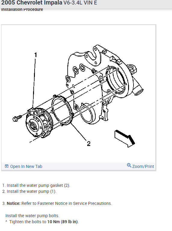

Another possibility is a faulty water pump. If the water pump does not cycle coolant thru the engine it will overheat as well.
I have attached the fan and water pump replacement diagrams for your reference.
