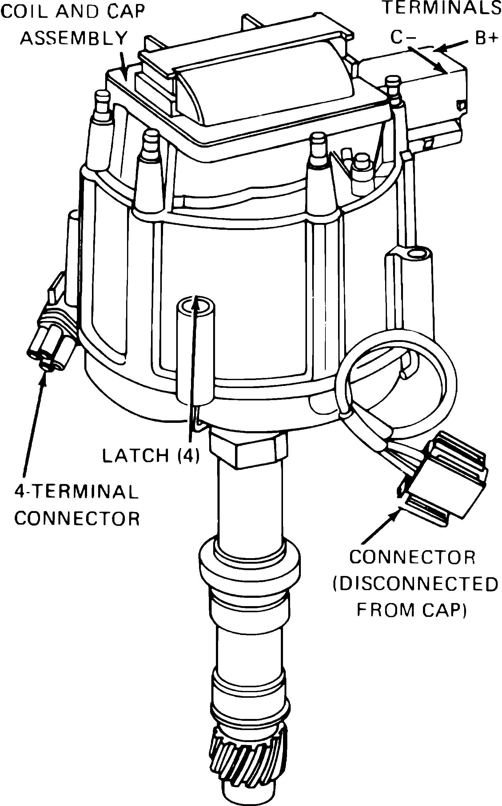

I also need to know if you have an internal coil (in distributor cap) or a remote coil. I assume, based on your description, it has multi port fuel injection.

How can I find out what coil It has? (I apologize if that’s a silly question I’m still learning about this vehicle.)
Thursday, March 5th, 2020 AT 7:50 PM
  • 110,194 POSTS
On the top of a distributor cap that has HEI, it will have a square bulge which is the coil under the cap. If you have a remote coil, the top of the distributor cap will have one wire (spark plug wire) that will be centered on the cap and it will run to a coil.

I found a pic of the HEI with spark control distributor for you to see. Let me know if this is what you have.
