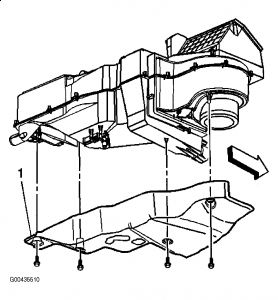

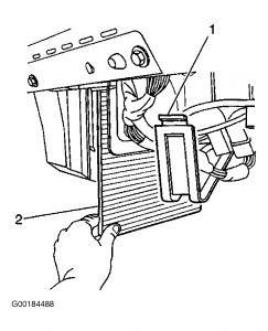

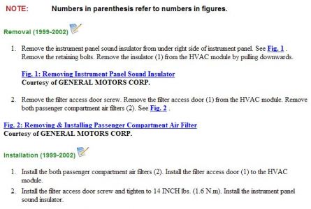

AC is blowing out pieces of filter. Where is the filter located?

https://www.2carpros.com/forum/automotive_pictures/261618_Noname_730.jpg
https://www.2carpros.com/forum/automotive_pictures/261618_Graphic_93.jpg
https://www.2carpros.com/forum/automotive_pictures/261618_Graphic2_10.jpg
