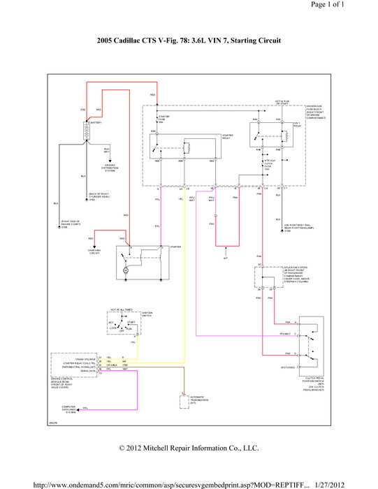

Our reference doesn't show a 3.2-liter for a 2005 Cadillac CTS. The options for a V-6 engine are 2.8-liter and 3.6-liter.
Here is the starting schematic for the 3.6-liter.

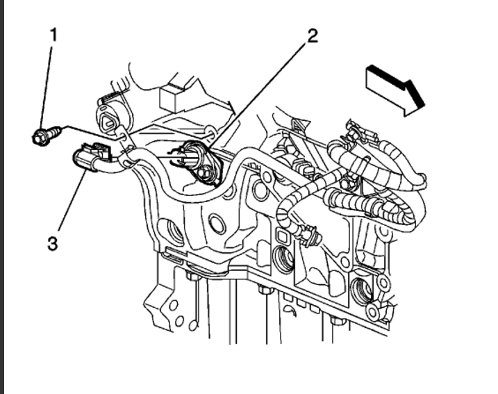

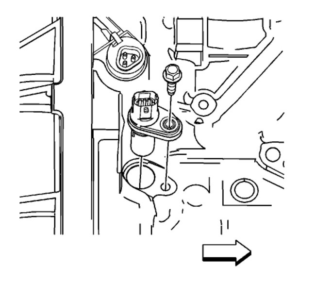

If you are 100% sure it is correct, my guess is either bad computer or bad crankshaft sensor. Here are some diagrams to help you get the problem fixed. (Below)

I was using a Chilton book and all data as references for diagrams. I am pretty sure at this point that timing is correct. I will try the crankshaft sensor, I guess its the only thing left that's easy.
Monday, April 29th, 2019 AT 6:00 PM (Merged)
  • 110,192 POSTS
I have to be honest, I would think it would be the problem becasue the spark comes and goes like the sensor is having a hard time.
ABREWER00
  • 10 POSTS
I have GREAT NEWS! The sensor fixed it, I cant believe it after everything I have been through. :) I love this site
