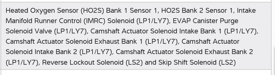

Changed the ignition coils and
the battery went dead and now its a no start. Keeps blowing the cam/pre02 fuse.
Do you
have the same problem?

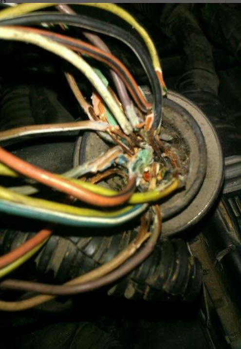

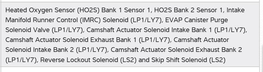

Because it controls all of the items in pic see if you can get a scanner to give a code. It may be a problem at trans connector like pic.

No luck and the trans connectors look good
