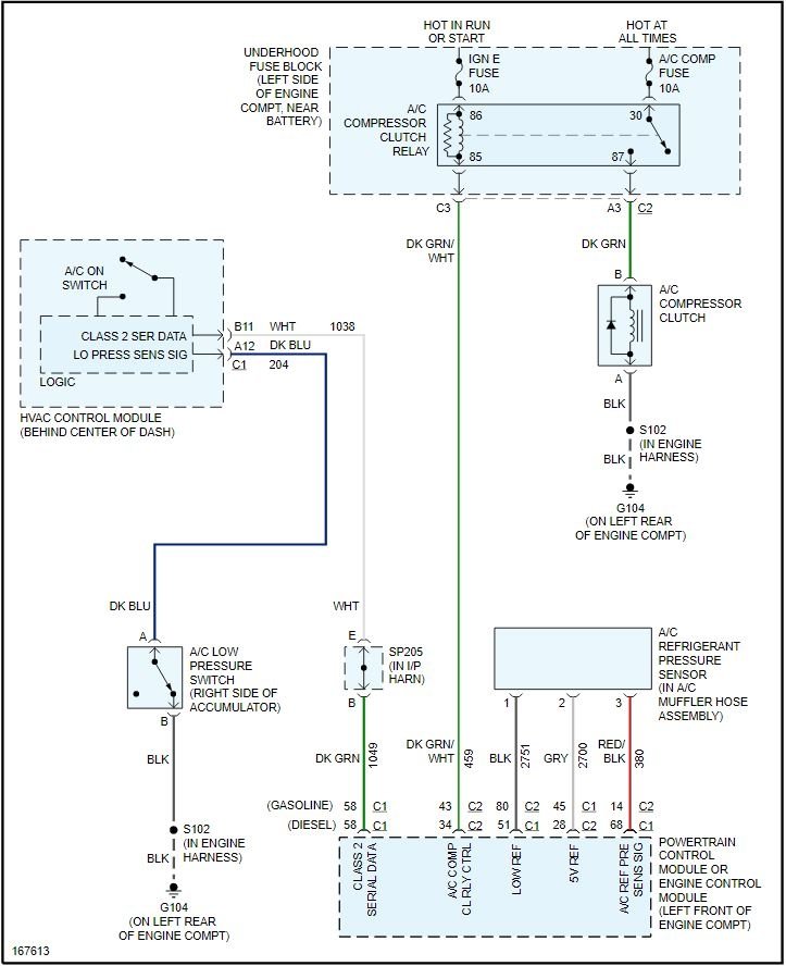

I just bought a 1998 Silverado 2500 and the AC is not working. Fuses and relay tested to be fine. When I jump pins 30 & 87 the compressor engages. There was 0 pressure on the low port, so I added 2 cans and got it to 20 psi (still low, I know, but I only had 2 cans nearby). It's still not working without jumping. High & Low pressure switches both light a test light but voltage on each will hit 11.3 and then drop to nothing (but still enough to light the LED test light) (using a snap on test light with built in voltmeter).
Maybe it still needs more refrigerant to trigger the switches? Or is there a bigger problem with those switches not seeing voltage?

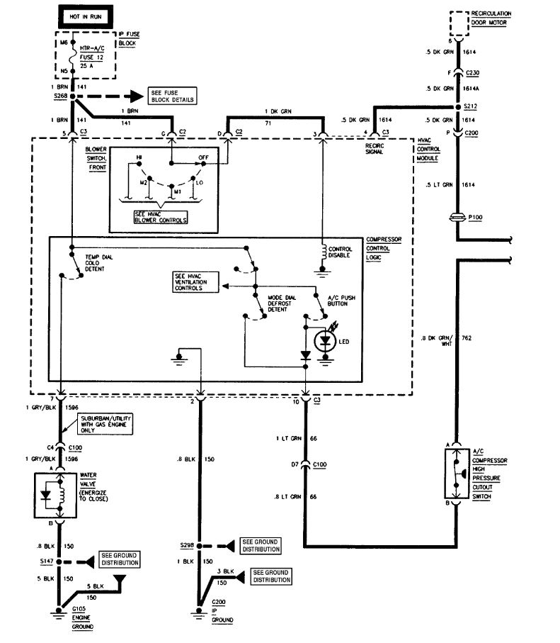

Update: I got another can of 134a with dye. It is now at 40 PSI. The Schrader valve is leaking slightly still with the cap off, but seems to be holding pressure with the cap on and held 20 PSI for 2 days. Now that it is at 40 PSI it still doesn't engage the compressor with the real back in. It's blowing cold when jumped though. I re-tested both the high and low pressure switches and no voltage on either. With the system running and with or without the relay jumped. I am guessing this is pointing towards electronic at this point?
Where do I start testing that? I have found some schematics on this site, but am not sure where these controllers reside. Thanks!

Those switches are a pull to ground system so one side should be ground and the other side should have battery voltage. However that voltage comes out of the PCM after being turned on by the control module. To test the switches all you need to do is jumper them. The high switch is supposed to open at high pressure while the low side closes if there is enough pressure. If you jumper them and still have nothing then check that Fuse 12 in the IP fuse block and the 10 amp compressor fuse in the underhood block are both good.

I finally pulled the dash out and tested the A/C control module. The light green wire does get power when I flip the A/C on as expected. So it seems that this module is working. The white wire lights q test light but shows no voltage (it shows real which at 12v and then drops to 0). This is the same behavior as the high and low pressure switches as I mentioned before.
I am stumped again now as to what to try next.

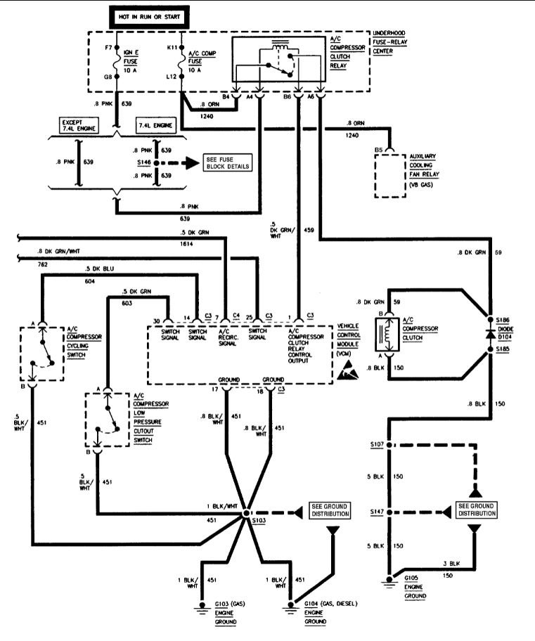

Okay, from here you are going to need a scan tool that can watch the PCM signals to see if the data signal from the control head to the PCM is working. Then go to the PCM up front in the engine compartment and see if it is triggering the ground control circuit at pin 43 in connector 2 (Dark green wire with white stripe). If that is going to ground in response to the dash controls but the relay isn't switching that wire has an issue between the PCM and the relay. If the control signal shows on with the scan tool but the pin at the PCM isn't grounding then the PCM is faulty.

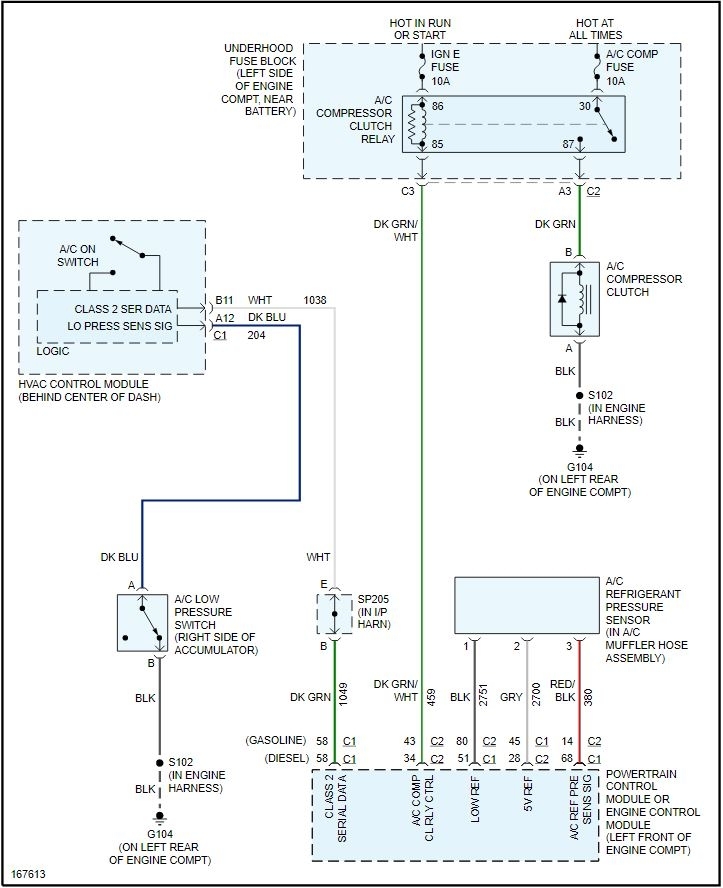

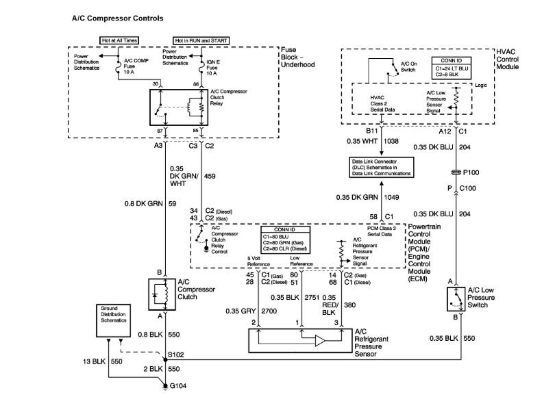

Looking at the relay diagram you attached. Pin 87 is hot with the key on and 86 is hot with the key on. If I jump either to pin 30 the compressor engages. Pin 85 does not become hot or ground when I engage the AC switch. It seems this is the one that should go to ground?
For the PCM testing, which is C2? My PCM has 4 color labeled connectors and seems to have 40 pins each.
Thanks again for all your help.
Wednesday, May 19th, 2021 AT 4:03 PM
STEVE W.
  • 15,676 POSTS
85 should go to ground when the A/C is on. As it isn't you need to get to C2 and see if the wire does go to ground there. Using a jumper to ground at that end would tell you if it's a wiring issue or if there is something in the PCM causing an issue. This is when you need a scan tool that can see the inputs and use the bi-directional controls to turn the output on and off. If you get nothing then the PCM is the problem.
