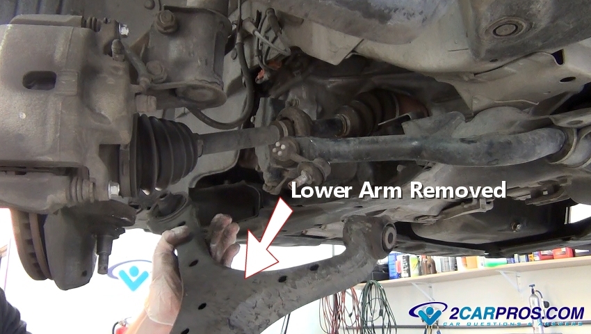

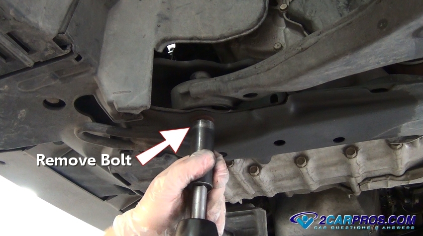

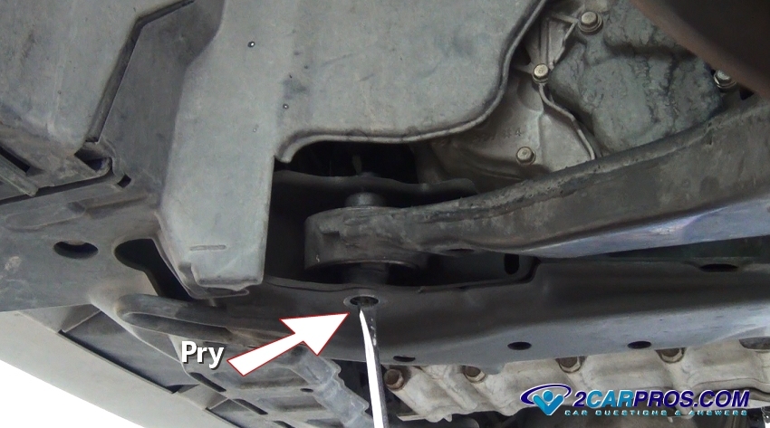

1. Remove the Lower Control Arm: This is done by releasing the ball joint and removing the sway bar link. If this job is being done on "live spring" suspension (shock) the lower control arm must be held by a hydraulic jack and then slowly lowered once the ball joint is released. Next, remove the lower control arm mounting bolts, a universal joint and socket can be used which makes the job easier. After the bolts have been removed the arm may be loose so keep your hands on it so it does not fall, if the control arm is still in its mounts firmly grasp the arm and pull it outward while moving it up and down to remove it from the frame mounts.

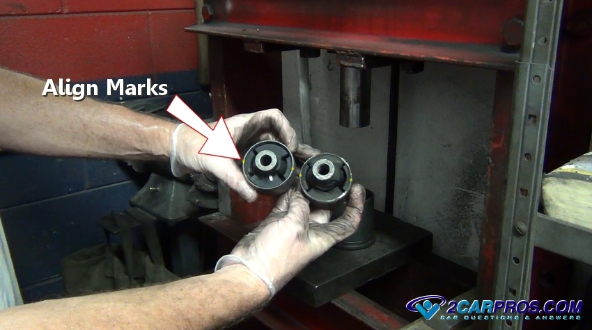

3. Remove Broken Bushing: The first step in replacing the bushing is to mark the orientation of the installation, which must be done to ensure it's correct operation, (If the bushing is incorrectly installed it will fail prematurely).
mark bushing orientation

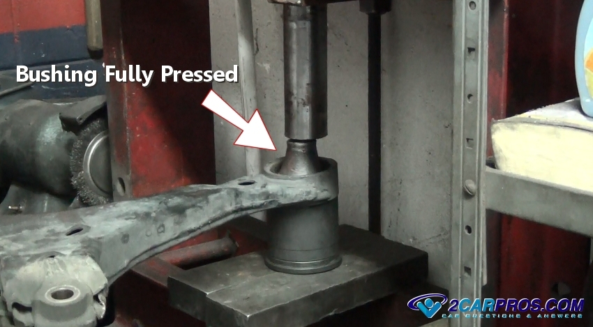

4. Press Old Bushing: A hydraulic press will be needed to remove the old bushings and install the new unit. Position the lower control arm into a hydraulic press using a press cone and cup to force the bushing from the arm. There will be an audible "pop" when the bushing starts to move. Continue pressing the bushing until fully removed from the arm. The control arm will become loose when the operation is complete, release the press and remove the arm. Clean the bushing housing on the control arm with a wire brush to remove any rust or debris.
press bushing downward

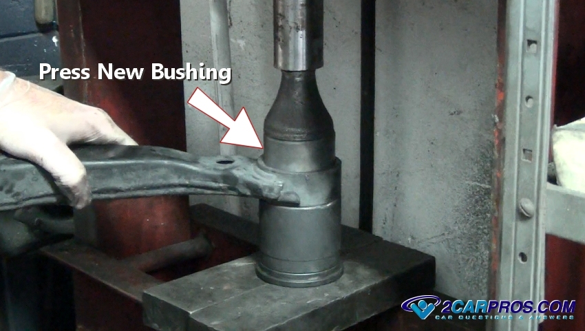

5. Install New Bushing: Verify the correct bushing orientation and set it inside the control arm, place the new bushing into the lower control arm while observing the marks you made from the old bushing. Do not apply lubrication to the bushing case, this will allow the bushing to walk its way out of the arm while in use. Align the press and slowly force the new bushing into place while making sure the bushing stays straight during the initial press, once the press has begun the bushing will stay straight.
press in new control arm bushing
Pro Tip: You can heat up the control arm bushing area with a butane torch, and then freeze the bushing for easier installation, (expand the arm and contract the bushing).

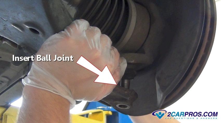

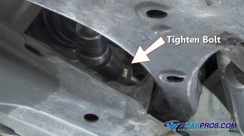

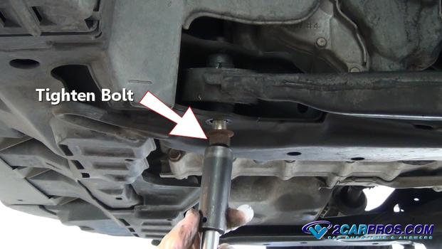

6. Inspect the Bushing Installation: Confirm the correct installation of the new bushing and you are all set to reinstall the lower control arm. Some would say the car must be realigned which is the correct, but if the alignment was good before the bushing when out, it will be back in correct alignment when the job is completed.
new automotive lower control arm bushing installed
