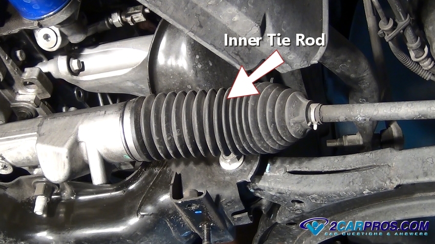

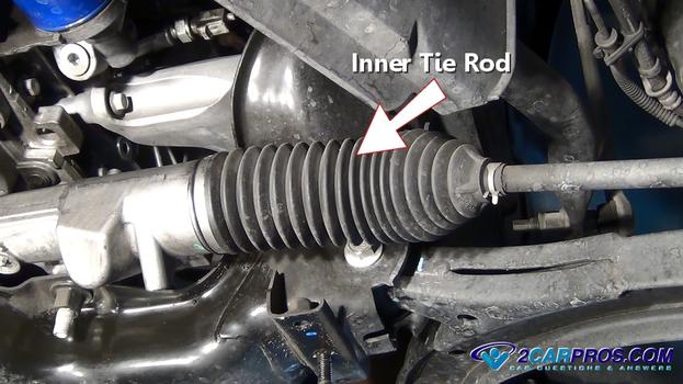

Steering System
1. Loose Tie Rod Ends: An inner and outer tie rod end hold the steering spindle steady which supports the front tires. These parts can wear it can cause play, allowing the front tires to move right or left when the brakes are applied. To check for this problem, raise the front of the car and grasp the front wheels, (one at a time, move them back and forth while watching the tie rods (4) with a flashlight. There should be no visible play, if play exists the tie rod end needs to be replaced.
automotive inner tie rod end
Worn Out Outer Tie Rod End
worn out automotive tie rod end

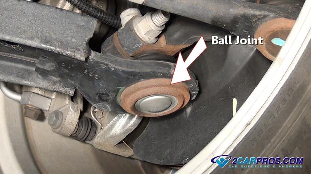

Suspension
1. Bad Lower Ball Joints: Lower ball joints are also used to hold the steering spindle steady while the car is driven. If the ball joints become worn, they will allow suspension components to move out of line causing the car the wonder to one side when the brakes are applied. When checking the ball joints lift the car slightly, but leave the wheels on the ground. This will take pressure off the joints and allow you to see any play while turning the steering wheel slightly from side to side.
Checking the ball joints while the car is still on the ground, or completely lifted, will make it difficult to check due to the heavy pressure of the car or spring. A large pry bar can be used by inserting it between the ball joint and spindle. Rock the bar back and forth while checking for excessive movement in the ball joint. If the ball joint has play it will need to be replaced.
lower ball joint
