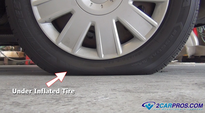

If a tire is run under inflated, it will cause the sidewall to overwork itself resulting in tire failure, under inflation can also cause the outside portion of the tread to wear prematurely and hurt gas mileage by increasing the vehicle's rolling resistance.
under inflated tire

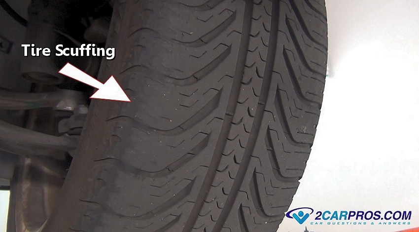

Tire alignment does more then keep your vehicle from pulling to the left or right, it helps the tire track correctly while holding the weight of the vehicle. When a tire alignment is out of specification, or the vehicle has a worn steering component such a tie rod end, or a failed suspension part such as an upper control arm, it can cause the tire to wear out prematurely due to the scuffing or feathering action as in the example below.
tire scuffing

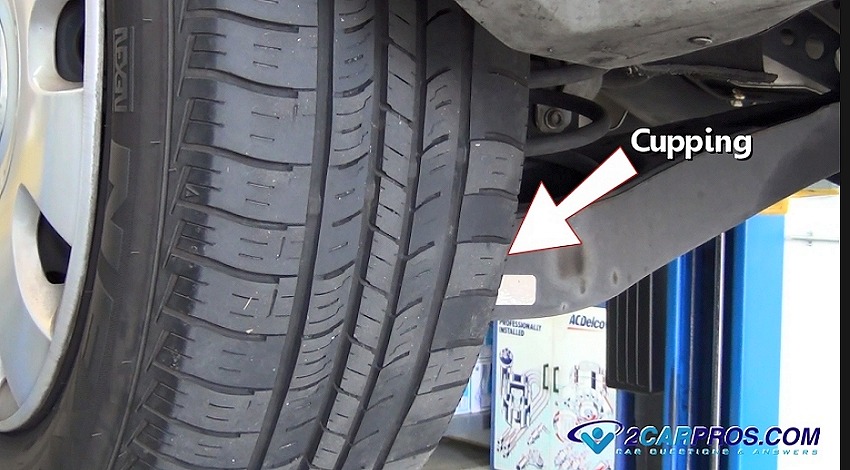

Tire cupping is caused by a tire being out of balance, or a worn strut or shock which allows the tire to bounce which produces this uneven tread pattern. Before the tires are replaced this issue should be addressed by replacing the struts or shocks and ensuring correct tire balance.
