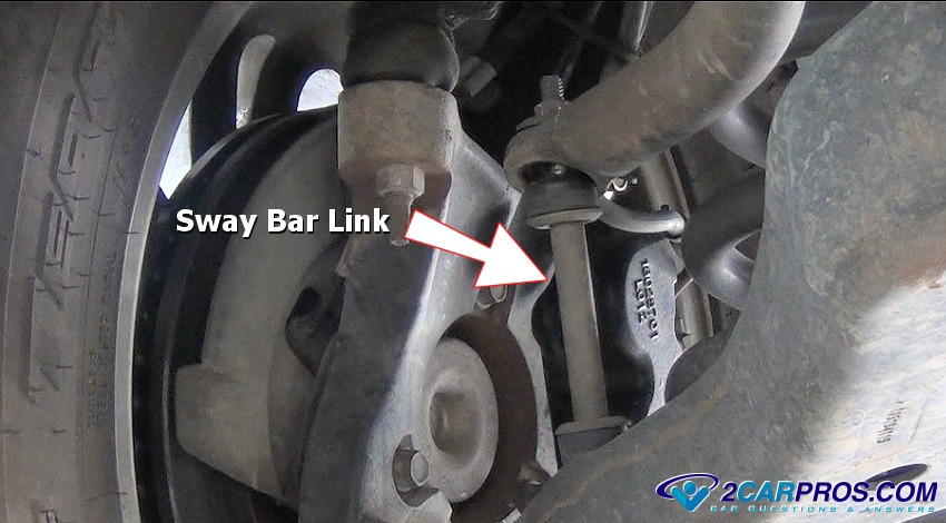

In most cases the car will need to be lifted and supported using jack stands, inspect the rubber bushings at each end and at both mounting points on the frame.
sway bar link

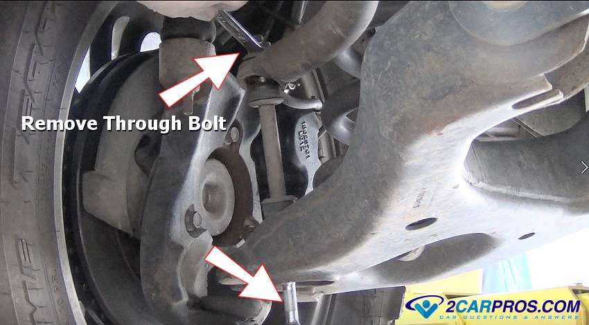

Here we are replacing the link bushings using a kit which is easily obtained, begin by removing the link through-bolt by holding the top nut and turning the bolt head at the bottom.
remove through bolt

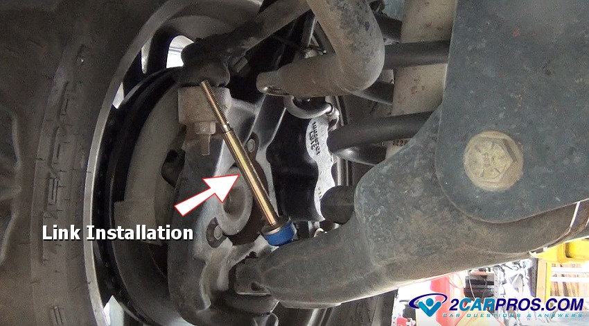

Assemble the new link kit in the same configuration inserting the through bolt with the washer and bottom bushing starting at the lower control arm.
link installation
Complete the installation by stacking the washer on top of the spacer while inserting the bushings, then tighten the nut to spec, in this case it is 23 foot pounds of torque, it is best to replace both sides at the same time.
