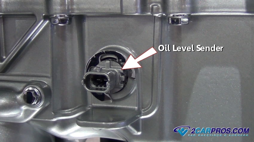

10. Oil Level Sender Leak
Some cars use a oil level sensor is used to provide feedback data for the PCM and illuminate a oil level warning light to tell the driver the engine oil level is low. This two wires sensor is located in the side of the oil pan and is submerged in motor oil. Mounted to the oil pan using an O ring seal this unit can become hard and leak in which case the oil must be drained and the O ring and sender replaced.
