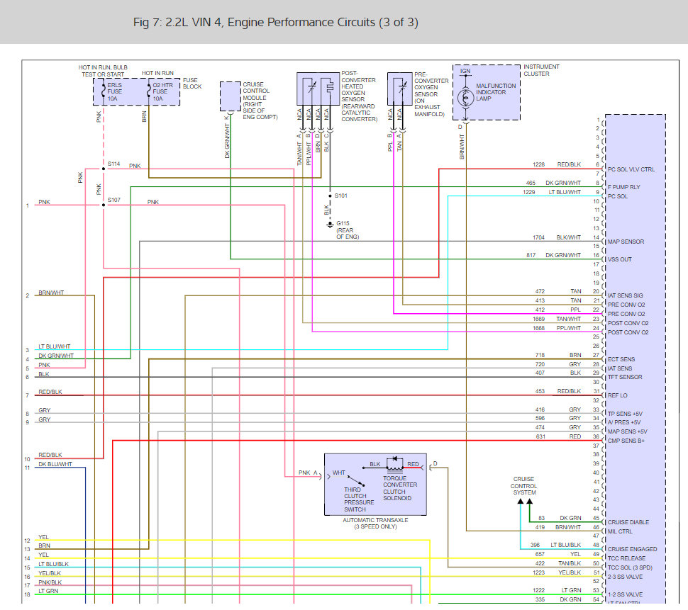

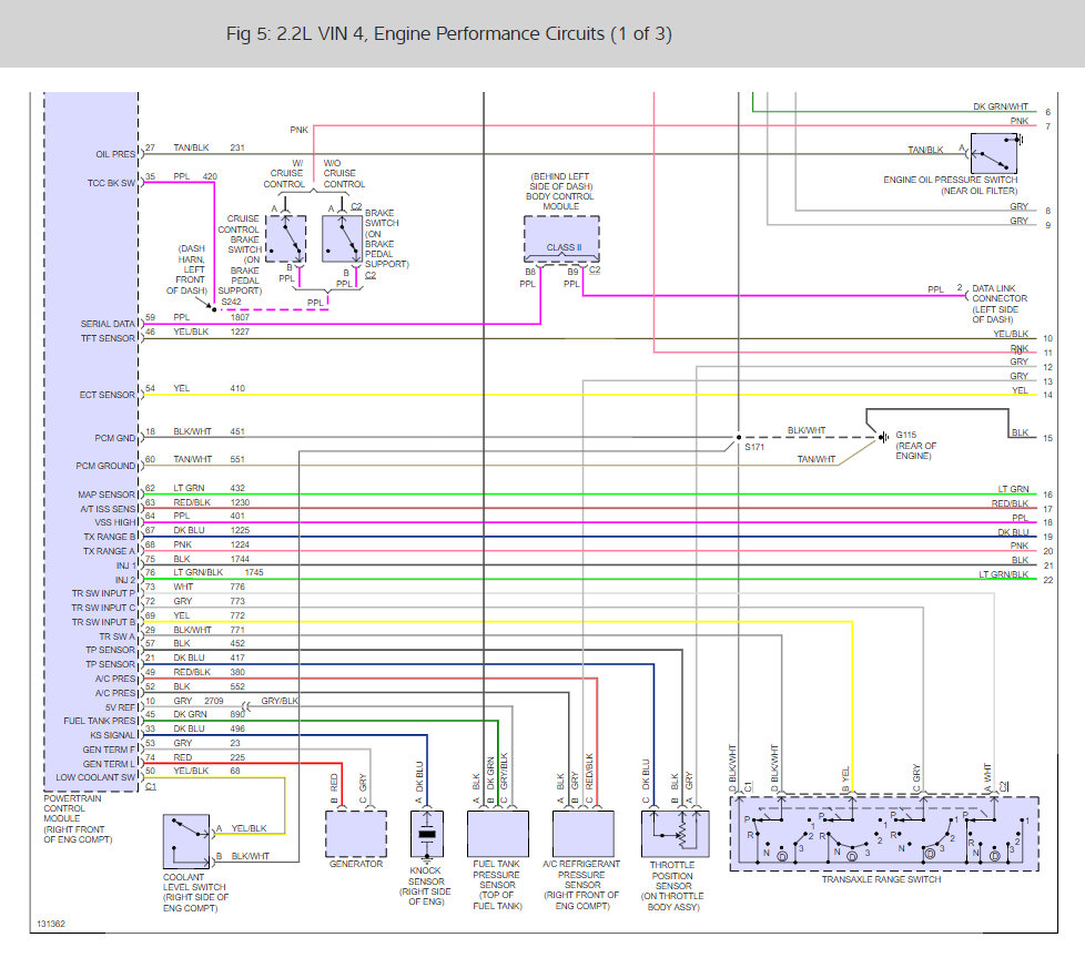

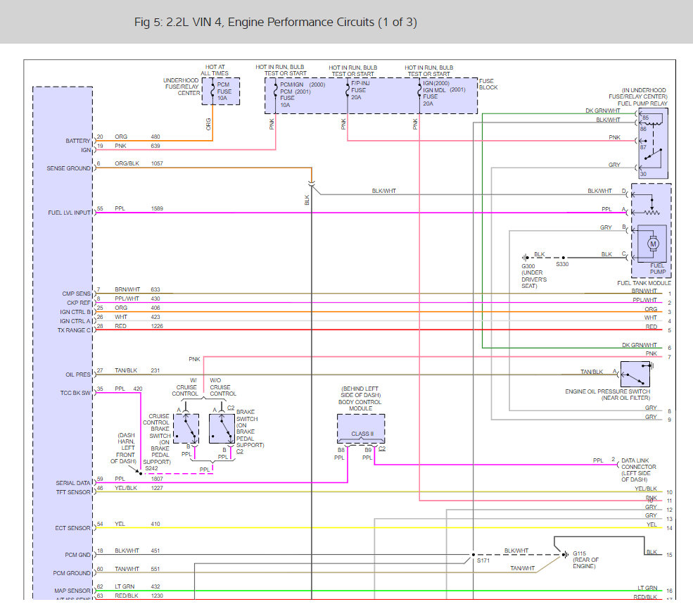

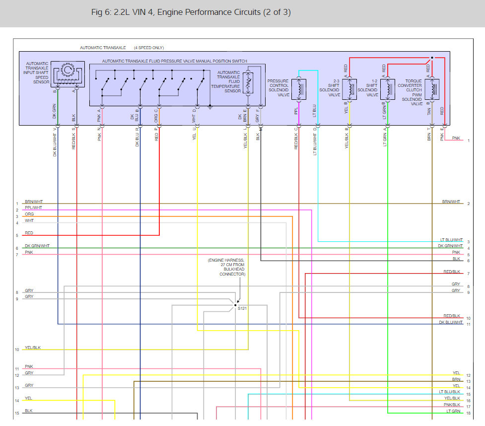

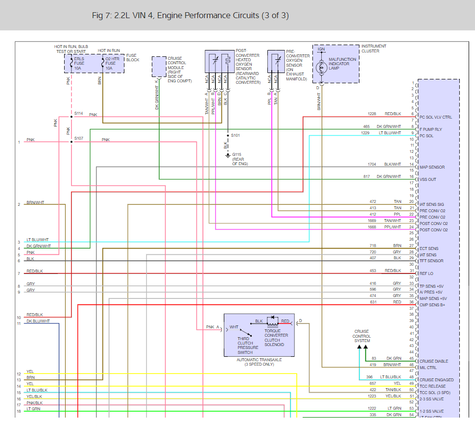

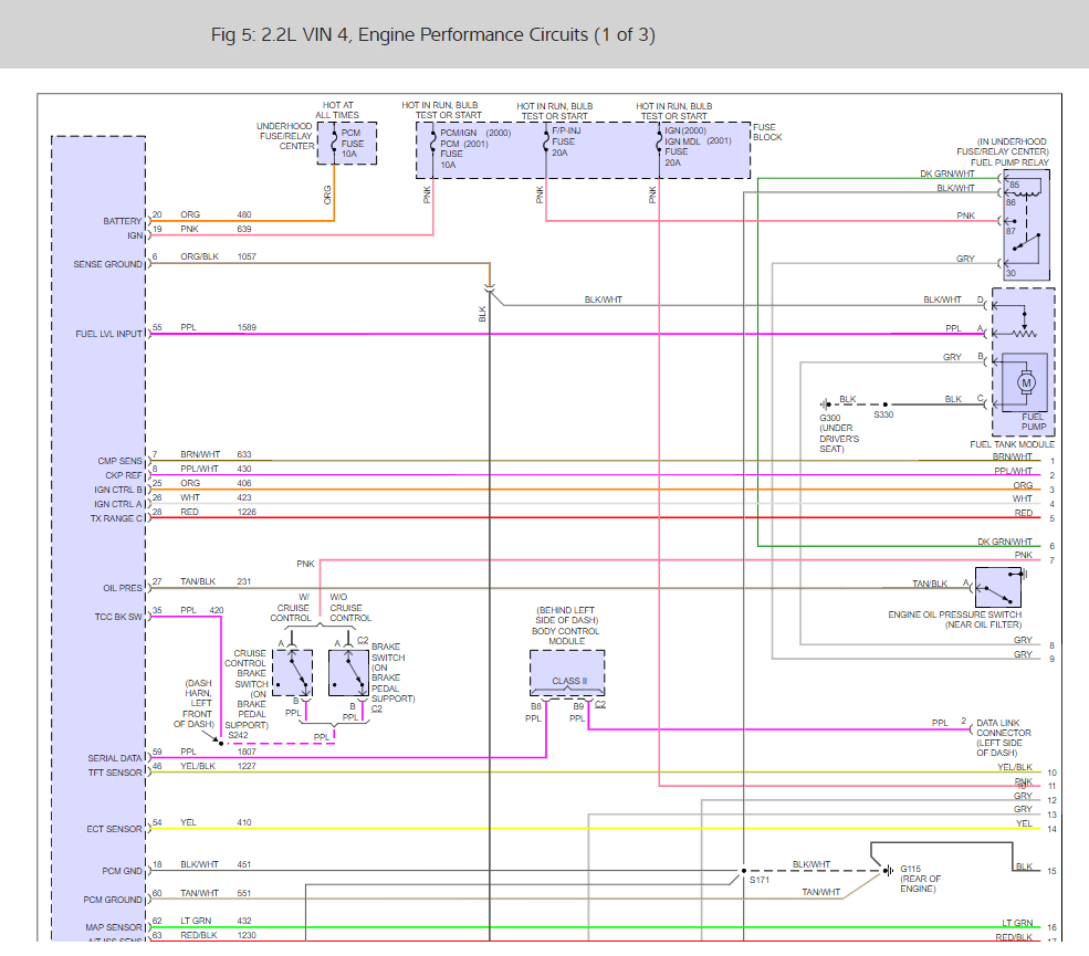

DEHARTN

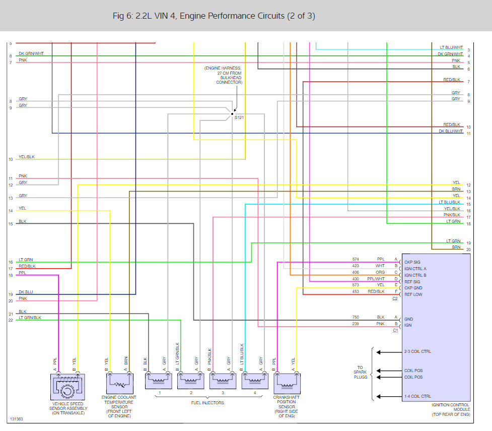

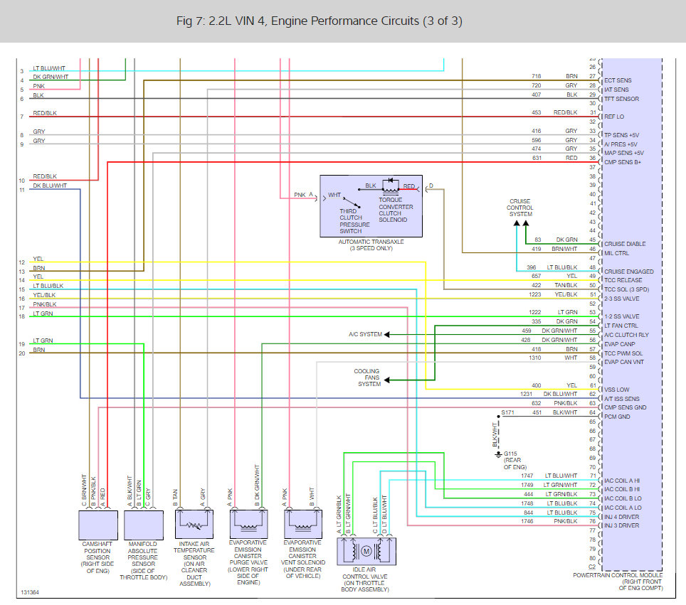

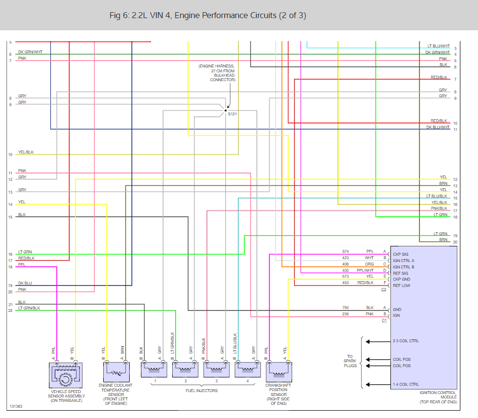

I have spark and good compression. I have replaced the crankshaft position switch. I need the engine wiring please?
Thursday, September 28th, 2017 AT 6:48 PM
KEN L
  • MASTER CERTIFIED MECHANIC
  • 55,488 POSTS

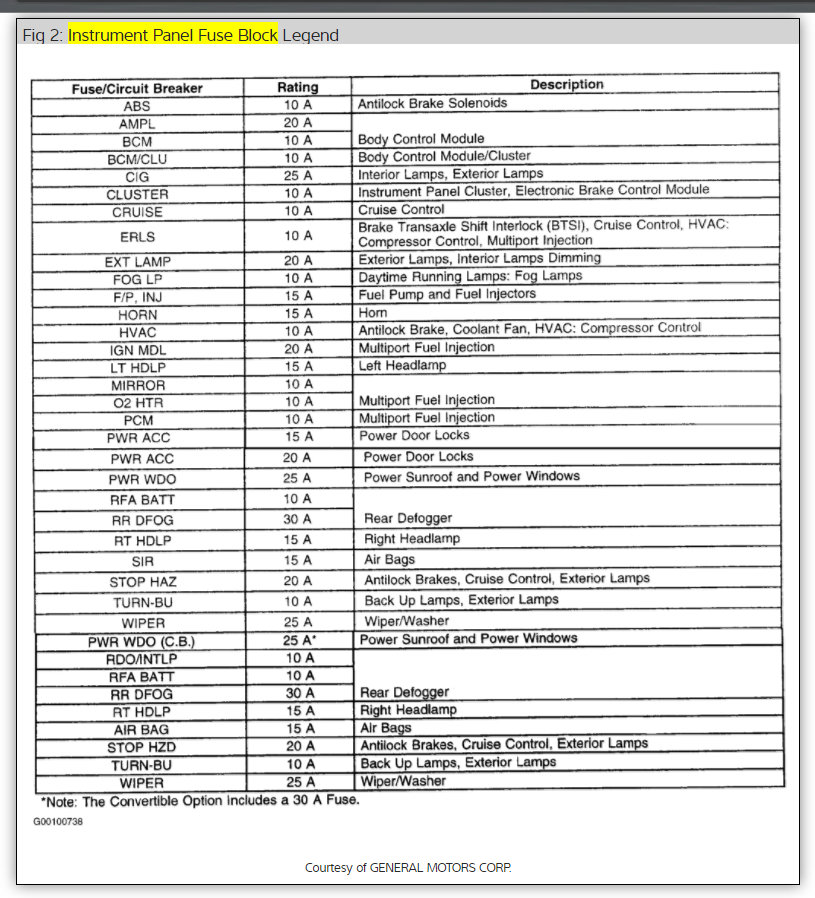

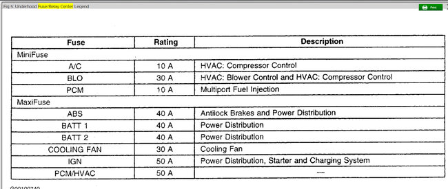

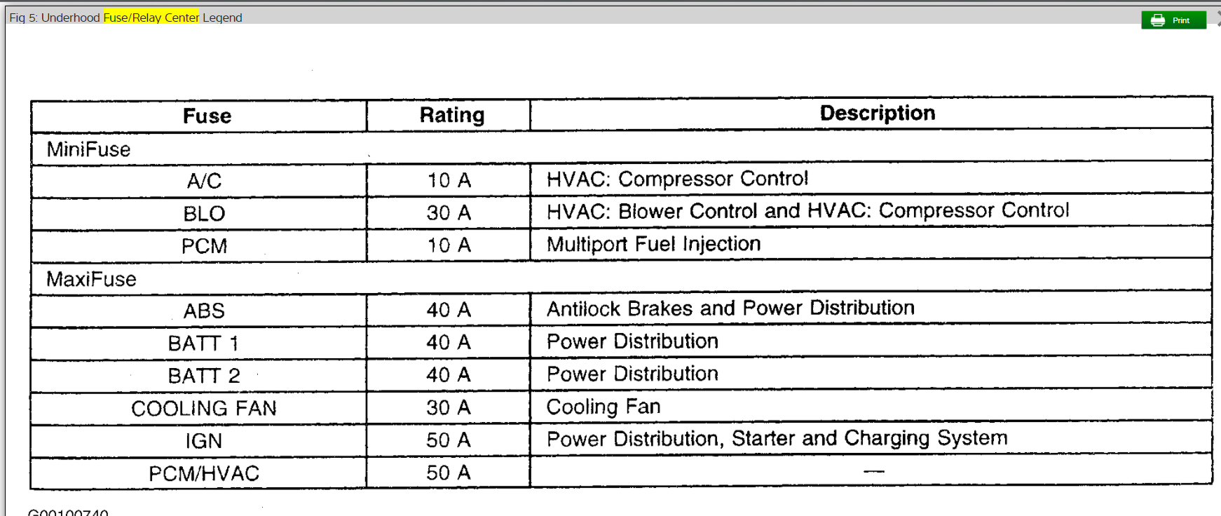

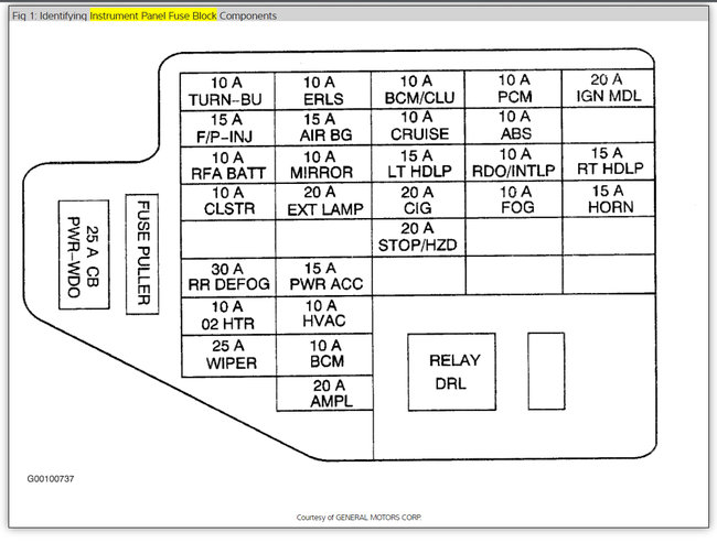

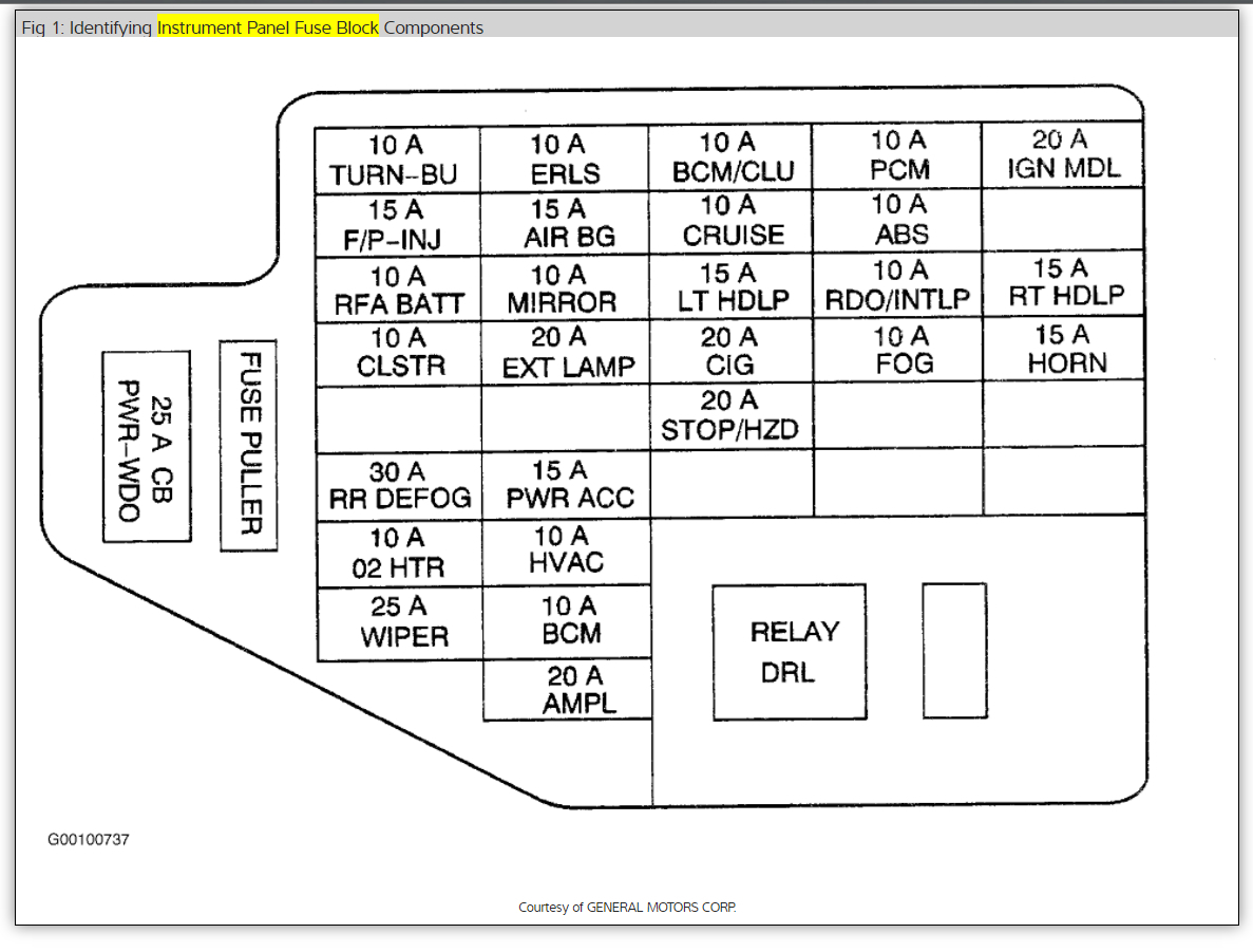

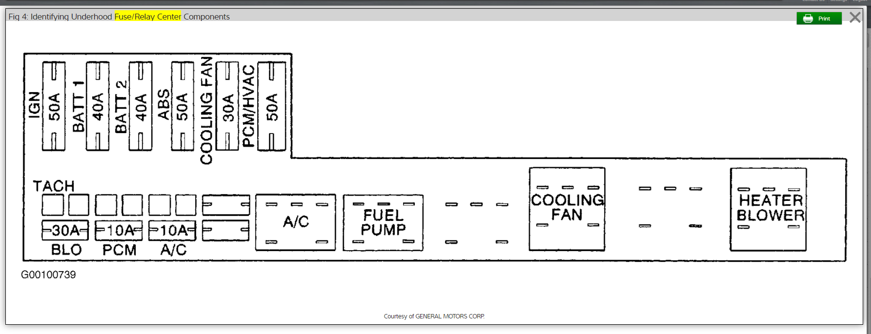

It sounds like we have lost power somewhere. Here are a couple of guides and diagrams (Below) for you to do some easy checks and report back. There are 6 fuses that run the system.
ERLS, CLS-PCM, PCM/IGN, F/P INJ, IGN, PCM
and
Wednesday, October 4th, 2017 AT 2:16 PM
DEHARTN
I found I short in the main harness where is rubbed through. All set thank you.
