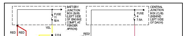

My truck won't start. I'm hearing a few different clicking sounds. Sometimes I hear a faint, fast clicking sound before I even attempt to start the truck. Once I do try to start it, sometimes it clicks once, then nothing. Sometimes it will click repeatedly when I turn the key. However, when my headlights are turned on, it doesn't click at all.
I cleaned the battery cables, nothing.
I replaced the battery, nothing.
I had the starter tested, it is fine.
Not sure what to try next.
**I apologize if this question was submitted twice.
Thursday, December 31st, 2020 AT 8:43 AM (Merged)
HMAC300
  • 48,601 POSTS
Check the 2fuses that are pictured then check starter relay with a like relay then check voltage at battery and voltage at starter to see if they are the same. If not check your cables they may have corroded.

BJM99C
Great thank you.
Let me do the fuses first. How do I know if they are bad? Please see image.

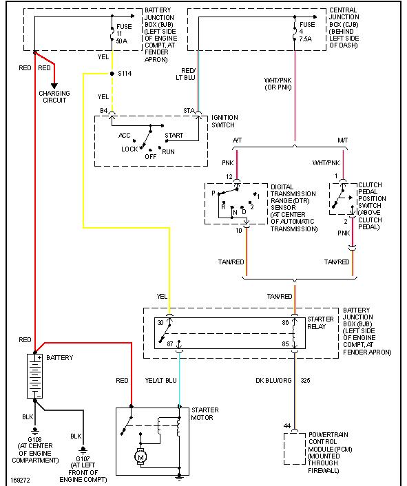

Could it be an ignition switch?
HMAC300
  • 48,601 POSTS
I'm sending the starting circuit diagram along, it could be ignition switch but it cold also be relay or poor battery as all of that has to be checked that I said in previous reply

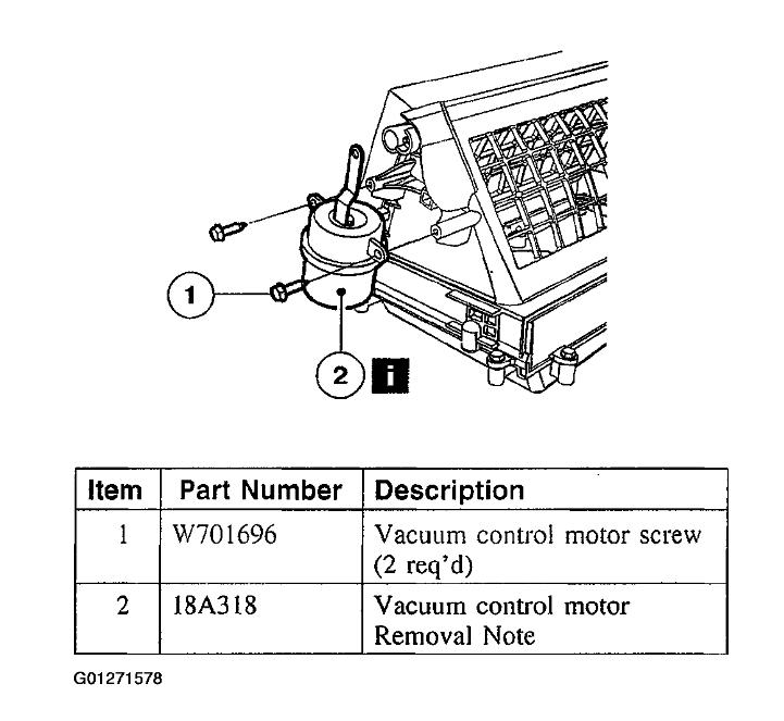

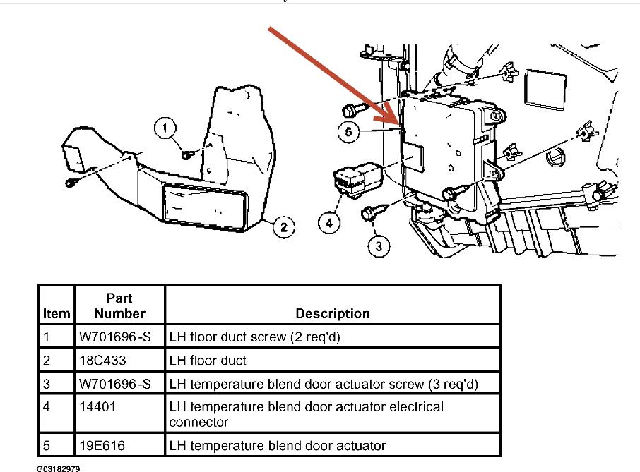

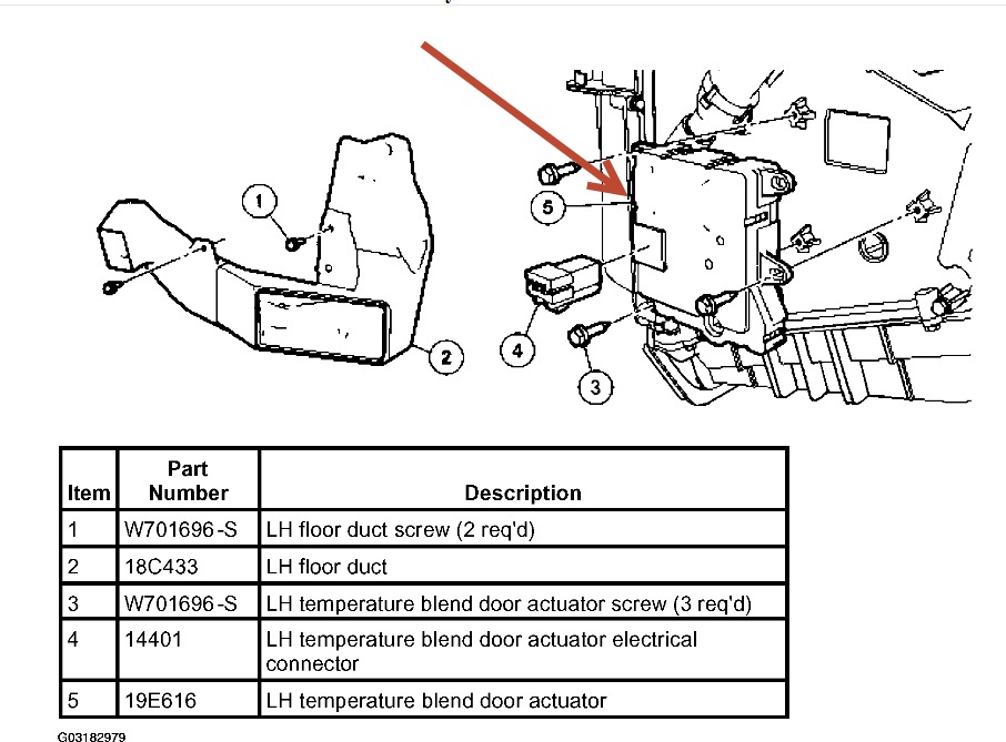

It has started to act as if the battery is dead and not start, no cab lights, no nothing. Then after a while it starts right up. I'm not sure if it's a battery issue or electrical issue. The last time it happened I was leaving for work and couldn't get it to do anything, when I got home from work I went to check it out and it started first try no problem. It has done this a couple times now. Also with the same truck, when you turn the heater setting to warm, you can hear a clicking noise under the dash and the temp of the air doesn't change. So now it won't start from time to time and has no heater or defrost. Any ideas where I should begin?
HMAC300
  • 48,601 POSTS
Checkbattery for condition including load test. Auto parts and tire stores do this for free. Check your acutuator in heater to see if it's working or not. You can try pulling hvac fuse fro 60 seconds with key on as that sometimes resets actuators. It could aslo be a vacuum problem with air inlet motor. See pics there is an actuator on llh and rh so look on both sides.
