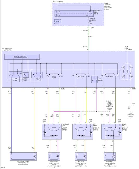

The driver side power window of my ford f-150 will not go up. My other windows go up with no problem. Do you have any idea on how to fix this problem?
Tuesday, March 26th, 2019 AT 4:38 PM (Merged)
  • 110,192 POSTS
I would start by checking if the motor is getting power. If it is, then replace the motor. If not, work back to the switch on the door and check if it is working then the main switch on the driver's door.
NOTE: There are two wires going to the motor. One has power when the window goes up, the other when it goes down. The motor is grounded through the door.
Let me know what you find.

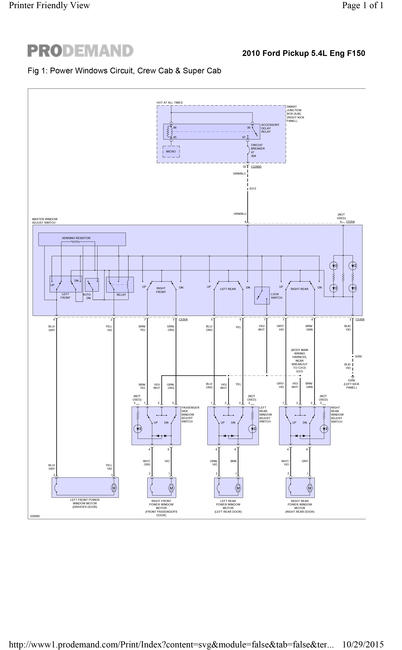

2008 Ford F-150- this is a flood recovery truck. Windows are rolled all the way down. How do I get the windows to roll back up?
MJR346
  • 132 POSTS
Get the electrical shystem working again. Most likely start by replacing the fuse box on passenger side which is also a module for everything if I remember
  • 110,192 POSTS
If they are power windows, check fuses and make sure there is power to the switch. I beliece the module that mjr refers to is the GEM. I it behind the fuse box.

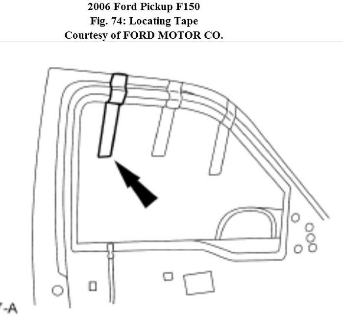

How to replace power window regulator on a 2006 Ford F150 driver side?
Tuesday, March 26th, 2019 AT 4:39 PM (Merged)
KHLOW2008
  • 41,814 POSTS
WINDOW REGULATOR AND MOTOR - FRONT DOOR
Removal and Installation
1. Remove the front door trim panel.
2. Remove the front door watershield.
3. Secure the front door window glass in the full UPWARD position with tape.
Fig. 74: Locating Tape
4. Remove the front door window glass-to-regulator assembly bolts.
Loosen the glass clamp fasteners through the 2 vertical slots in the inner door panel.
To install, tighten to 9 Nm (80 lb-in).
5. Disconnect the front door window electrical connector.
6. Remove the front door window regulator bolts.
To install, tighten to 11 Nm (8 lb-ft).
7. Remove the front door window regulator and motor.
8. To install, reverse the removal procedure.
