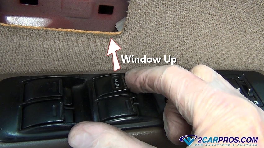

2. Raise the Window Up
Once the door panel has been removed with the window wiring still connected turn the ignition key back to the on position. Work the switch so the window is in the most upright position then turn the key off. It is a good idea to move the passenger's side window down to prevent accidental lock out during the job. If the car has manual windows you can just work the window crank up or down.

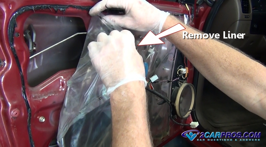

3. Remove the Inner Liner
There will be a plastic liner which is used to keep water from entering the inner workings of the door. Grasp the plastic door liner and gently remove it. The glue used is meant to be reused after the repair is complete.
remove inner door liner

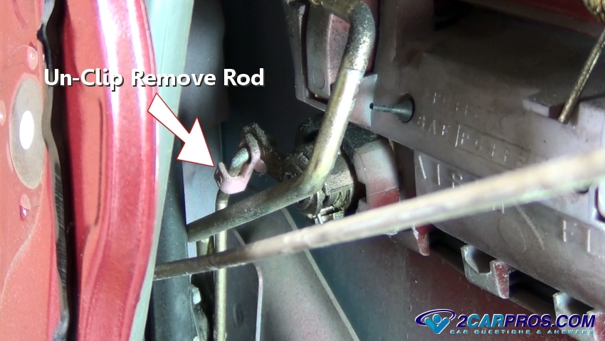

5. Remove Lock Control Rod
Locate the lock control rod and by using a long pick or screwdriver un-clip the rod and remove it from the lock arm by pushing the clip downward away from the control rod.

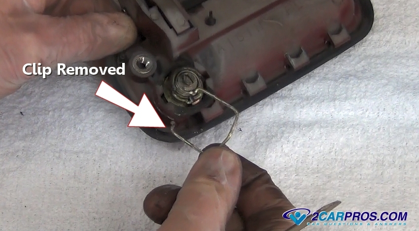

8. Remove Door Lock
Use a small screw driver or pick remove the retainer clip that holds the lock inside the handle housing.
remove lock retainer clip
Once the clip has been removed the lock cylinder will become loose and ready to be removed.
lock retainer clip removed

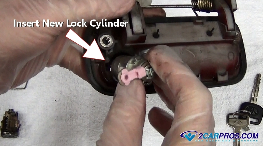

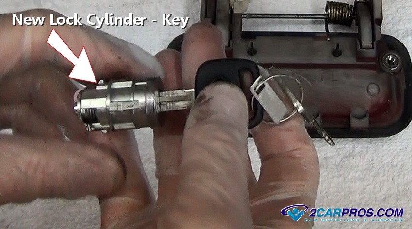

9. Install New Door Lock
A new key will be included with the new lock assembly that will be different than your old door key. If you want the same key the lock will need to be taken to a locksmith with the old key and rekeyed.
new lock cylinder key
Gently insert the lock into the door handle being careful to line up any keyway timers in the handle so the orientation of the lock is correct.
insert new lock tumbler

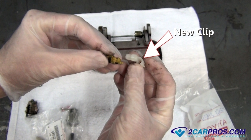

10. Install New Outer Door Handle Rod Clip
Once the door lock has been installed into the handle inspect and remove broken clips.
remove broken door handle clip
Match the new door handle clip to the old unit they should match identically.
Grasp the door handle to insert the new plastic retainer clip. Now the handle is ready for installation.

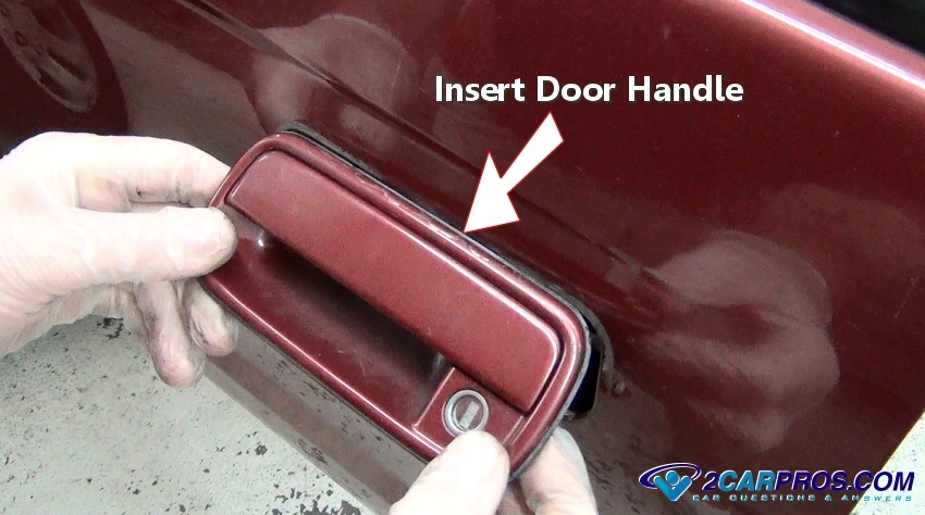

11. Reinstall Outer Door Handle
Gently lower it into position while being careful of the paint and control arms behind the handle.
insert door handle
While holding the handle in place from the front side install the mounting bolts and tighten them to 5 foot pounds of torque.

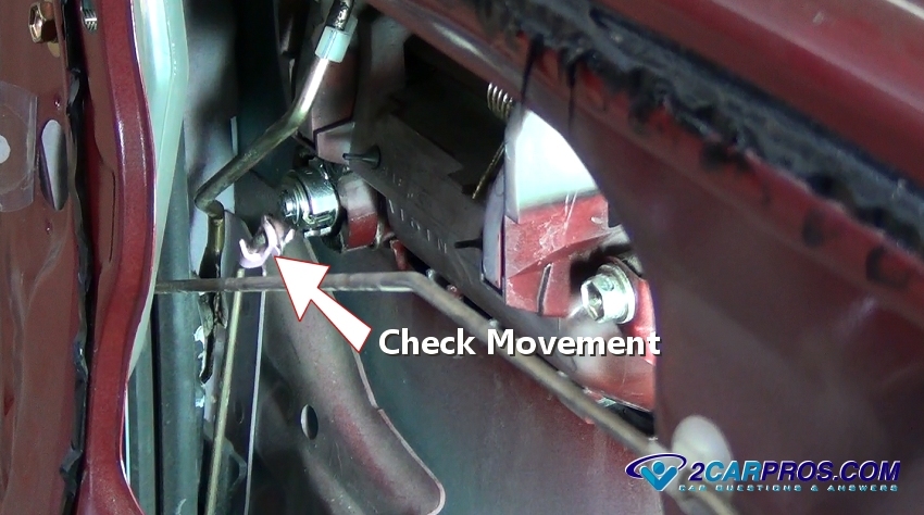

Then reconnect the control rods to the lock and to the door handle while securing the plastic clips.
reinstall lock handle control rods

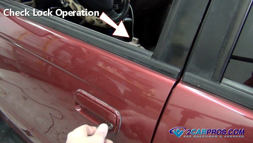

Once the control rods are connected use the key and work the lock to confirm it's proper operation. Work the door handle as well.
check control rod movement

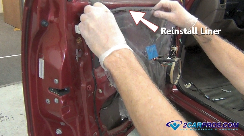

Now grasp the plastic liner and reattach it to the door body. Be careful not to leave tools inside the door.
reinstall plastic door liner

Check the door lock and handle operation to confirm a proper repair and you are all set.
check lock operation
