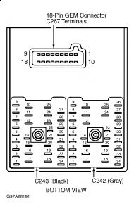

Hello.
Driver's window won't go down except in One Touch Down (Express Down) mode - regular Down doesn't work. Master switch works fine for all other functions, including passenger window.
You did a terrific job of providing assistance for an '02 F150 owner here:
http://www.2carpros.com/forum/2002-ford-f150--windows-dont-work-vt206582.html
Can you provide me year-appropriate data just like that (except maybe bigger scans of the inserted jpgs - I could hardly read them)? The switch connector layout of the '02 data doesn't seem to match my '97.
Thanks in advance.

Would suspect the switch and or wiring
remove switch and inspect wiring in door jam
I will try and email u the pic
good luck
let me know

Turn ignition switch to OFF position. Disconnect instrument panel fuse/relay block Black connector C243. Measure resistance in Tan/Light Blue wire between master switch 4-pin connector and instrument panel fuse/relay block Black connector C243 terminal No. 10. Measure resistance between ground and Tan/Light Blue wire at master switch 4-pin connector. If resistance is less than 5 ohms between master switch and fuse/relay block Black connector C243, and greater than 10 k/ohms between ground and master switch 4-pin connector, go to next step. If resistances are not as specified, repair Tan/Light Blue wire. Clear DTCs and retest system.
Measure resistance in White/Black wire between master switch 4-pin connector and instrument panel fuse/relay block Black connector C243 terminal No. 9. . Measure resistance between ground and White/Black wire at master switch 4-pin connector. If resistance is less than 5 ohms between master switch and fuse/relay block Black connector C243, and greater than 10 k/ohms between ground and master switch 4-pin connector, go to next step. If resistances are not as specified, repair White/Black wire. Clear DTCs and retest system.
Measure resistance in Gray wire between master switch 4-pin connector and instrument panel fuse/relay block Black connector C243 terminal No. 28. Measure resistance between ground and Gray wire at master switch 4-pin connector. If resistances are less than 5 ohms between master switch and fuse/relay block Black connector C243, and greater than 10 k/ohms between ground and master switch 4-pin connector, go to next step. If resistance is greater than 5 ohms, repair open in Gray wire. Clear DTCs and retest system.
Turn ignition switch to OFF position. Disconnect 18-pin GEM connector from instrument panel fuse/relay block. Measure resistance between instrument panel fuse/relay block 18-pin GEM connector terminal No. 8 and instrument panel fuse/relay block Black connector C243 terminal No. 10. Measure resistance between instrument panel fuse/relay block 18-pin GEM connector terminal No. 6 and instrument panel fuse/relay block Black connector C243 terminal No. 9. Measure resistance between instrument panel fuse/relay block 18-pin GEM connector terminal No. 9 and instrument panel fuse/relay block Black connector C243 terminal No. 28. If resistances are less than 5 ohms, replace GEM. If resistances are greater than 5 ohms, replace instrument panel fuse/relay block. Clear DTCs and retest system.

Disconnect instrument panel fuse/relay block Black connector C243. Measure resistance between ground and instrument panel fuse/relay block Black connector C243 terminal No. 24 (Black wire). If resistance is less than 5 ohms, replace instrument panel fuse/relay block. If resistance is greater than 5 ohms, repair open in Black wire. Clear DTCs and retest system.
Turn ignition switch to RUN position. Measure voltage between ground and left front window motor connector White/Black wire while pressing left front window switch in UP position. If voltage is greater than 10 volts, replace left front window motor. If voltage is less than 10 volts, repair open in White/Black wire. Clear DTCs and retest system.
