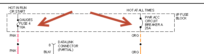

Power windows just quit working, need to identify where the power windows fuses, and relays are.
Tuesday, March 26th, 2019 AT 4:37 PM (Merged)
HMAC300
  • 48,601 POSTS
See pic if relays and fuses ok have scanned the gem module may be bad

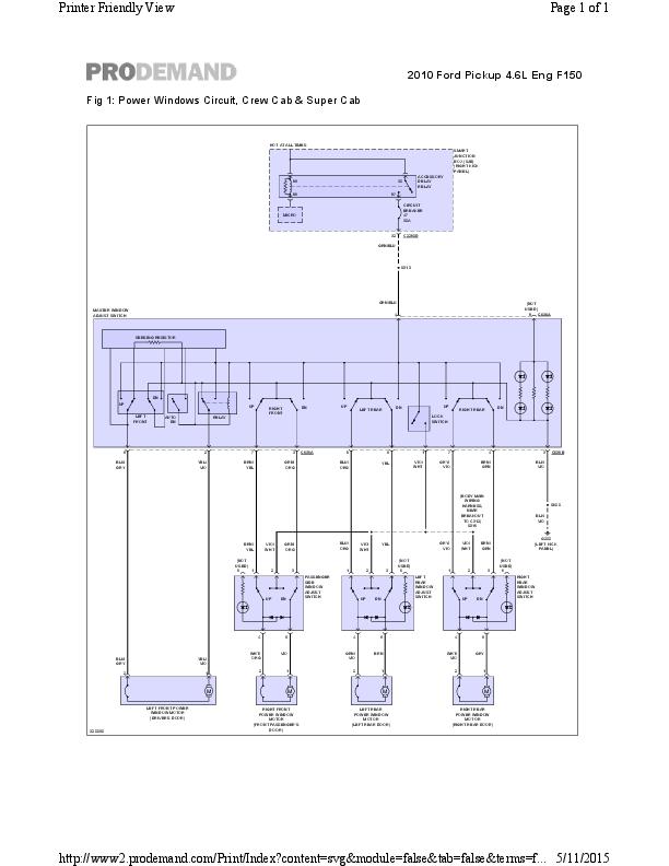

Hi: my passenger window is not working from any switch, in any direction. Here are the symptoms and what I have done so far.
- through testing, I find the window will go up from it's door switch, but the master switch produces no effect.
- the window is not "stuck, " it moves freely when the motor is removed.
- the motor is good, tests both directions.
- the door switch was replaced with a (used) working unit, no issues there.
- the master door switch was replaced with a (used) working unit, no difference in the issue.
So, I have ruled out a stuck window, bad motor or switch(s).
Am just not ready to bring to Ford and turn over my checkbook for them to spend hours testing the wiring. What do you think?
Brian

It sounds like I need you to tell me the exact submodel and trim so I can get you the right wiring diagrams for it.
Tuesday, March 26th, 2019 AT 4:38 PM (Merged)
BRIANCB
F150 crew cab, XLT
the interior is cloth, not leather.
RIVERMIKERAT
  • 6,110 POSTS
Here is the power window wiring diagram for the 2010 F-150 XLT Crew Cab.
