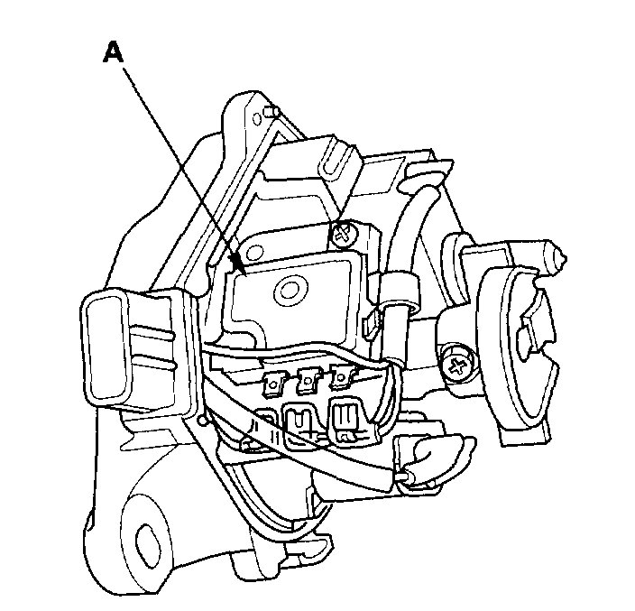

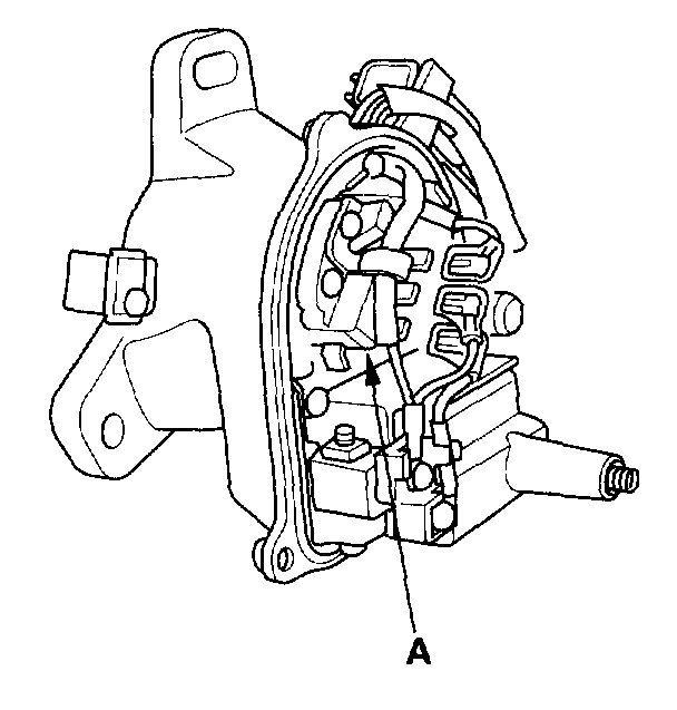

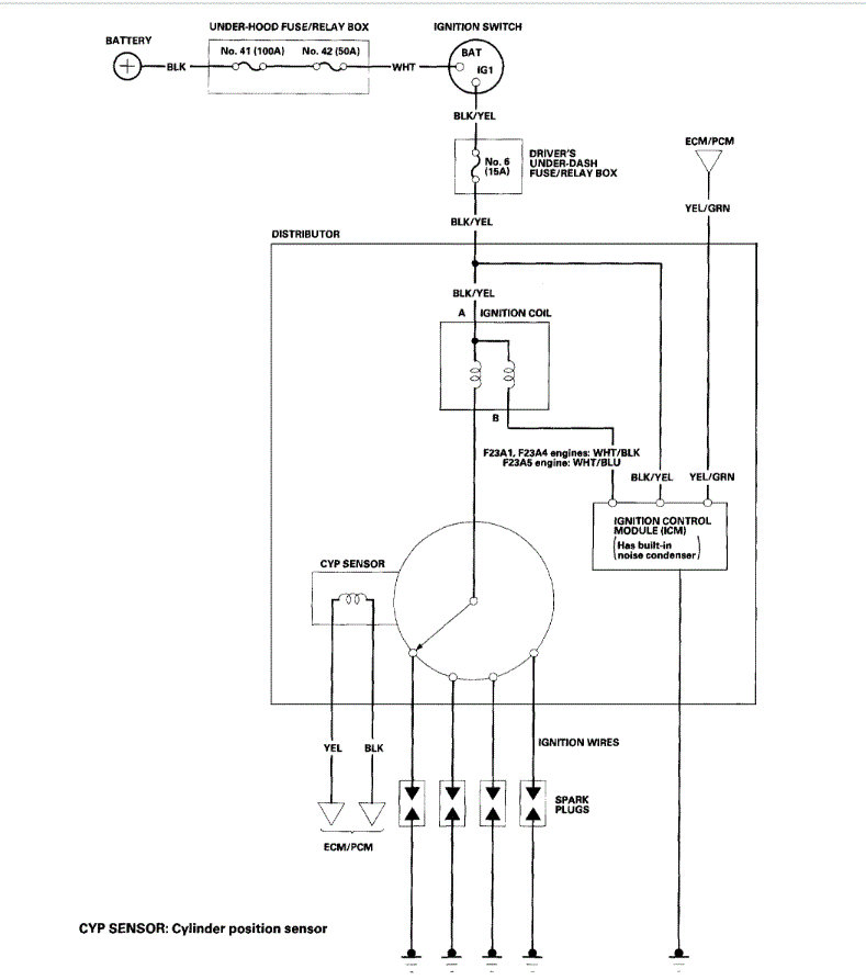

Hello, my car won’t start it will turn over but, won’t crank. I'm only getting spark in one spark plug wire, and I just replaced wires, plugs, and the distributor.
Monday, September 28th, 2020 AT 5:05 PM (Merged)
  • 110,194 POSTS
Chances are the ignition control module has failed. That is where I would start checking. Here are the diagnostics related to it. The attached pics correlate with the directions. The very last pic is a schematic for the ignition system.
___________________________________________
1999 Honda Accord LX Sedan L4-2254cc 2.3L SOHC (VTEC) MFI
Component Tests and General Diagnostics
Vehicle Powertrain Management Relays and Modules - Powertrain Management Relays and Modules - Ignition System Ignition Control Module Testing and Inspection Component Tests and General Diagnostics
COMPONENT TESTS AND GENERAL DIAGNOSTICS
NOTE:
- If the malfunction indicator lamp (MIL) comes on, refer to the Fuel and Emission System.
- Perform an input test for the ignition control module (ICM) after finishing the fundamental tests for the ignition system and the fuel and emissions systems.
- The tachometer should operate normally if the ICM is OK.
1. Remove the distributor ignition (DI) cap, the distributor ignition (DI) rotor, and the leak cover.
F23A1 and F23A4 2.3L SOHC VTEC
pic 1
F23A5 2.3L SOHC Non-VTEC
pic 2
2. Disconnect the wires from the ICM (A).
3. Turn the ignition switch ON (II). Check for voltage between the BLK/YEL wire and body ground. There should be battery voltage.
- If there is no battery voltage, check the BLK/YEL wire between the ignition switch and the ICM.
- If there is battery voltage, go to step 4.
4. Turn the ignition switch ON (II). Check for voltage between the WHT/BLK (WHT/BLU for the F23A5 engine) wire and body ground. There should be battery voltage.
- If there is no battery voltage, check:
- ignition coil.
- WHT/BLK (WHT/BLU for the F23A5 engine) wire between the ICM and ignition coil.
- If there is battery voltage, go to step 5.
5. Disconnect the 25P connector from the ECM/PCM, and check for continuity on the YEL/GRN wire between the ICM and ECM/PCM. There should be continuity.
6. Check for continuity on the YEL/GRN wire to body ground. There should be no continuity.
7. If all the tests are normal, reconnect the ECM/PCM 25P connector B, and replace the ICM.
_________________________________________________________
Let me know what you find

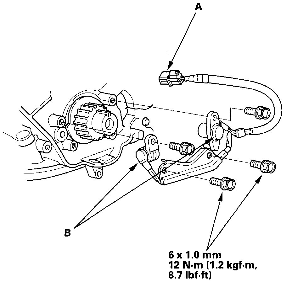

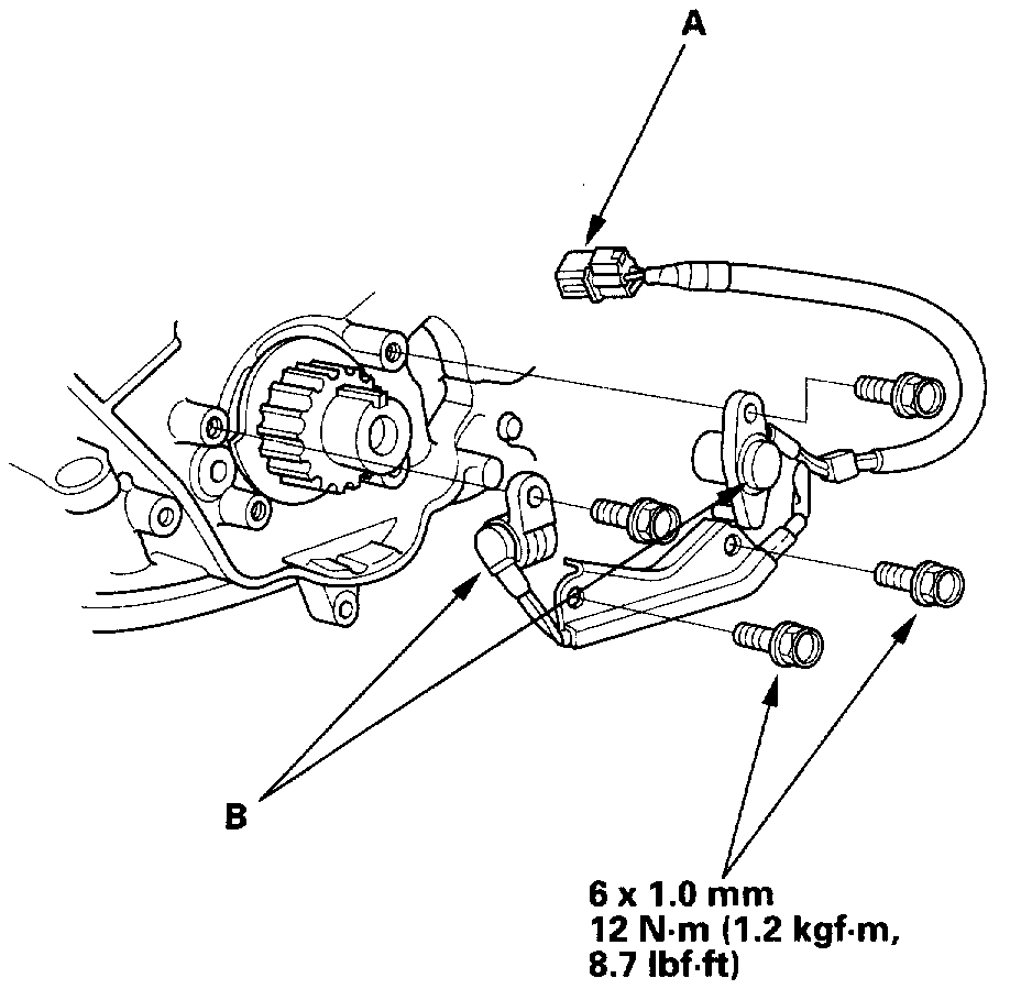

Okay. The last thing I can think of is the crankshaft position sensor and top dead center (TDC) sensor. The TDC controls ignition timing when starting and the crank sensor controls ignition and injection timing when running. Have you replaced that as well? If not, can you get a live data scanner? If so, see if there is an RPM reference on the scan tool when cranking the engine. If there isn't, replace these two items. Here are the directions:
1999 Honda Accord EX Coupe L4-2254cc 2.3L SOHC (VTEC) MFI
Procedures
Vehicle Powertrain Management Sensors and Switches - Powertrain Management Sensors and Switches - Computers and Control Systems Crankshaft Position Sensor Service and Repair Procedures
PROCEDURES
1. Remove the balancer belt.
2. Remove the balancer belt drive pulley.
Pic 1
3. Disconnect the CKP/TDC sensors connector (A), then remove the CKP/TDC sensors (B).
4. Install the CKP/TDC sensors in reverse order of removal.
5. Install the balancer belt.
Let me know what you find.

Hello, I found out it was just a timing belt and we are replacing it hope it didn’t bend valve.
  • 110,194 POSTS
If you tell me if the engine is a 2.2L and if it's a v-tec or not, I can get you all the directions and timing marks for you.
I have to be honest, this is an interference engine. There could be internal damage. Give me the specifics regarding the engine so I can help. You listed it as a 2.7 and that isn't an engine size they made. I just need to confirm what you have.
