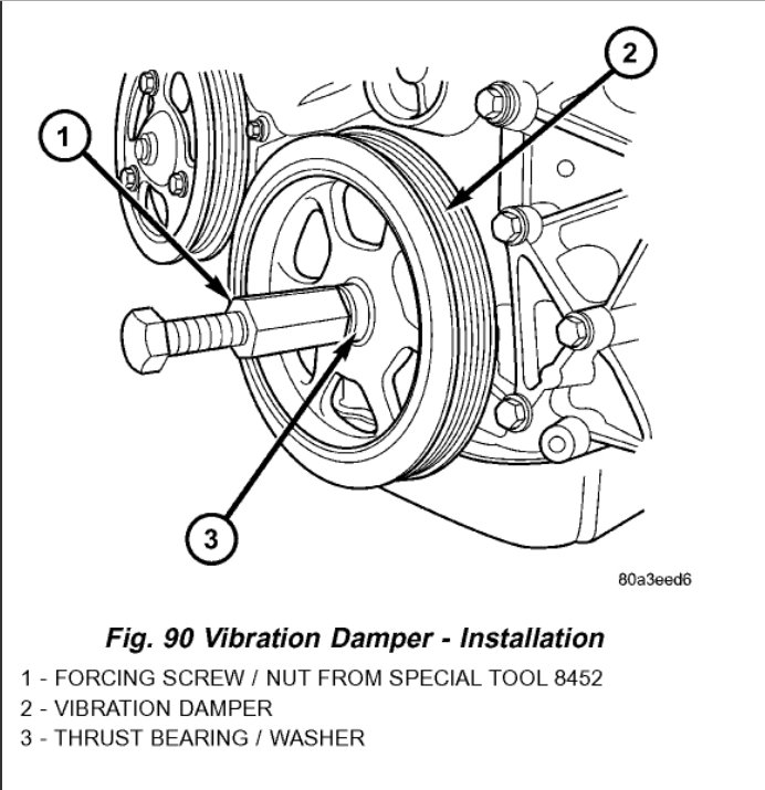

It could be, to confirm the problem can you use a large breaker bar on the front of the engine to see if you can turn it over manually?
This guide shows how to remove it which you don't need to do but you can see the part that needs to be turned.clockwise.
https://www.2carpros.com/articles/how-a-harmonic-balancer-works
Monday, October 23rd, 2017 AT 11:49 AM

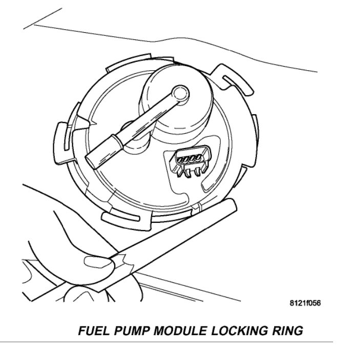

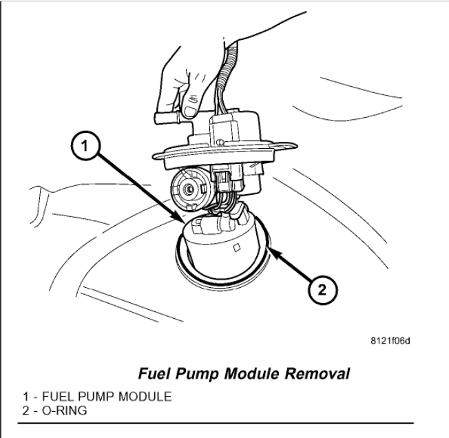

I been told its fuel pump
Monday, October 23rd, 2017 AT 2:18 PM
KEN L
  • MASTER CERTIFIED MECHANIC
  • 55,488 POSTS

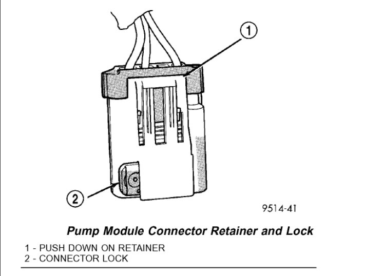

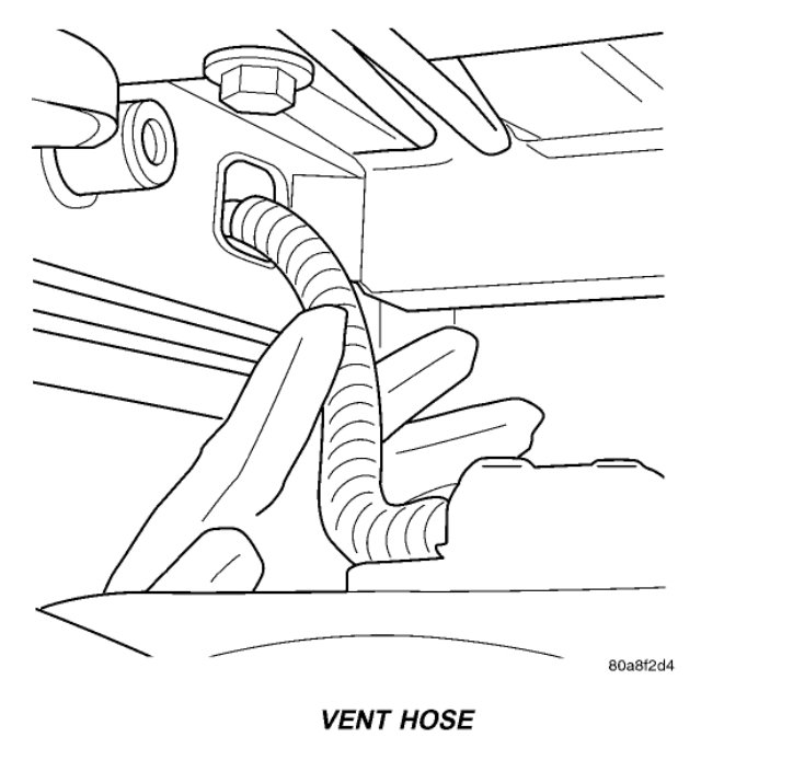

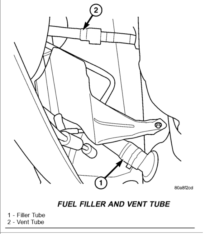

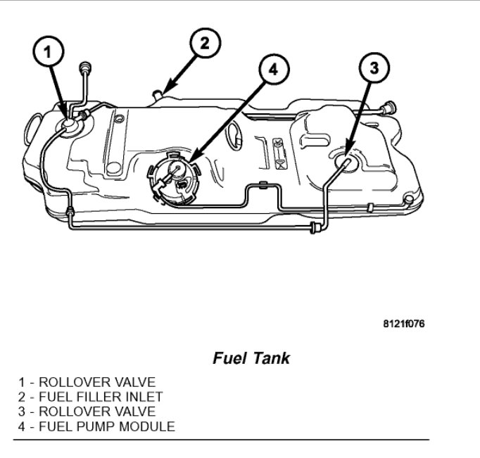

Yep, we were getting there, here is a guide and some diagrams of what it will take to change the fuel pump out I would do the relay as well.
This guide will show you what you are in for.
https://www.2carpros.com/articles/how-to-replace-an-electric-fuel-pump
Try Amazon for the pump
Here it is for your car (below)
Please let us know.
