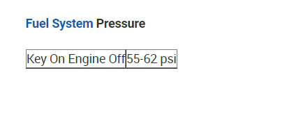

The next thing we need to do is check the fuel pressure.
Please run through this info and we can go from there. Basically I suspect we have a fuel or spark issue so we need to start there. Thanks

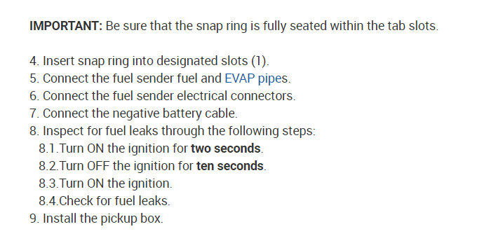

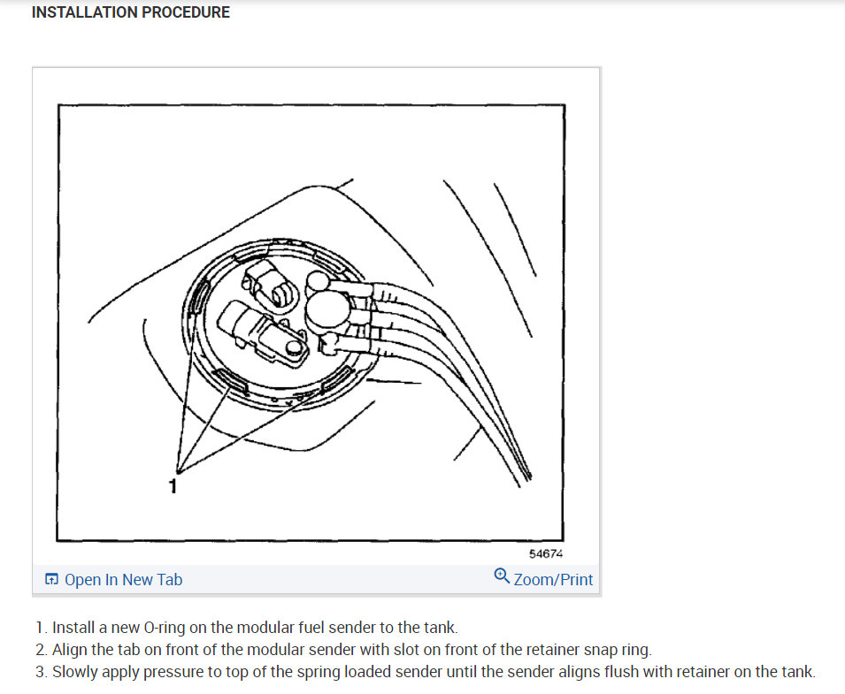

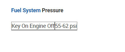

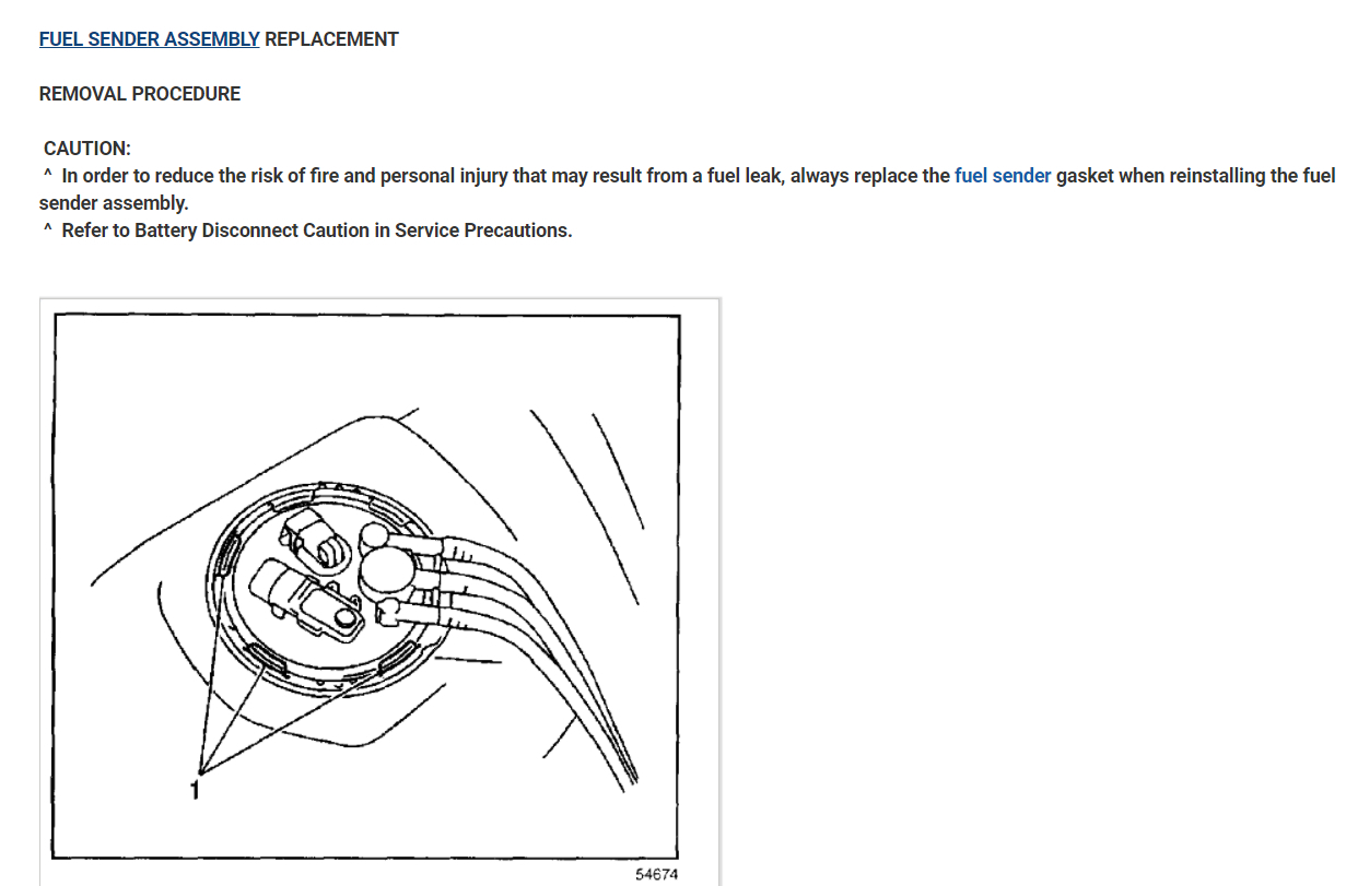

I would start with checking the fuel pressure as lack of fuel would cause this issue.
https://www.2carpros.com/articles/engine-stalls
You can rent a tester at a parts store for this test. If it is below specs, then the pump needs to be replaced.
https://www.2carpros.com/articles/how-to-replace-an-electric-fuel-pump

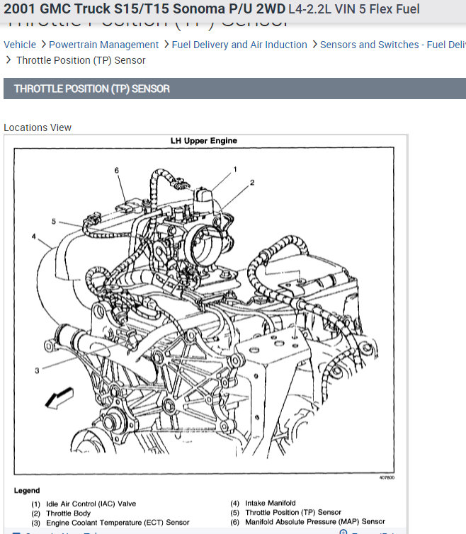

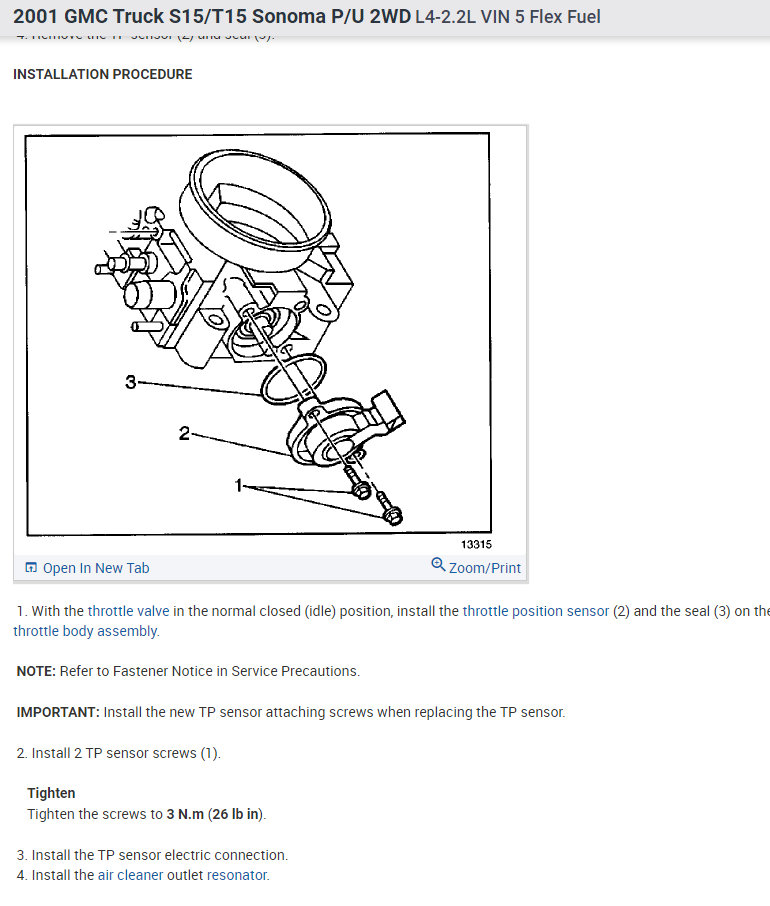

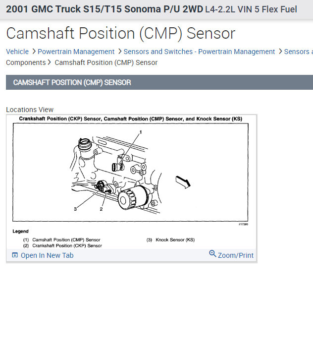

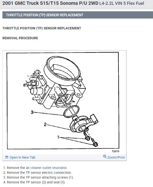

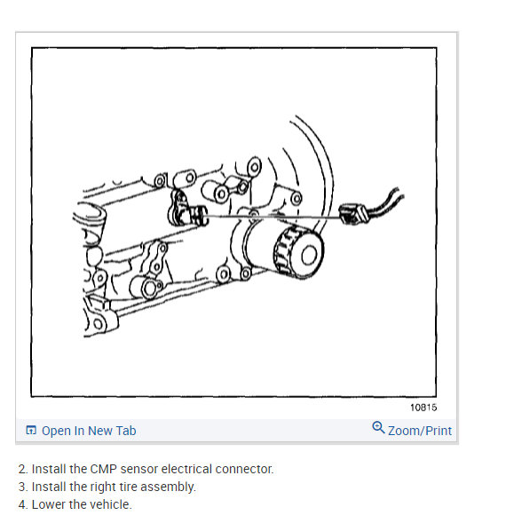

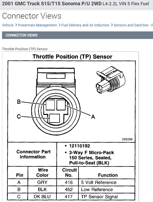

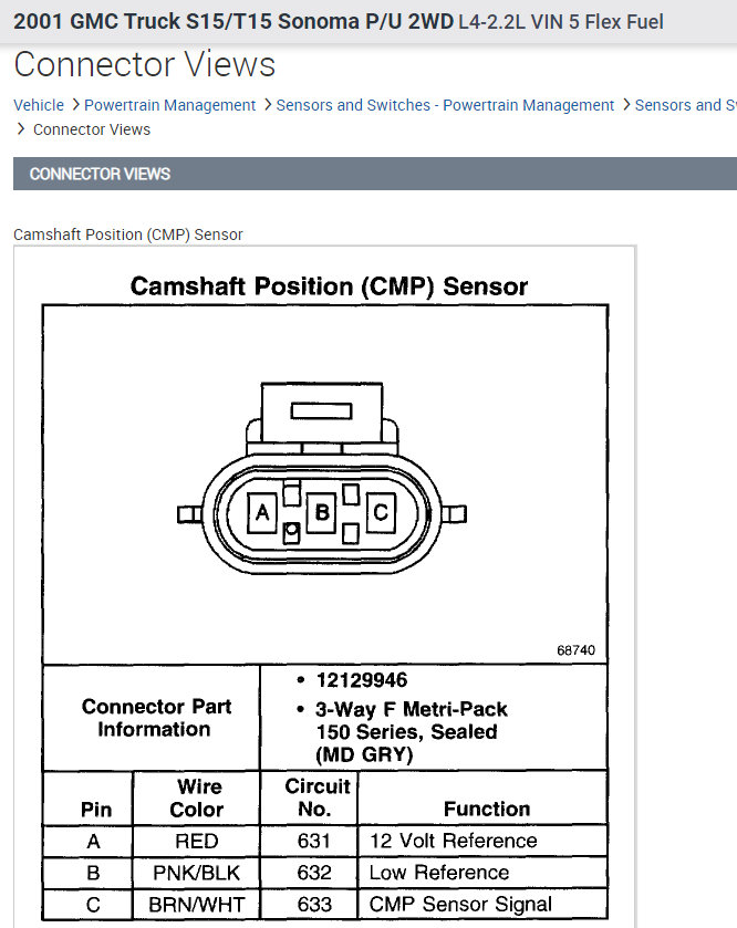

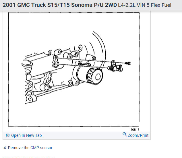

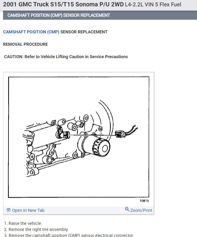

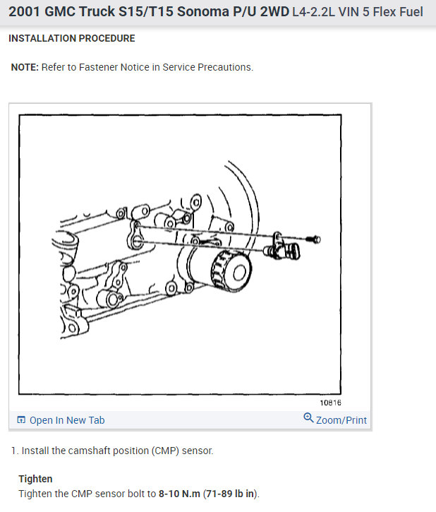

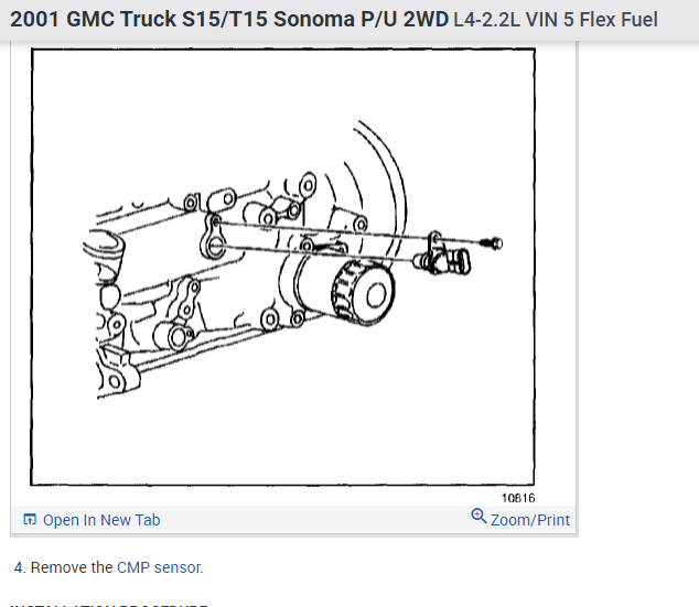

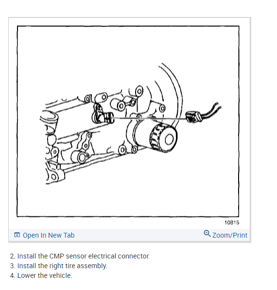

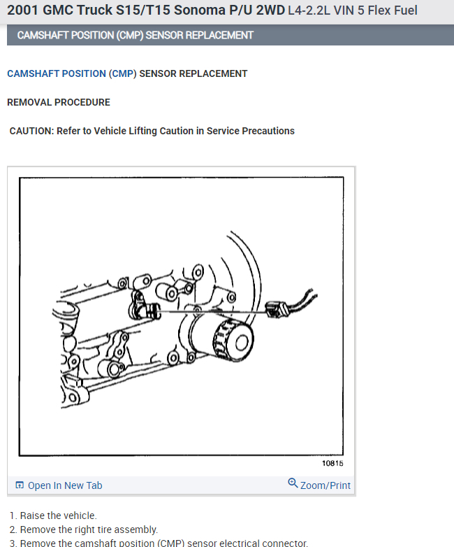

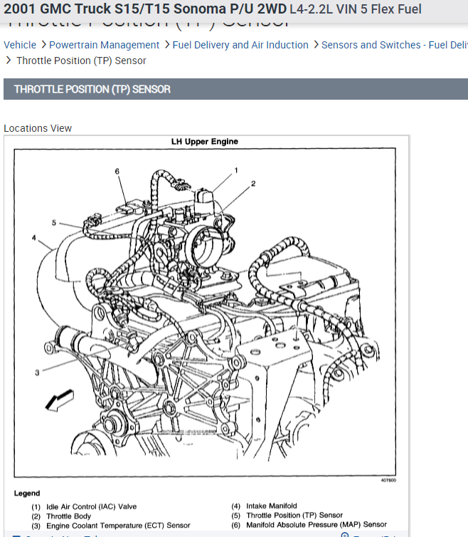

Fuel pressure is good. could it be cam sensor or throttle body sensor? like I've said before it wants to fire but won't..

So does the engine just cranks over and not start?
The engine will need spark, fuel and have compression before it can start.
Have you checked to see if you are getting spark?
Is there any components you have already replaced?
What kind of issues did you have before it won't start anymore?
Typically when a cam sensor is bad you could have rough idle. It could allow the engine to start but will not run very good or shut off after few seconds.
Please let me know what you got.

If it is due to a sensor then you will be able to get several cranks but no start. Keep in mind that a bad crank sensor will allow the engine to crank but not start.
