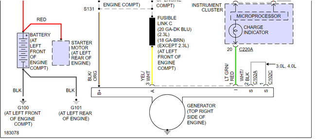

Make sure that all ground connections are clean and tight. A bad ground can cause some crazy symptoms because the electrical circuit will find it's own ground path if the correct ground is not good.

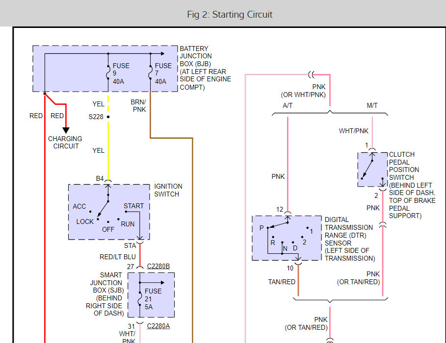

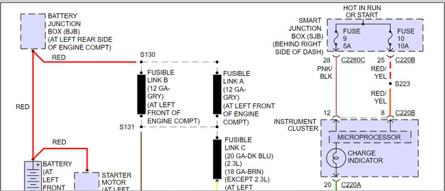

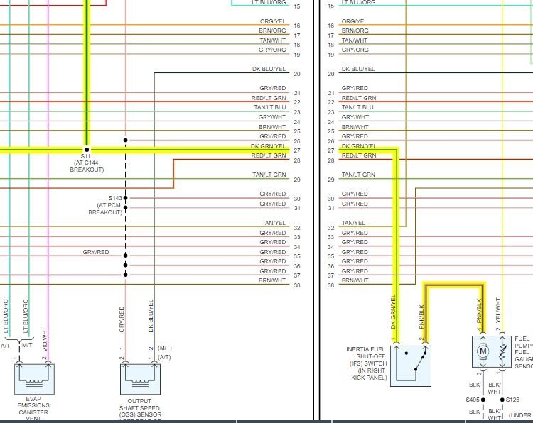

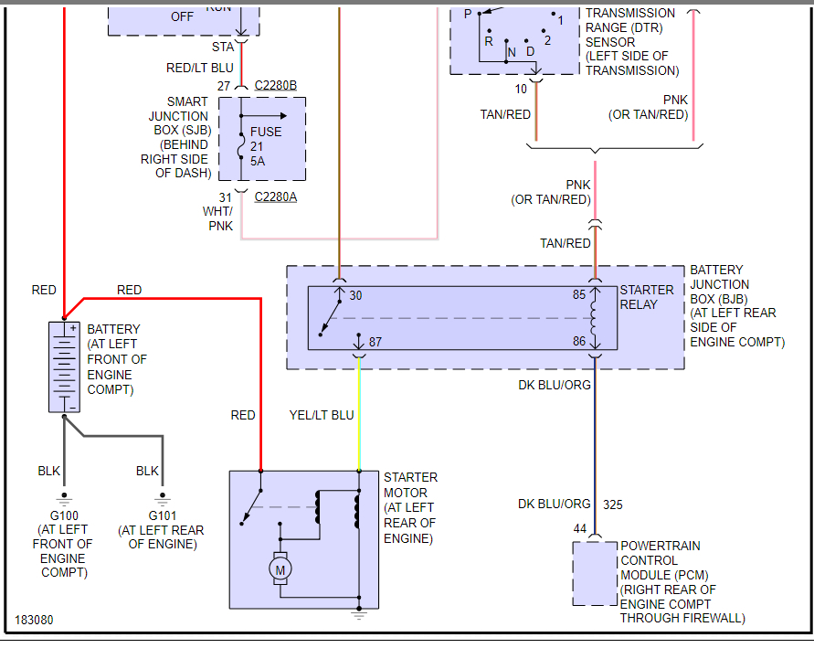

No start, Is 6.5 volts at switch key on correct?
Monday, March 8th, 2021 AT 1:18 PM (Merged)
  • 52,797 POSTS
Good evening,

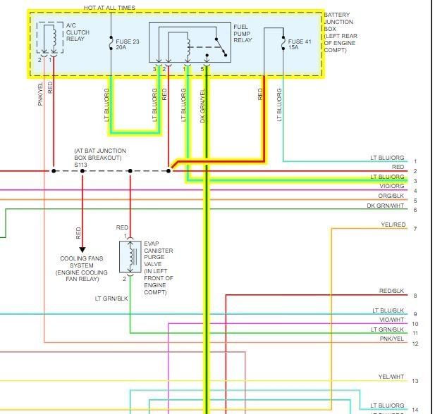

No, you need battery voltage. You should have battery voltage for 2 seconds. Then it will disappear. When you crank the engine, it will go to a full battery voltage.
The power to the switch comes from the fuel pump relay. I attached a diagram of the system for you. I made it in 2 pieces so you will be able to view it.
+1

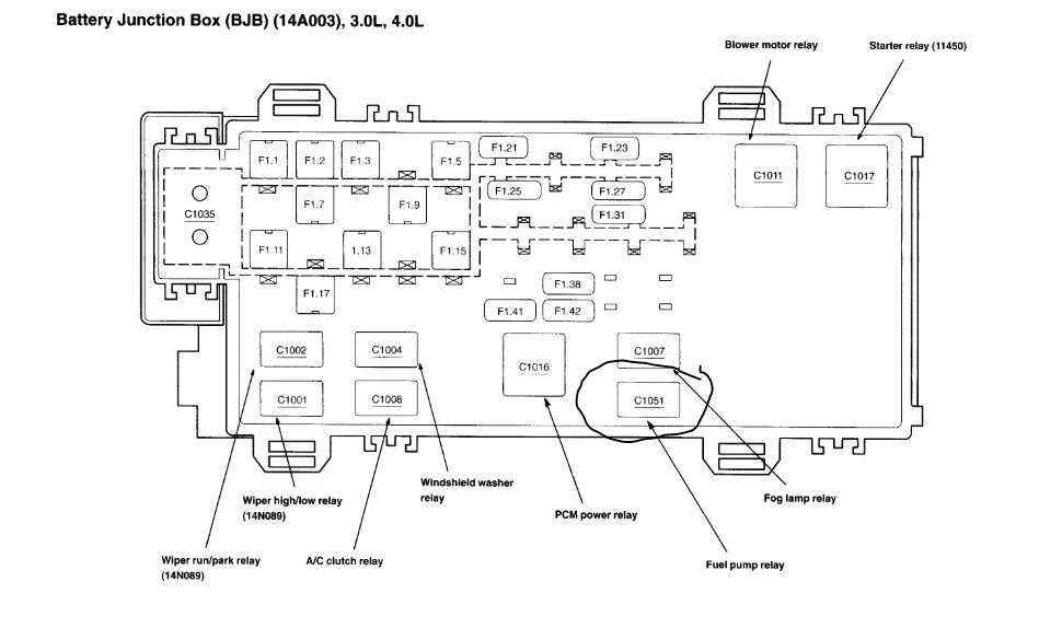

JJHRHIH
  • 15 POSTS

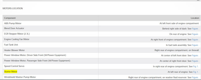

Thanks for quick reply. Do you have diagram of relay location related to numbers on fuse cover, the black ones or smaller white?
  • 52,797 POSTS
I attached the location for you.
+1
JJHRHIH
  • 15 POSTS

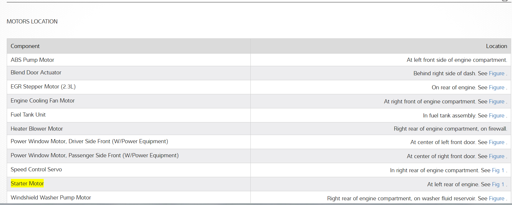

My fuse cover lid dose not match your diagram all relays show 45a 45b up to up to56a-b.2004 Ford Ranger. 3.0l
  • 52,797 POSTS
Just check the location position in the fuse block.
+1
JJHRHIH
  • 15 POSTS

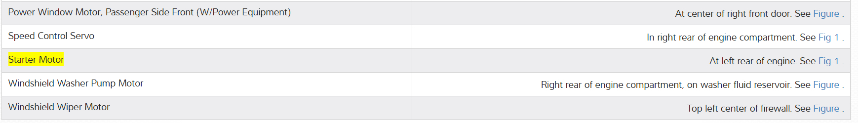

It does not match.
  • 52,797 POSTS
It is the only one listed. The diagram is upside down.

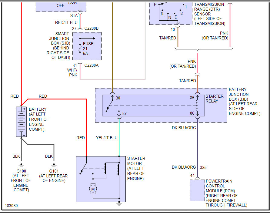

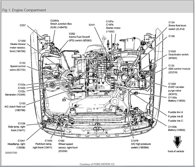

The starter will not engage the flywheel, unless truck is in gear clutch not pressed. If clutch is pressed or truck in neutral the starter spins but does not engage flywheel.
SCGRANTURISMO
  • 4,897 POSTS
This sounds like the Bendix gear in your starter might be going bad. The Bendix gear is the part of the starter that comes out to mesh with the flywheel and start turning the engine. I have included some links below.
https://www.2carpros.com/articles/how-a-starter-and-solenoid-works
Please go through the guides above and I have included more diagrams in the diagrams below.
Thanks,
Alex
