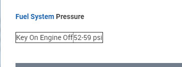

Just so I understand when you spray starter fluid it actually fires? It may not keep running but it actually catches and runs for a second? Basically it just cranks now, then using starter fluid it fires briefly?
If that is the case, then we need to start with checking fuel pressure. Even though the pump is coming on doesn't mean it is producing the needed pressure.
I attached the pressure spec. You can just hook up the gauge and turn the key on and see what the pressure is. Then you can do it while cranking as well.
Let me know what you find and we can go from there. Thanks

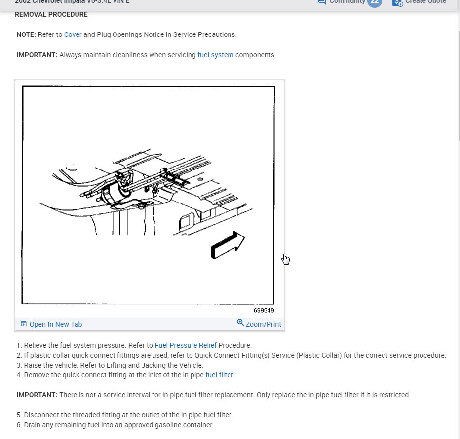

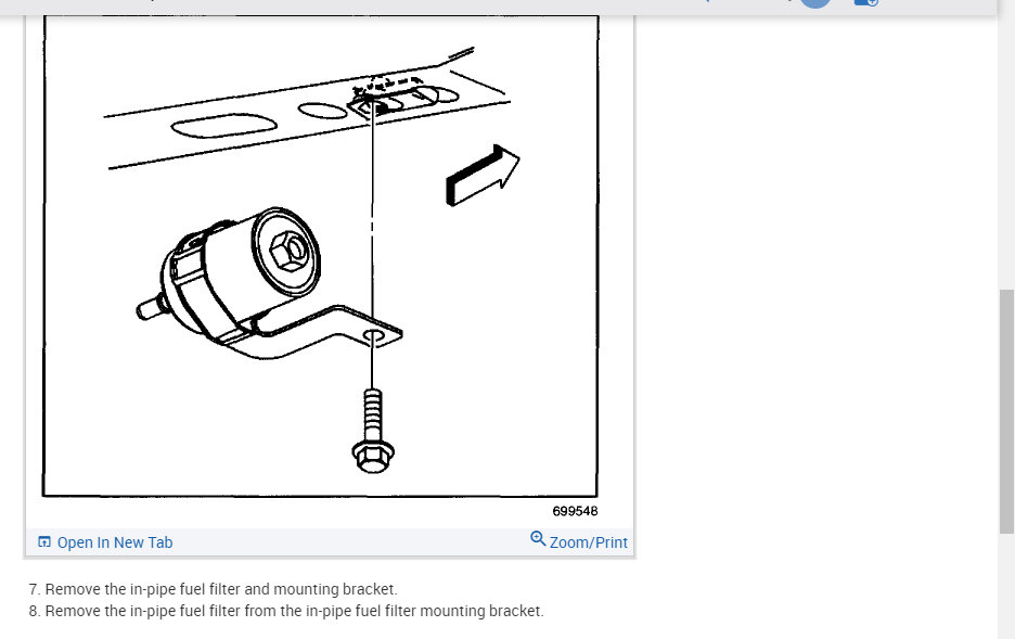

It could be. These would be something that we would need to look at if the pressure is low. There is a chance that if the pressure is normal, the regulator is stuck closed restricting the pressure to the injectors. However, if the pressure is low, then the filter being restricted could be the cause. If you haven't changed it in a while you can remove the line from the filter on the engine side not the fuel tank side then direct it into a drain pan and turn the key on so the pump comes on and see if there is a strong solid stream of fuel. If not then replace it. If there is, it is probably not the issue.
