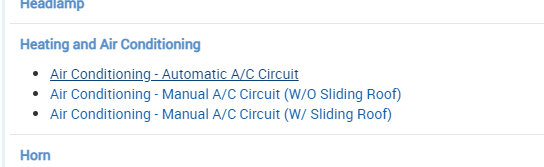

Does it move in any direction? Also, there are three different wiring schematics to review, but I need some info from you.
Take a look at the pic below and let me know which one you have. That way, I can see where the power is coming from. Also, do the other controls work? For example, can you change the airflow direction?
Take care.
See pic below.
Monday, May 1st, 2023 AT 7:39 PM
JENNIFER ROLF
When we first hooked it up while out it started try to move a little bit then stopped. We even carefully took the new actuator apart and moved it all the way the other way. Still nothing. I can switch where air is blowing from and speed of fan. It is the Manual a/c circuit (without sliding roof).

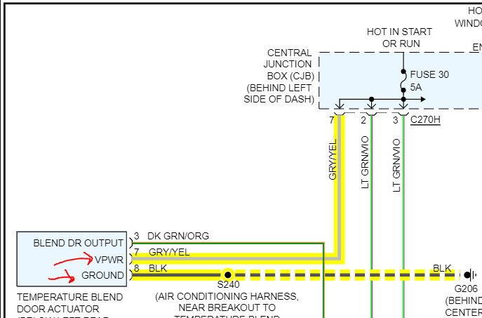

  • 110,194 POSTS
At the actuator, there should be three wires. First, disconnect the actuator, locate the gray wire with a yellow tracer, and confirm there is battery voltage to it. The key must be in the on position when this is done.
If there is power, locate the black wire at the connector and check it for continuity to ground. The key doesn't need to be on for this.
Additionally, when you check the fuse in the central junction box, make sure there is power both to it and from it.
Here are two links to help:
Let me know what you find.
