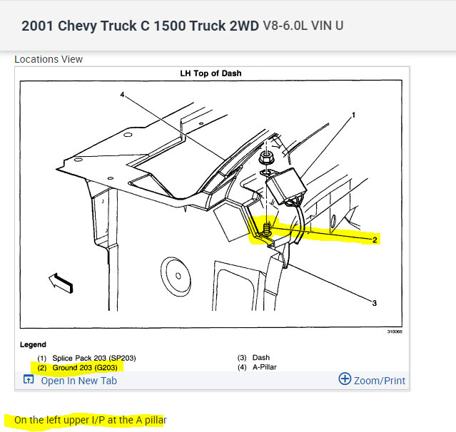

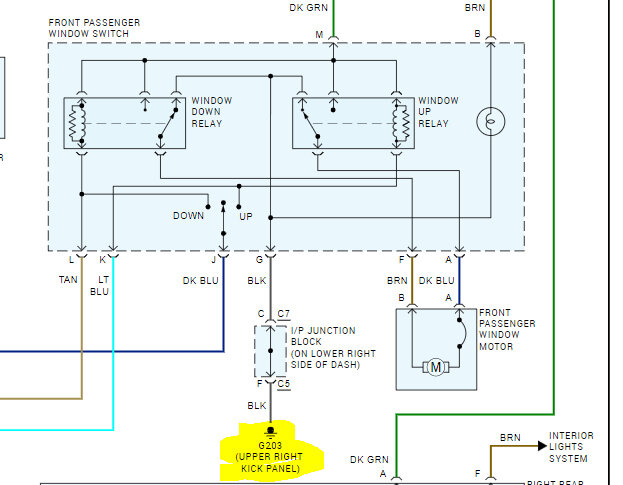

I attached two pictures below related to the ground location. It is G203. Pic 1 is the schematic that indicates it is on the right side high behind the kick panel. Pic 2 says it's on the opposite side. Ugh!
The pics both came from the same manual. Check to see if you can locate it on one or the other side. Also, I noticed there is a splice pack for the ground. There is a good chance that is where the issue is located.

I have a question. When it says left side of Dash, is that the driver or passenger side of dash?
Ron
Friday, September 20th, 2024 AT 8:28 PM
  • 110,192 POSTS
They indicate the side based on you sitting in the vehicle. So, the left is the driver's side. Did you notice that the locations indicated from the same source are on opposite sides of the vehicle?
