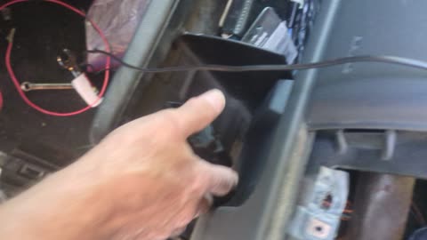

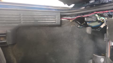

Oh, and I confirmed that the sound is coming out of the RAP 2 relay. It was buzzing when the switch was flipped.

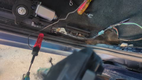

I just got a new window motor from Rockauto. I plugged it in and that didn't solve the problem.
Here is what I know. When the motor isn't attached the switch doesn't cause the noise or blinking lights. When I attach a test light to the connector going into the motor, I have confirmed that I get power to roll up and down the motor. The noises is caused by the RAP2 relay switching like crazy, making the light go off and on. I can control the passenger back window now by the switch on its door and from the master switch on the drivers side door. I just got a new motor and attaching it causes the RAP2 relay to cause the noise.
So the motor is getting power from the switch but the motor will not work. What could be causing this and how can I figure it out?

I thought I could refresh your memory of what is going on with my truck. In the video below I show that when the motor is disengaged, I can flip the switch, and I get power to both the post on the connector that goes into the motor. Then I connect that connector to a new window motor, and I get the same problem with the sound coming from the RAP2 relay and the flashing lights and the motor not responding.

I now have power to roll up and down the two back windows and the drivers side window from the master switch and by their door windows switch. I have power at the passenger side front window from the switch to the blue and tan wires that go into the motor on the passenger side front window. If I plug it into the motor and flip the switch, the RAP2 relay buzzes. If I go to the master switch and flip that switch the RAP2 relay also buzzes (see video). I have replaced the motor and regulator in that passenger side front window.
What would make the relay buzz?
And why can I control all the other windows but it?
