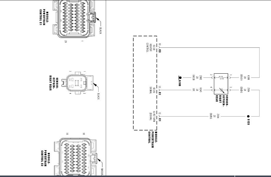

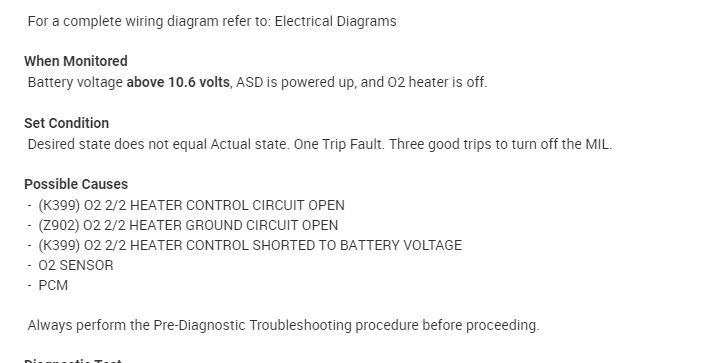

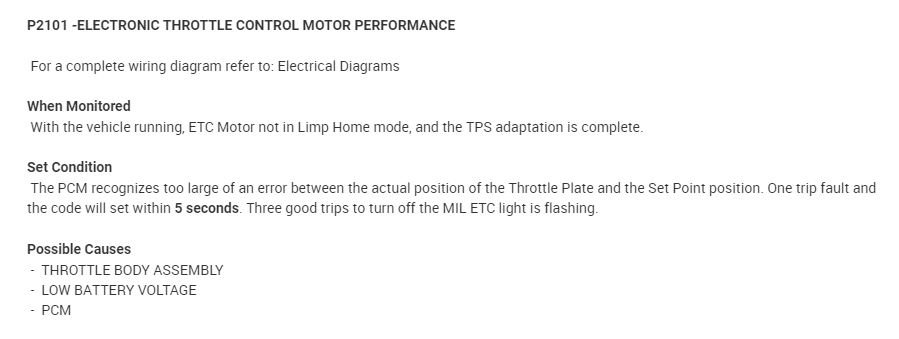

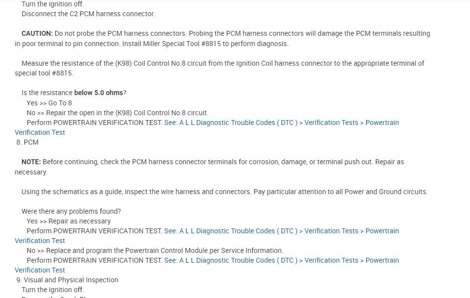

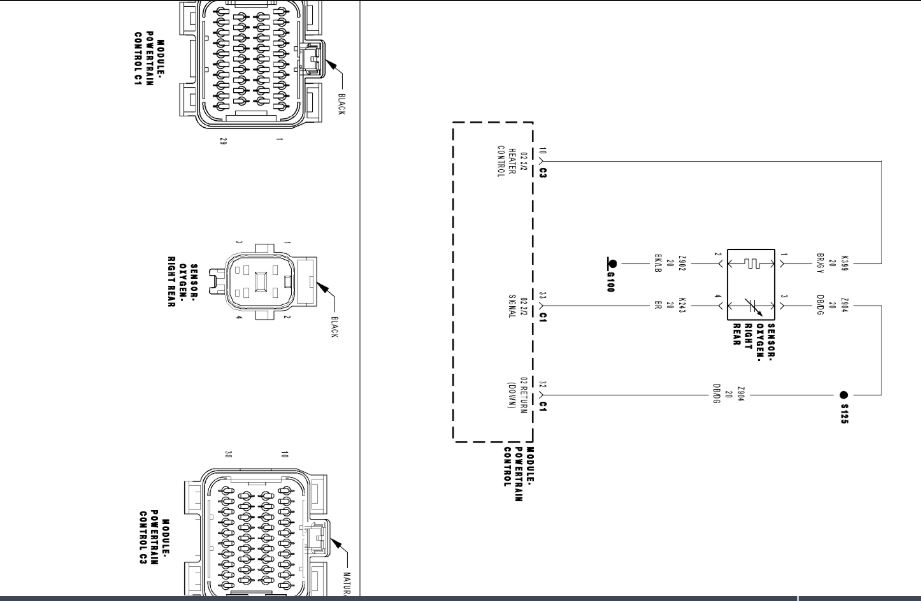

Okay, I attached the information for the codes below. You should have more information on the 2101 from previous posts.
+1
Thursday, March 19th, 2020 AT 4:59 AM

Okay, well I've come to a closure that the PCM is going bad because I started it and limp mode so I tapped on it not to hard and it shut off so I started it nada did it a few times over and over and then it started. So I'm going to replace it Thank you.
Thursday, March 19th, 2020 AT 1:11 PM

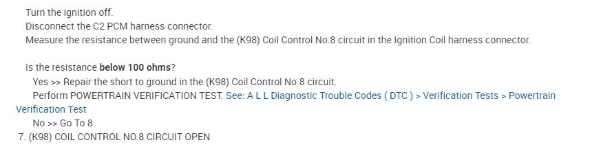

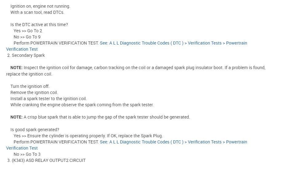

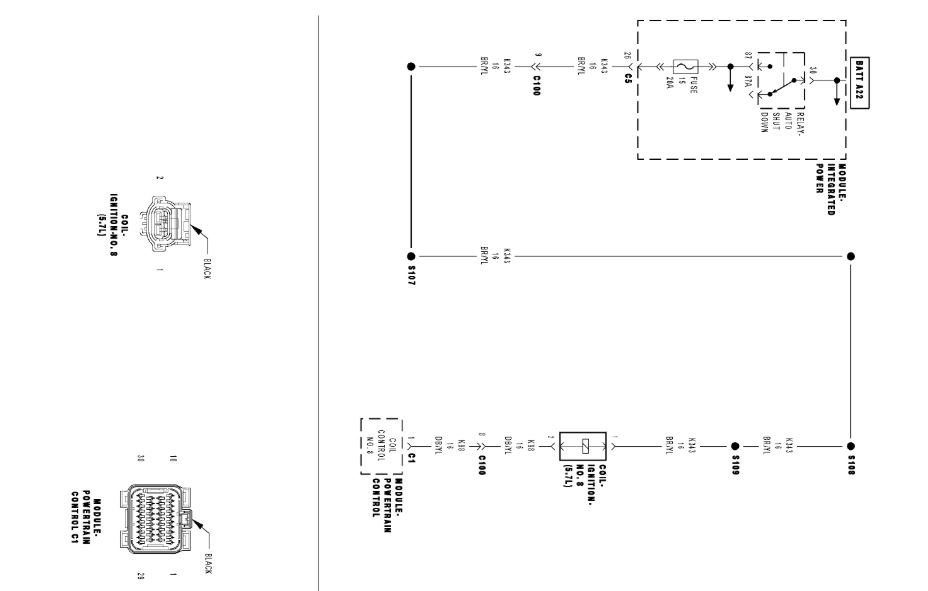

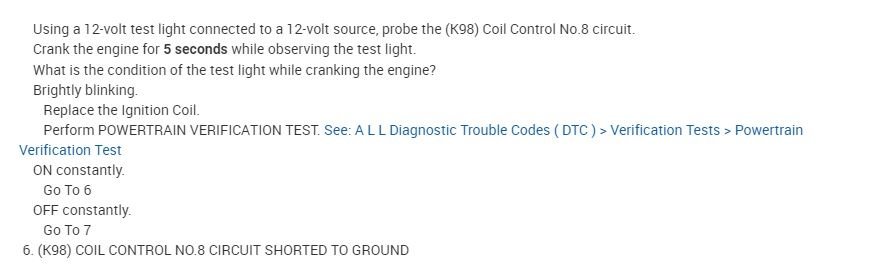

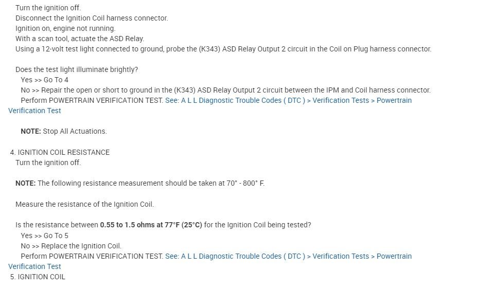

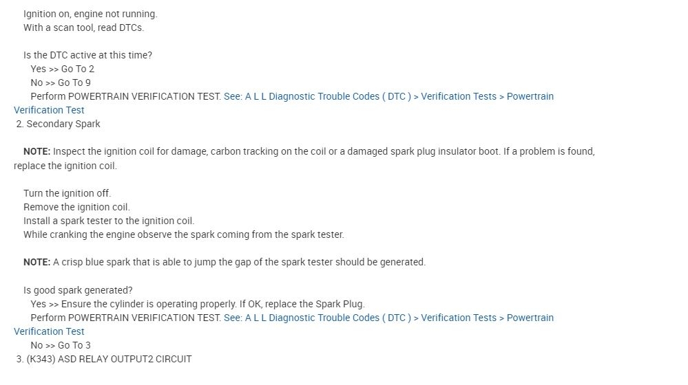

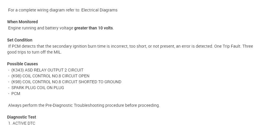

I'm back well number 5 coil pack has no juice?
Thursday, March 19th, 2020 AT 9:31 PM
  • 52,797 POSTS
Do all the other coils have power to the same color wire?
+1
Friday, March 20th, 2020 AT 4:34 AM
AGNUS
  • 37 POSTS
They all work but that 1.
Friday, March 20th, 2020 AT 12:40 PM
  • 52,797 POSTS
You have a wiring issue at that 1 coil. One wire feeds all the coils there power. They each have a return voltage to the PCM.
Take a close look at the harness.
+1
