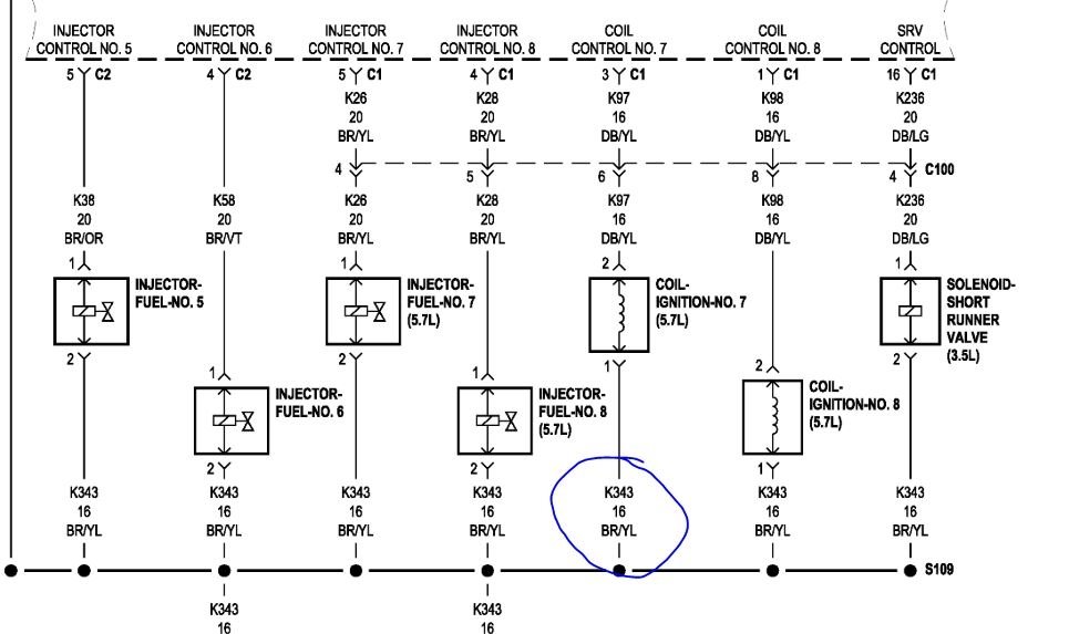

One is brown/yellow and black/yellow each pig Tail has only 1 brown/yellow and 1 black/yellow except the black pig tail it has 3 or 4 I believe.
Friday, March 20th, 2020 AT 1:43 PM
MECHANIC
52,796 POSTS
Look at another coil and see which one has voltage with the connector disconnected.
+1
Friday, March 20th, 2020 AT 2:07 PM
MECHANIC
52,796 POSTS
I attached another diagram that is clearer. I circled the wire that should have battery voltage with the key on.

Just wanted to let you know that there is like 10 codes and the check engine light is on, but shes running great. Thanks for everything.
