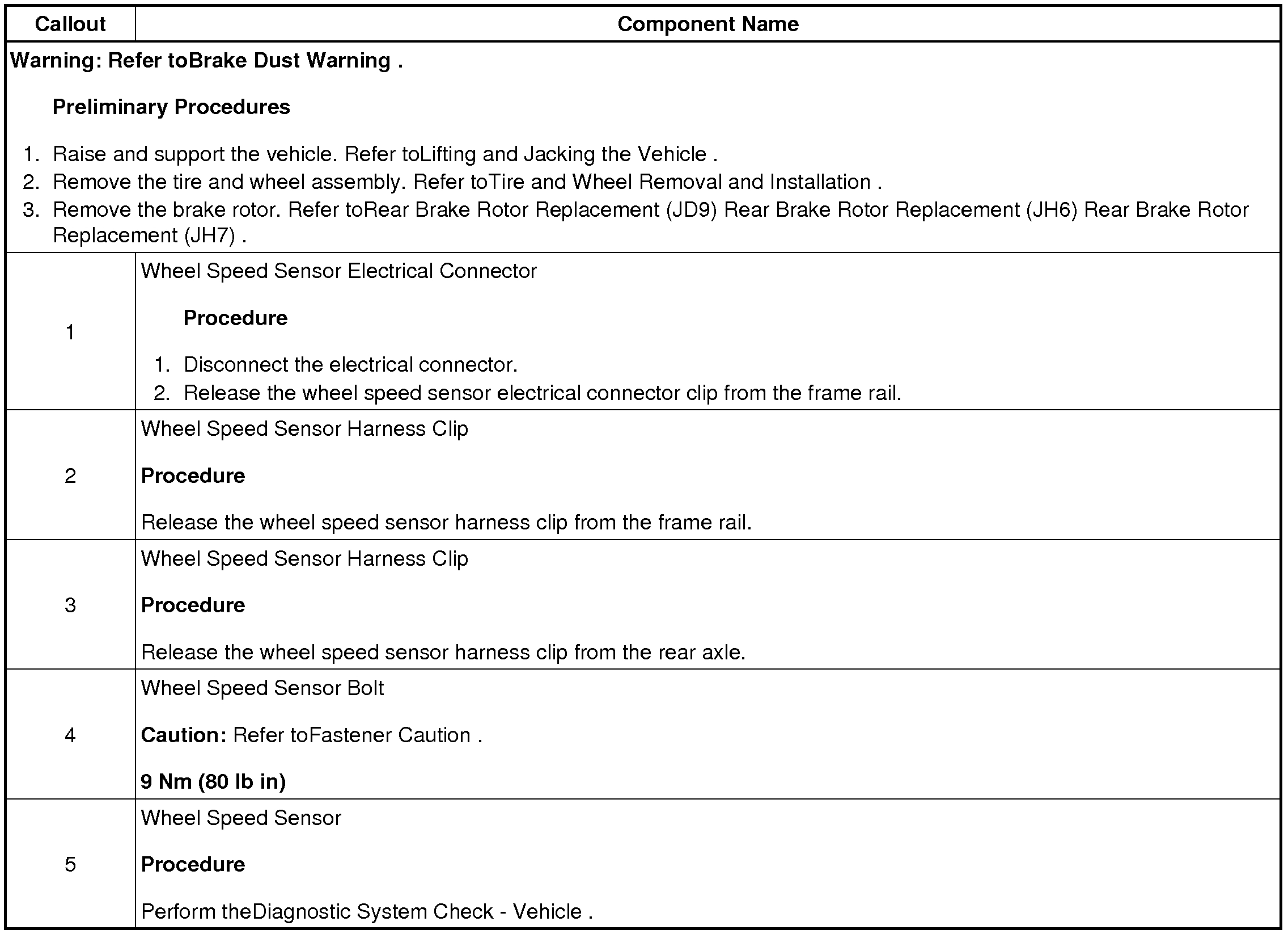

Next, most often, the light is triggered by a bad wheel speed sensor or even low brake fluid.
Here is a link that shows how to check wheel speed sensors:
https://www.2carpros.com/articles/abs-wheel-speed-sensor-test
I don't know if you need them, but here are a couple links that you may find helpful when checking the sensors:
__________________________________

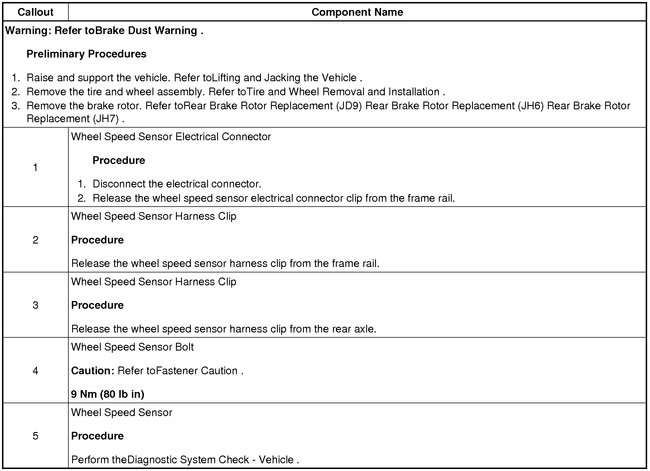

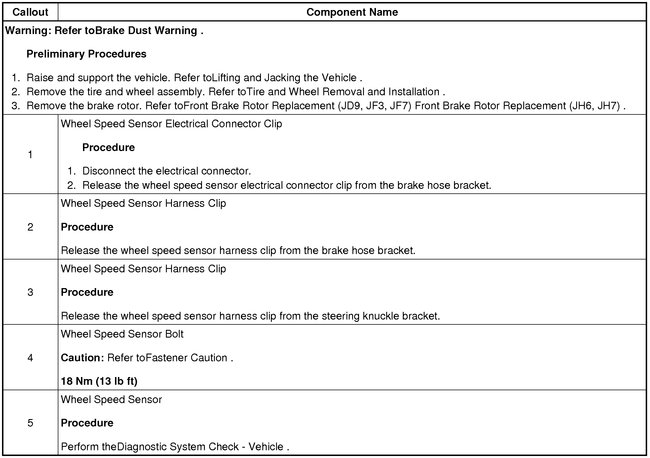

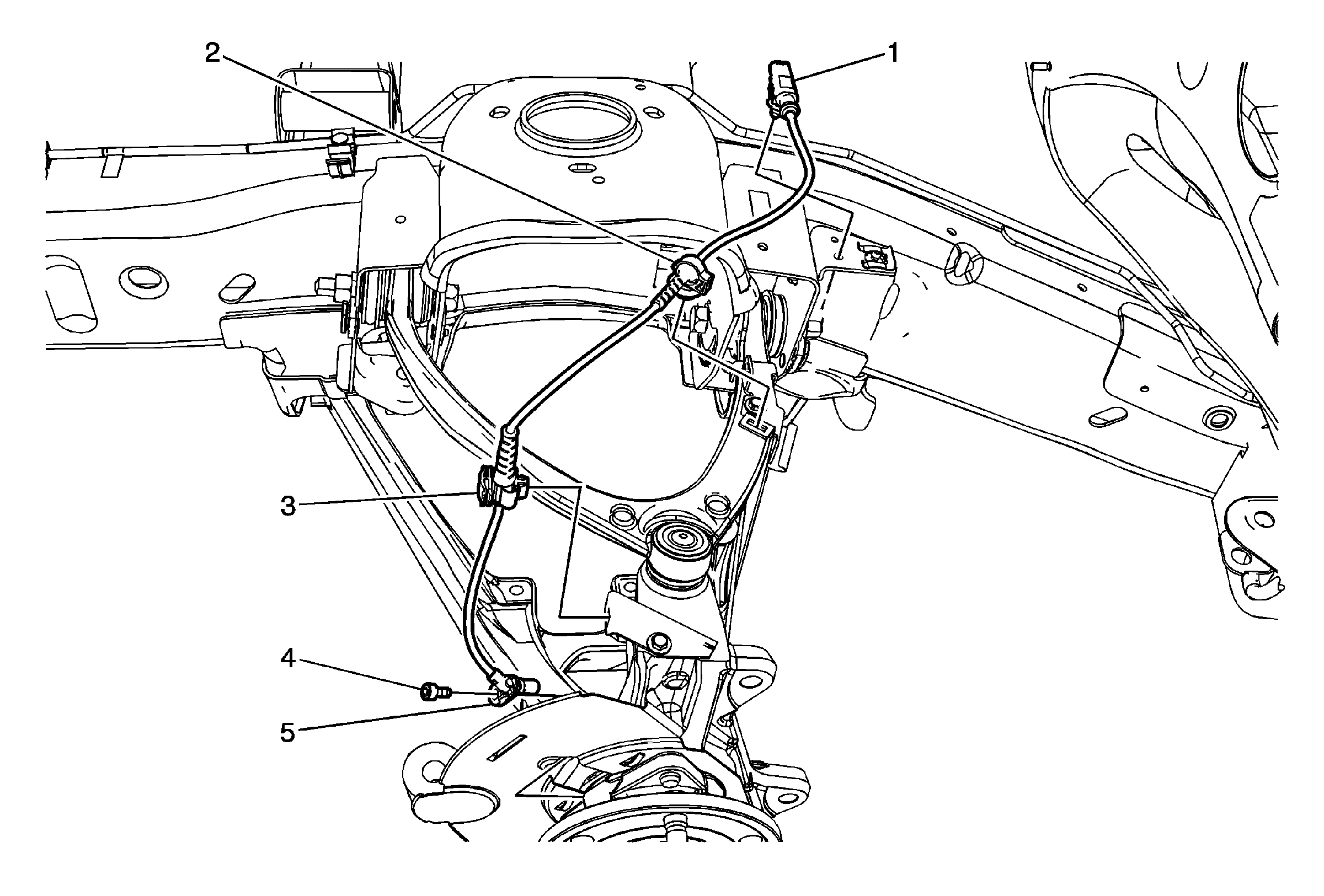

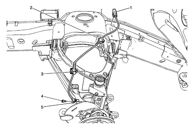

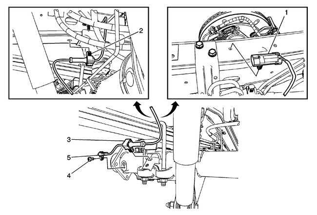

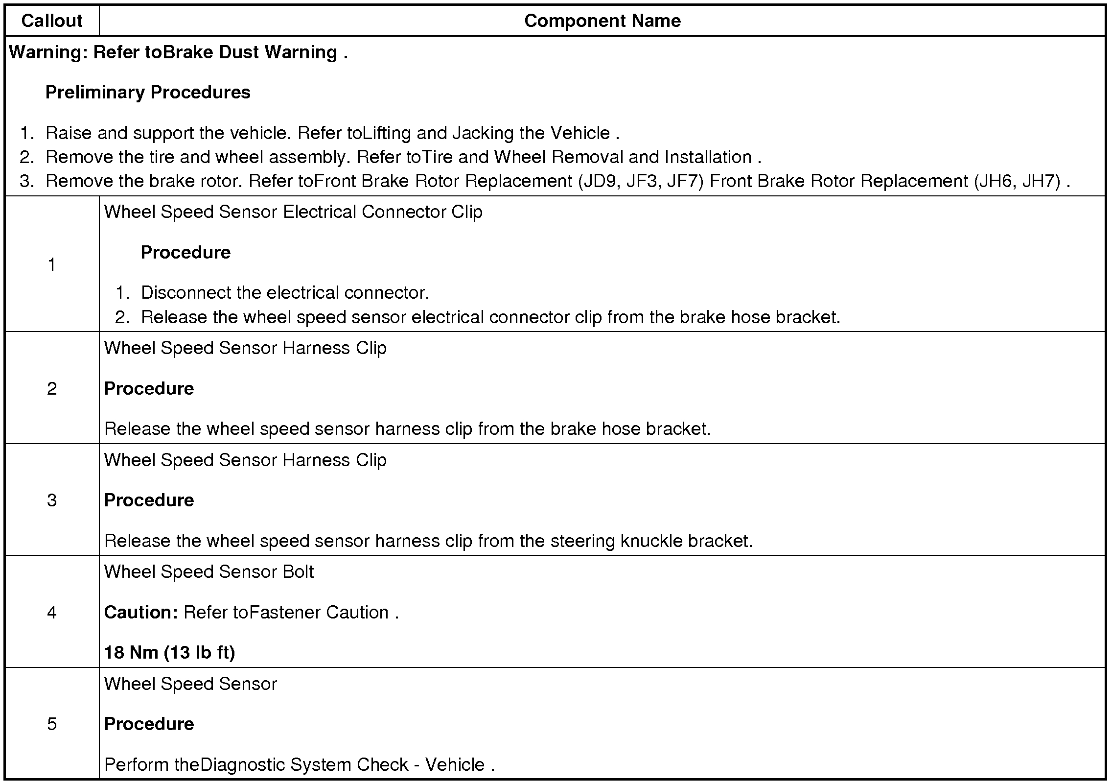

If you find one of the sensors is bad, directions for front sensor replacement are listed in pictures 1 and 2
Pictures 3 and 4 are related to rear sensor replacement.
Let me know what you find. Also, and don't laugh, make sure the brake fluid is full.
