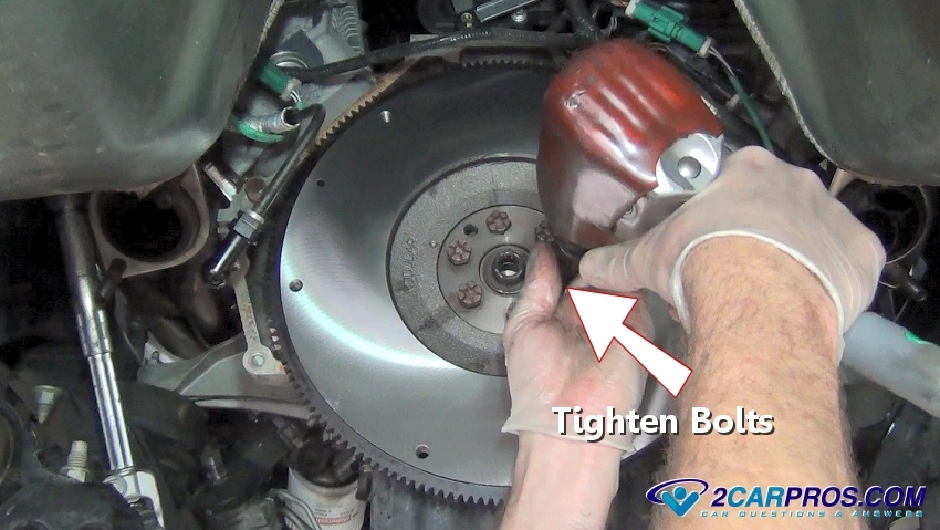

  4. Clean the surface of the crankshaft flange using carburetor cleaner and a shop towel. Insert the flywheel back onto the crankshaft while having at least one mounting bolt ready to install. Once installed check the alignment of the remaining bolts because the flywheel can only be mounted one way. Hold the engine from turning over with a breaker bar in the front crankshaft bolt while using a torque wrench to tighten the flywheel bolts to manufacturer's specifications (usually between 70 and 90 foot pounds).

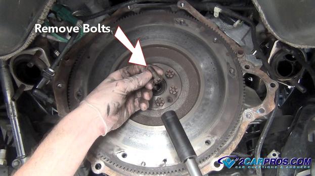

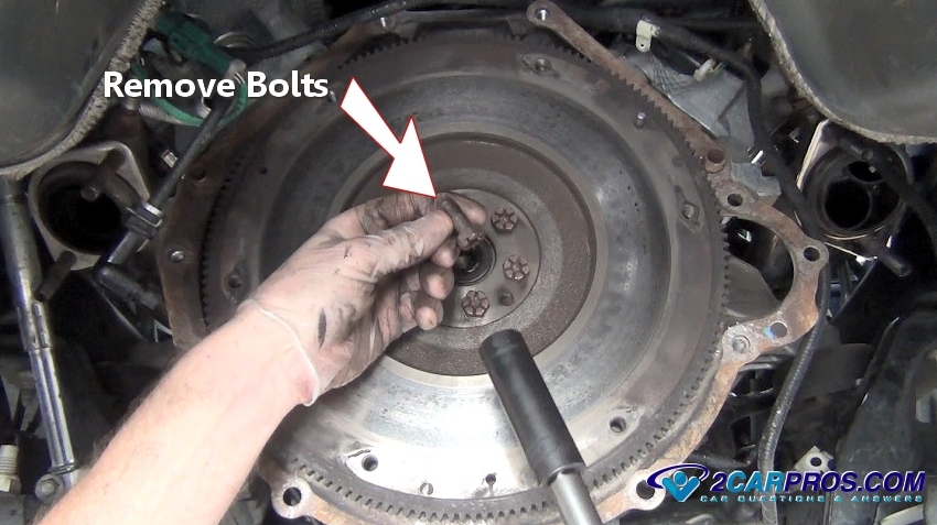

Remove flywheel mounting bolts which can be difficult because the can flywheel turn. Have a helper wear gardening gloves and hold it as you position the ratchet or wrench outward to minimize spin or use an impact wrench or flywheel holding tool (not shown).

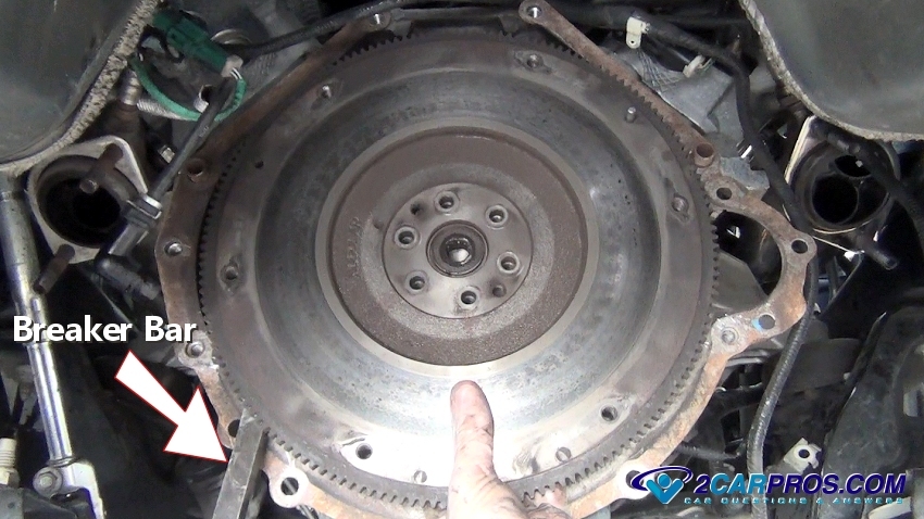

Use a breaker bar and gently wedge it behind the flywheel and in between the engine block. While grasping the flywheel firmly jar the flywheel loose from the engine. (Note: The flywheel is heavy, so be ready.)

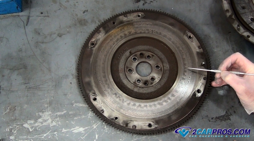

Inspect the flywheel's condition, hard spots are an indication of extreme use. If large cracks are present the flywheel will need replacement and will not be eligible for resurfacing.

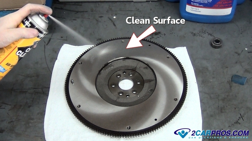

Here is a resurfaced or new flywheel. Before installation use carburetor cleaner to clean the clutch surface thoroughly. (Note: Most automotive machine shops resurface flywheels.)

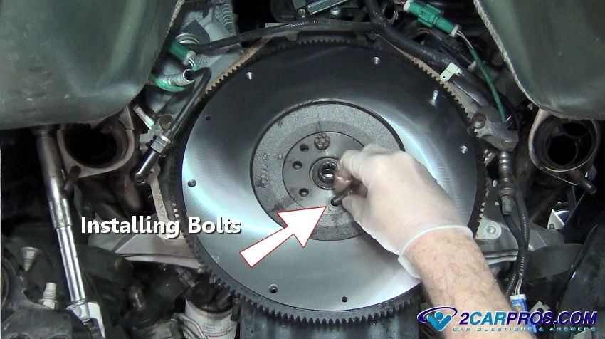

Gently mount the flywheel onto the crankshaft and install the mounting bolts by hand (Note: Flywheel bolt pattern lines up in one direction to avoid improper installation).

Tighten the flywheel mounting bolts in a star pattern to factory specification.
